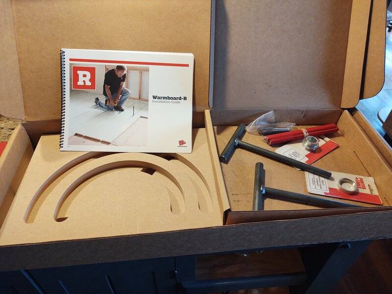

Just received the installation kit which has the full panel and plumbing drawings, router templates, bits, guides and alignment pegs. Panels show up Wednesday:thumbsup:

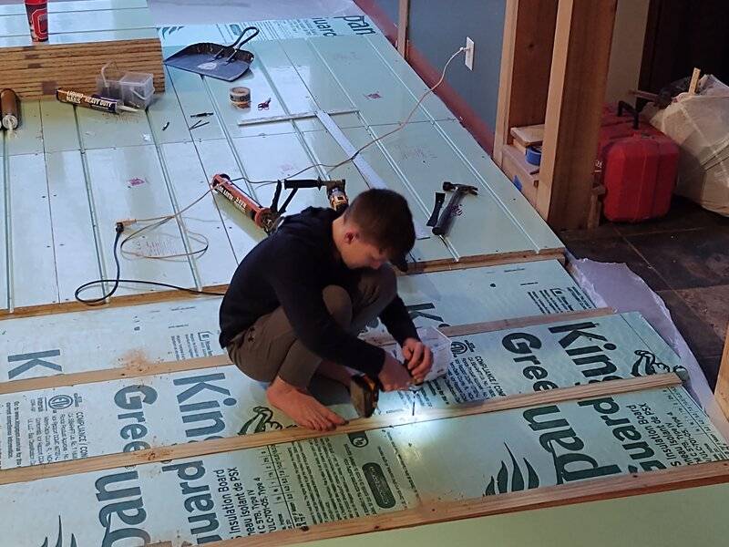

Making progress! Started off using the bits that came with the concrete anchors but that wasn't cutting it, bought 3/16" bits for the SDS hammer drill and it was go time after that. On a side note, Simpson anchors cost half the price as Tapcons and look identical.
Warmboard calls for 1/2" Homosote sound deadening insulation, I went with 1 1/2"... easy fit using 2× treated lumber. Cost wise buying 2×12 and ripping them was a big cost saver seeing how I wanted the majority of the underlayment to be insulation not wood. Once I got on a roll my 12 year old jumped in and started driving screws:thumbsup:. 3/4 of the way done with the Warmboard.. time to take a break.
