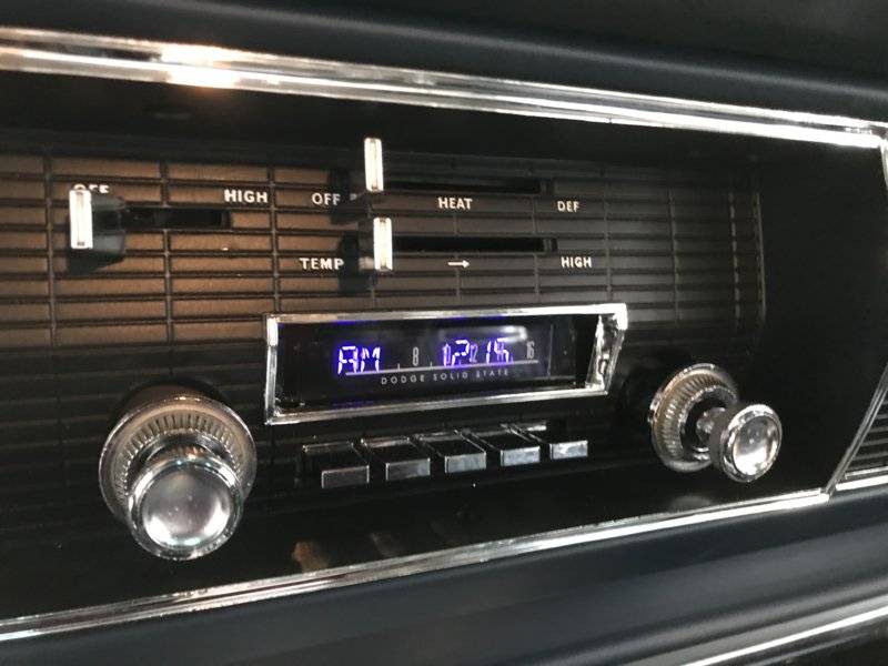

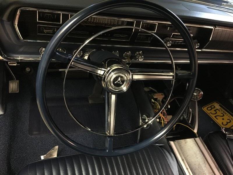

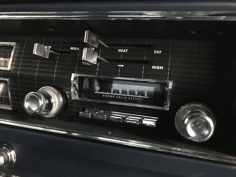

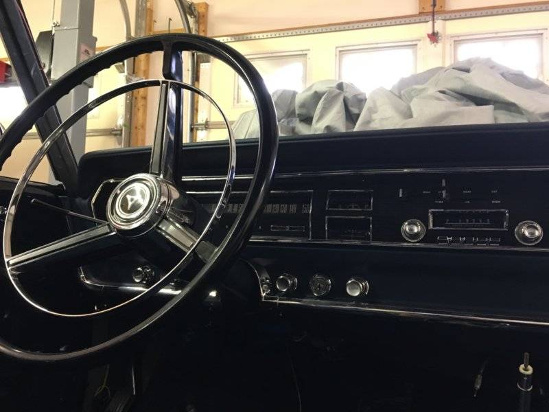

I put one in my 67, I used the original knobs and the screen protector. Install was straight forward as it can be for a lego kit. I had the entire dash out of the car when I fit it in. The LCD display shows through the screen protector but it’s clearly there.
The blue tooth is pretty cool. It also has a jack for audio and USB input that I buried just behind the dash. I don’t think I’ll need it.
Let me see if I can find some pics.
Here’s what Imhave for pics right now. Check my build thread. I thought I had pictures of the dash when I built it but I can’t seem to find them right now.
