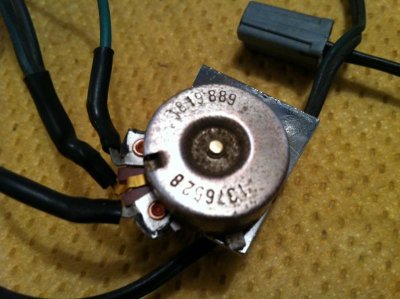

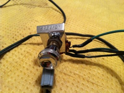

I just found this in the garage today. came out of a 66 Coronet 500
