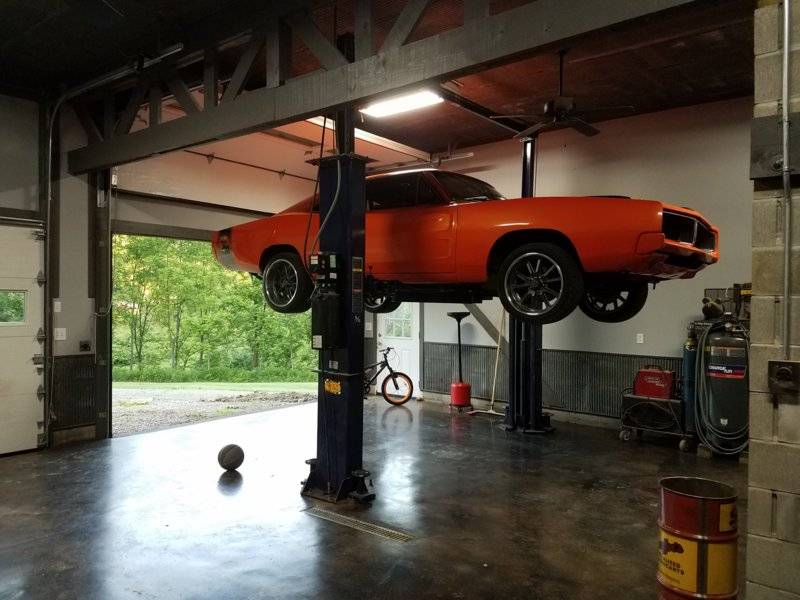

I bought a 11,000 lb rated Challenger lift in 2015. Assymentrical arms too. Great unit. I've only lifted vehicles under 6000 lbs but it works great, everything feels stable. I built the shop that it is in, I made the ceiling vaulted to accommodate the columns. The concrete under the columns is 18" thick, 24" X 24" wide....Yeah, overkill!

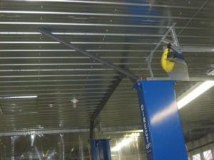

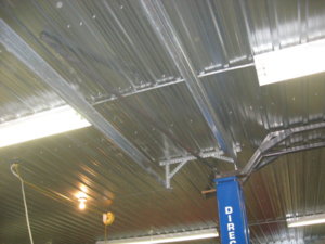

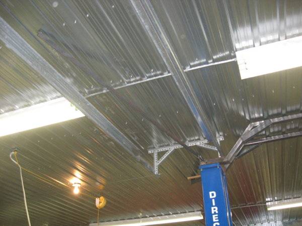

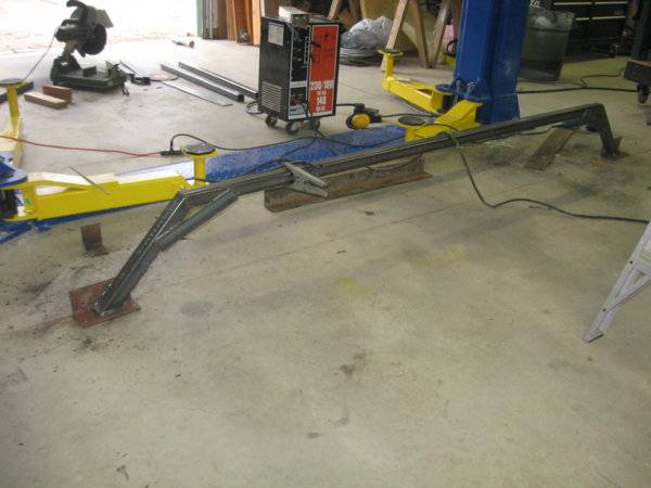

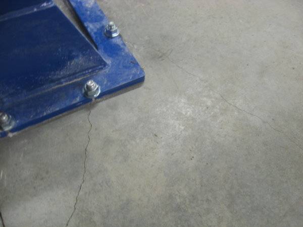

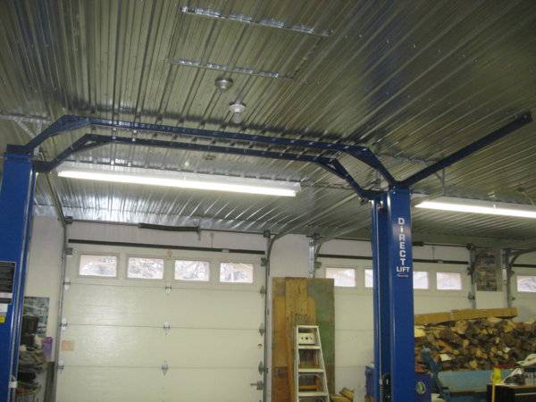

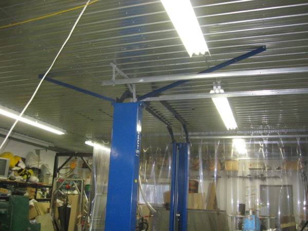

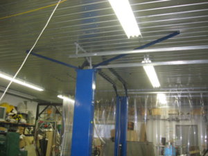

My 9000lb Direct Lift is a residential version made for Rotary Lift. I installed it to 6+ " of well cured (15+ year) concrete and the one post cracked the floor lifting my wife's Sport trac. So I built an upper truss for it, C/W braces to the roof trusses. Have had no issues with full size F150's and Sierras on it since. Left my Bee on there for almost a year up full height.

What's the ceiling height needed for that one?

Its not entirely about the thickness.
There's different PSI/Tensile strength concrete. MOST residential garage concrete used around the country is the lowest allowed by code, M10 (~1500 psi tensile strength) to maybe the 2nd lowest, M15 (~2200 psi), sometimes M20 (2900 psi) depending on local codes. Rotary and other 2 post lift makers usually require cured concrete at a minimum PSI grade of 3000 or M25 or higher at 6 inches thick. If cured that long and the lift cracked it, I'm betting you've got M15 or M10.
Personally, I wouldn't install a lift, especially a 2 poster on anything less than M50 for a lift, I know the lift people put a minimum of M25 grade but I like overkill. The current shop that has the lift we have on the farm uses M50, 14 inches thick and we've have 40 ton pieces of equipment on that floor and hasnt cracked and the concrete is nearly 25 years old. The new shop I'm building next year, I'm going with M70(the highest locally available), 12 inches thick. cost is just 24 dollars more per cubic yard over M20, and will only add 1100 to my build.

I'll measure the post height for you when I hit the shop. My overall shop ceiling is 10' 3" high and you can see I took the trusses I built up about a foot. I bought the hoist from these guys Glenwood.. after a LOT of searching to find anyone in Ontario that would sell direct vs though a dealer/ etc. Specs are there, it says overall height 111" but I'll measure mine to the top without truss to confirm.
http://www.directlift.ca/pro-9f.htm

How high does that lift? can a 6 ft tall person walk under it lifted?
Glenwood.. indeed 111 & 1/8" post height.
When I got the lift in Nov 2012 it was 2195Cdn + $200 shipping from Concord to Penetang. I see it's now $2895. Even at that I have paid for this lift about 5 times over saving family from having to use the local garage at $100/hr.

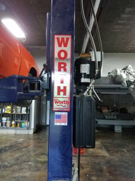

Mines a Worth, very beefy with a big footprint, best of all it's made in Texas. For me I narrowed it down by tossing all the lifts made overseas out lol... wasn't many left. I also don't like asymmetrical lifts where the weight is severely off center putting even more stress on the anchors but that's just me. Not sure if any others offer this service but for an extra $300 Worth made my lift wider along with lengthening the arms so I can easily open my doors without going asymmetrical.
