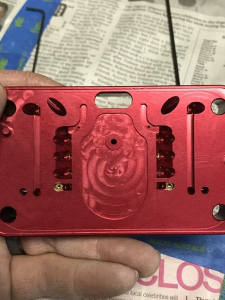

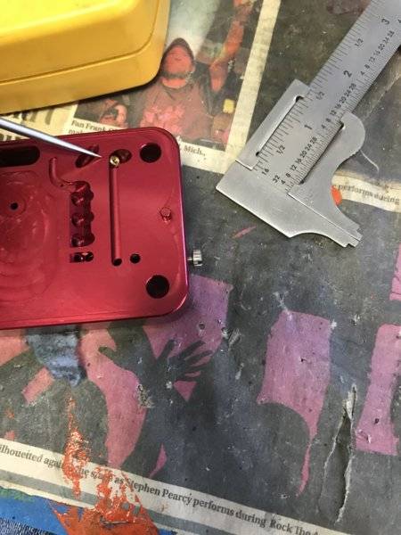

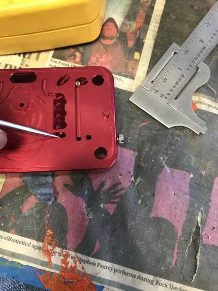

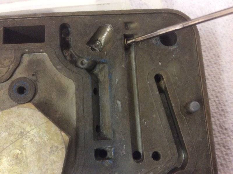

Thank for starting thread. Have battled same thing with about the same cam specs. With 2-3116's on a crossram. Ifr hole is .060 dia, put a set screw drilled to .030 to lean carb out with some success but could be better. Pic putting drilled set screw in tapped hole.
Gotta move them IFR’s low

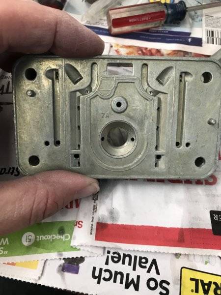

View attachment 785442 View attachment 785443
They’re decently sized. Try 1# drill larger at a time.

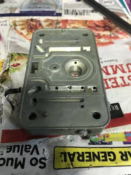

View attachment 785444 View attachment 785445 View attachment 785446
If you talking about my post, your advice to keep IFR's low? Been follow your work on carbs since a thread or a post "Idles like a six cylinder". Wondering how those carbs are setup. Been watching hoping to pick up tips. Didn't want to hijack thread but your box is full.
Should come through now
