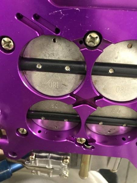

This is about max secondary transfer slot I will run. This is on my 1050/4150. I spent a bunch of time getting the cruise happy though. My dominator that’s on the car now has none, it’s super clean running.
