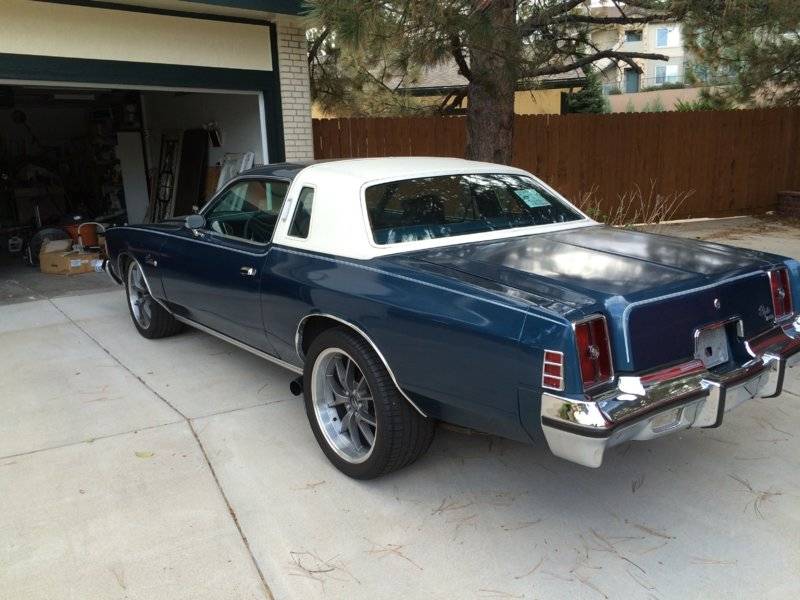

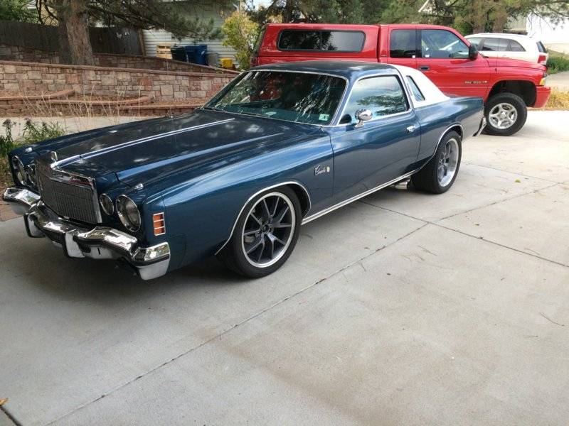

my 74 Cordoba was equipped with 20 inch rims, 40 series tires in the rear and 50 series tires in teh front when I purchased the vehicle. Removed to install 15x7. Basically found 1" spacer in the front and 21/4" spacer in the rear. Air shocks in the rear to maintain height. Spacer were adapter plates requiring no changes in Mopar mounting hardware. Ride height or rubbing was not an issue. Cordoba and 73 charger are the same body frame and suspension.
