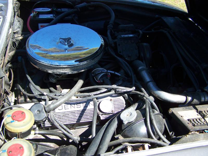

My father used it on a jensen interceptor almost 5 years ago. No rust has since occurred.

ooooooh! a jensen interceptor, eh?? got any pics???

i wanted to use pour rust conquer in. But cost was considered that is why fish oil was used. Well the foam i'm using is meant for houses and it says its seals against sound, no idea how well it would work though. Can't get the picture of the body to upload but here the jensens 440 wedge
sweeeeeeet!!! thanks!
