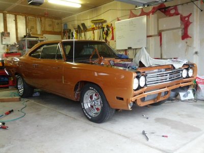

She sure is. I hoping by the end of this month but I still have a few things to purchase like the radiator and kickdown linkage. Plus I have some electrical work to do like changing the wiring because I have an internal regulated alternator and the FBO ignition system on. We will see but I want to get it going for sure before I deploy the end of March.
Update

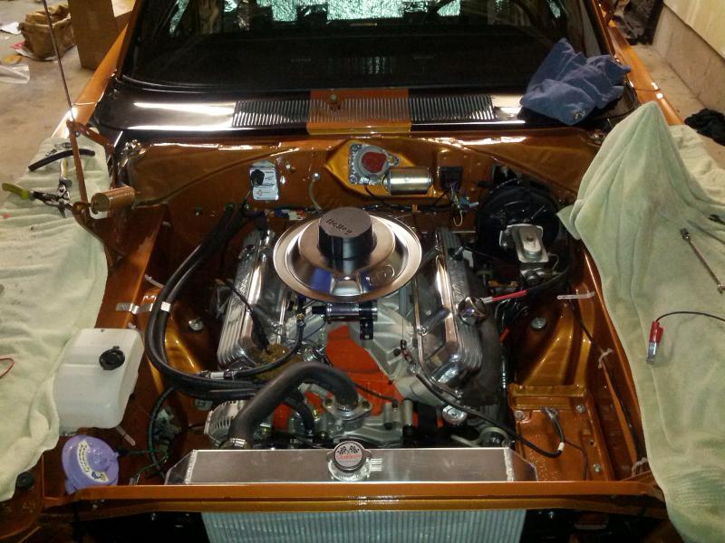

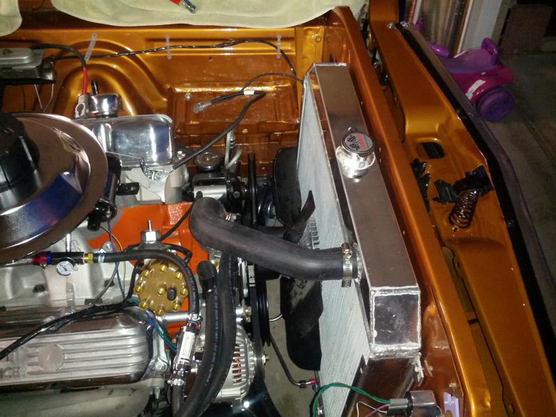

Almost time to start her up thinking sometime this week, if I can get her towed to the exhaust shop. Everything is hooked up in the engine bay except for the alternator, still haven't ran the new wires yet. Also still need to hook up the vacuum lines for the brakes, pcv, and vacuum advance.
I'll probably just throw the front bench in until I can decide whether or not I'm happy with the way my window alignment is. I have to push the quarter windows out at the top to roll them up all the way and that may be the way they are going to have to be. I can't get any more alignment out of it.

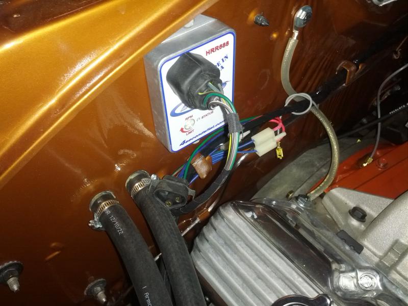

The last pic I'm just showing how I bypassed the ballast resistor. I just added a jumper wire to eacher spade connector so I didn't have to cut the harness at all. I'll be doing the same sort of thing with the alternator hook up. The original blue alt wire will be my new IGN and the original green wire will be my "sense" wire. Then I'll run the original green wire from the VR plug to the batt post on the starter relay.

Started on the TTI H-pipe exhaust install. Had to reweld one of the nuts that the bolt for the tailpipe hanger screws into. I'll take a pic of the system once all the way installed. But here's one in the mean time.
