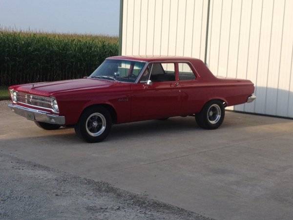

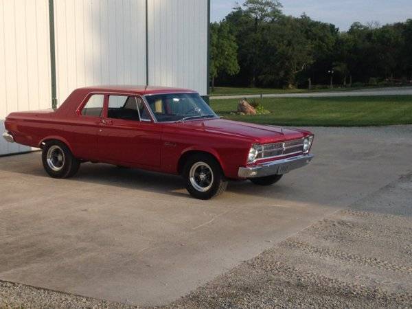

3800 lb. SS springs, 65 Belvedere. Pretty sure these were made in Mexico. Sits level. Car has the spare tire and jack in the trunk, battery in the stock location.
