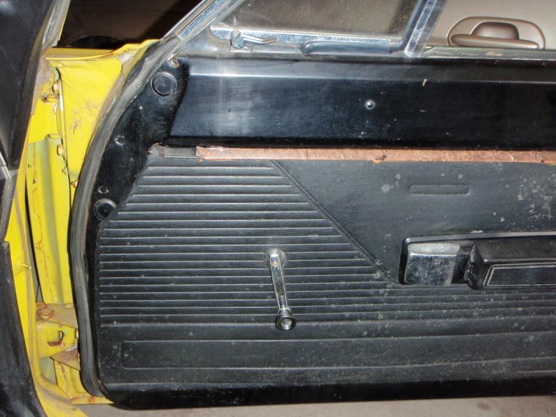

Example of door seam - left side of picture

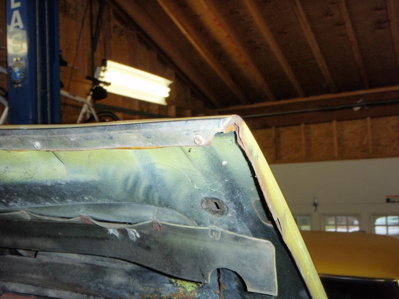

Example of hood seam

Yes, I am looking for a "prepaint" solution. Something that will get in to all those nooks and crevices, neutralize, coat, kill, whatever, to ultimately protect from rust getting a hold and showing its ugly face again.
For example, if I have my doors blasted, the dings removed and then painted, they will look awesome. But there may still be some of that minor rust lurking under the paint. When water gets in the door, be it from rain or washing the car, it will sit in that little space where the door skin attaches to the door frame. I want to try and protect those areas as much as possible.

the only way to get in there is with chemicals.
i use products like
ospho or rust mort for getting into crusty seams..
