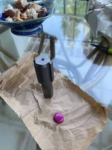

Searching Tap for Small Thread Screw In Ball Joints
No prices either so I imagine they are stupid expensive. Did you carry taps that size on the truck?
Yes for particular applications. Otherwise just up to 3/4"
