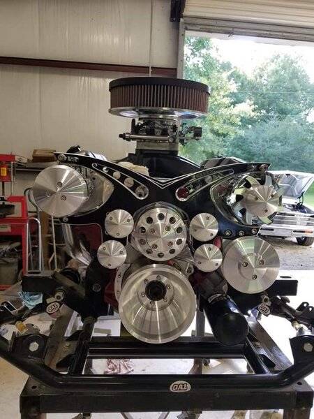

So looking at pics, you purchased everything through them? pumps, etc?
Good looking engine!!!
I did buy the full kit. The only thing you do not get are power steering hoses. I had trouble with the spacers between the main bracket and the accessories. They were doing a design change when I bought mine. Also the AC compressor mount needed tweaking. I ended up doing a thread insert on one mount and all was well.
Thanks for the kind words, I spent 4 months on the motor getting it just right.
A perfectionist, love it!!!

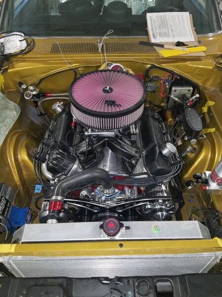

Thanks for the measurements heads up. I just measured my water pump to radiator and it’s 6.5 inches. With clutch fan mounted, I have about 3/4 inch between fan and radiator. Something tells me this will be an issue.
I kind of found out by accident even though the plan was always run 2 electric fans. I was so impressed with the aesthetics and the thought of having it as the focal point of my engine bay delighted me. When I went to lower the car into the K member and motor actually had to unbolt the fans in order for the a.c. pulley cover to clear. But at least I have the benefit of the serpentine.
