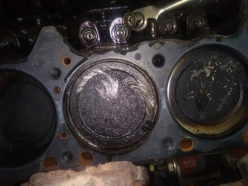

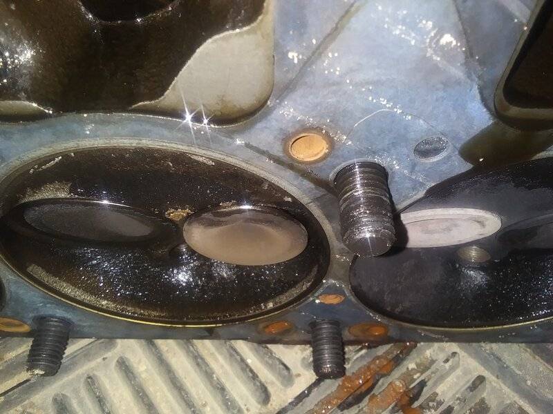

I got a 73 charger with a 360 as my daily.... And we'll I was hot rodding to hard and.....she gone. Now I'm up in the air about what engine to use. I got a 318 ready to go in. But I can't have a car with the charger namsake and it not scoot right?

What is the extent of damage on the 360 ? What are the details on the 318 ?
I havent tore into it completely just yet. The 318 is from a truck and is a good engine. I also got a disassembled 440 bit it needs new pistons
There a mistake sometimes. Thicker skin my man….
Could it be my grammar ? My punctuation ? :D You know, I got to look to see if I missed something in the photo ? like the block broken into pieces, and I ask what is the extent of damage... duh. I'm thinkin' I missed something in the pics !

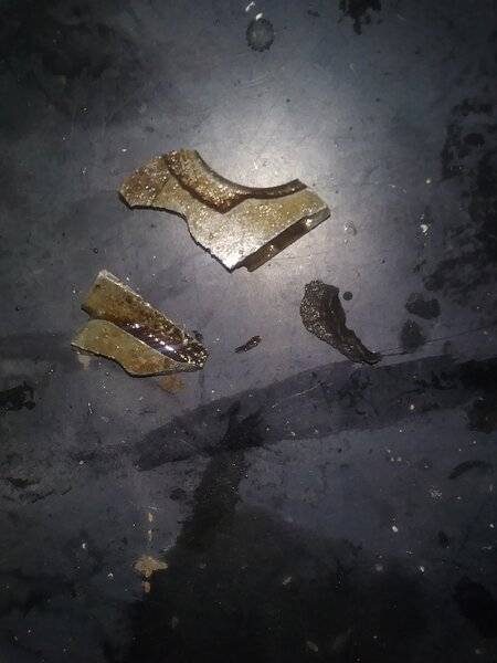

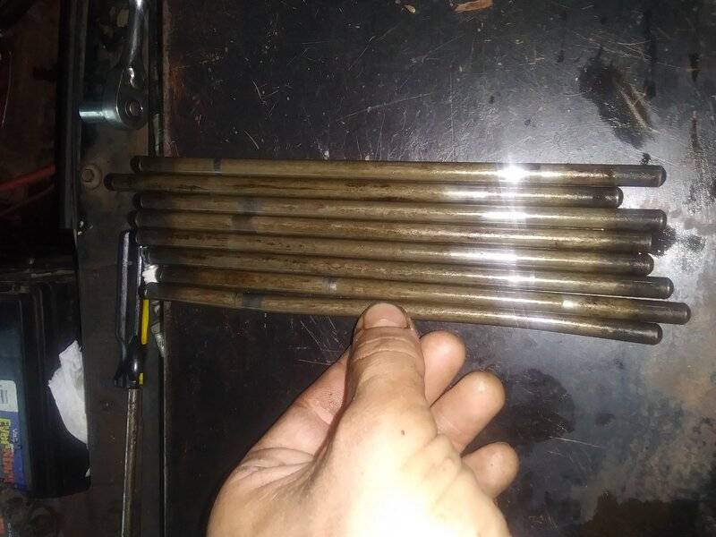

I wanna know as well. I see a bent pushrod, and a ugly piston top but the broken stuff I have no idea what it is.
Cylinder head looks OK
I'll keep y'all updated on what it is. Looks like where the front of the camshaft rides. Anybody got some 440 pistons on the cheap?
