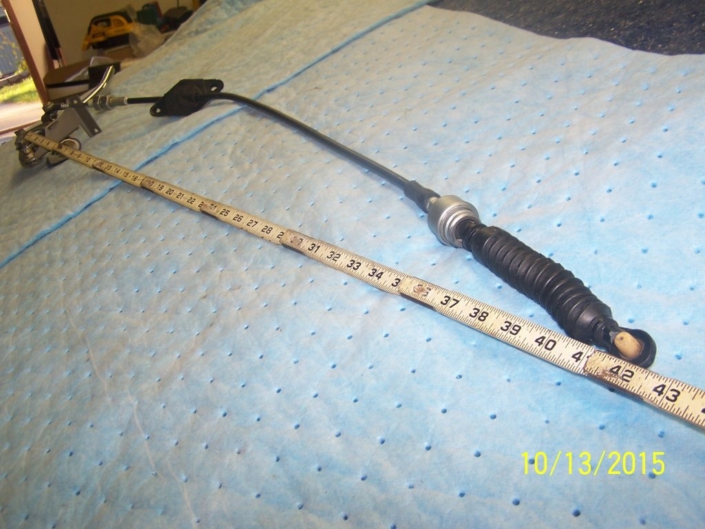

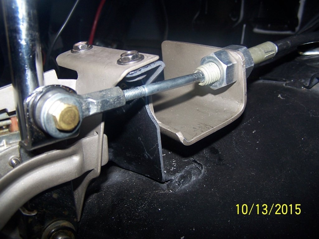

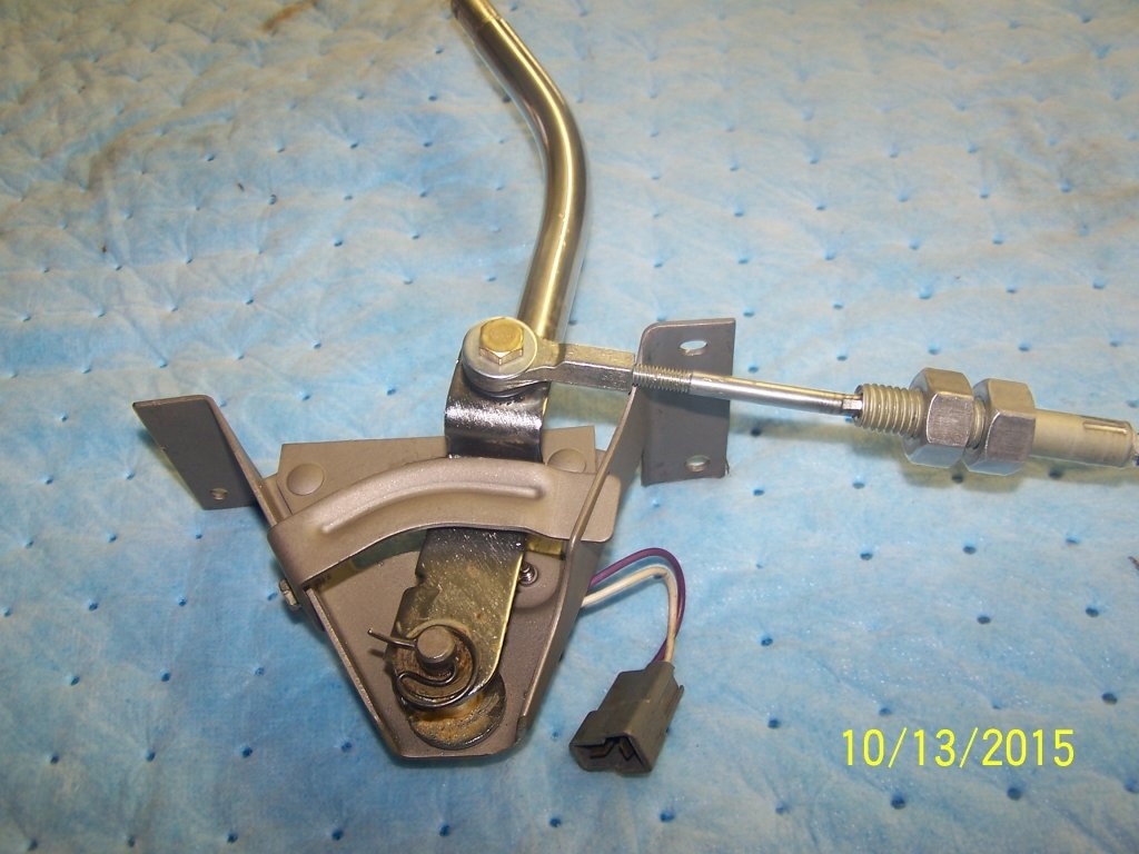

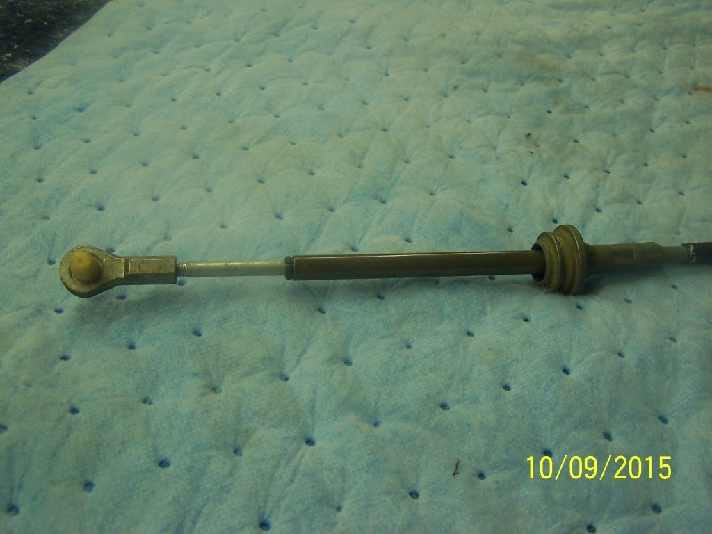

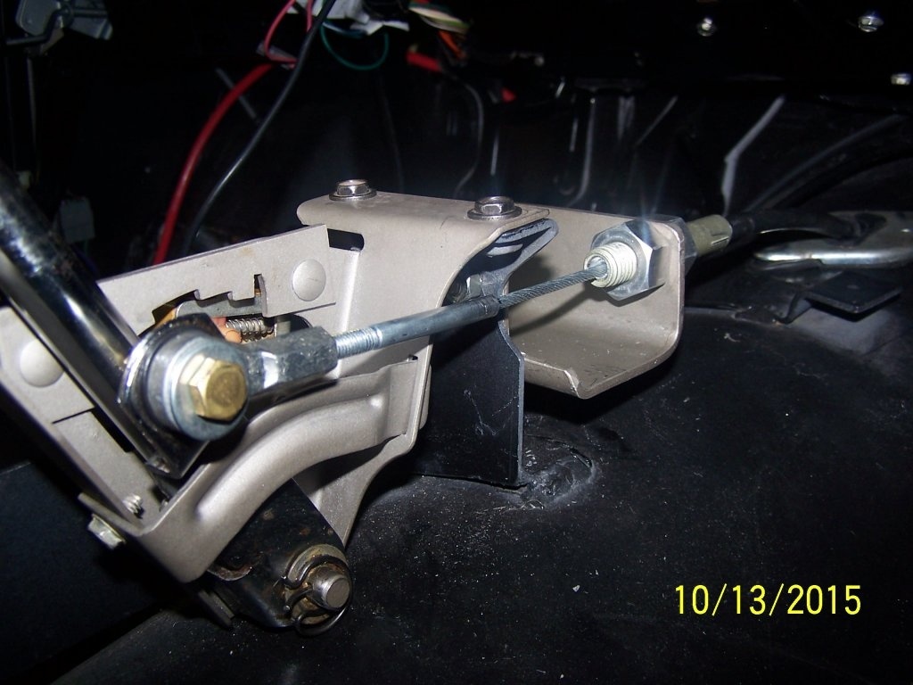

The detents are the same between the shifter and transmission. You can use your factory shifter but will need to do a little fab work. I used a shift cable from a Jeep Grand Cherokee. Shortened it and made a bracket to mount to the Console shifter bracket. Your slap stick is a little different than my 68 but here are some pics of what I did. I shortend the shifter end and used a 1/2" X 4" Aluminum bolt to affix to the bracket. Mine ended up being 42" long. Yours could be different or you could use a Lokkar or some other factory cable to start with. Have fun!
