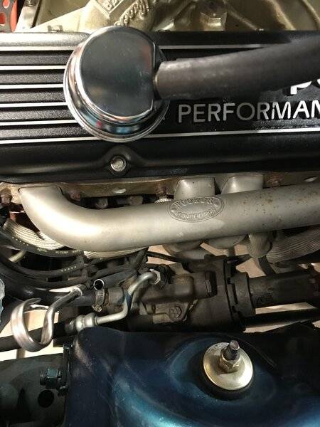

Here is the TTI shorty driver’s side setup I took off, note the sharp bend after the collector to clear torsion bar, I would assume pipe designed for an RB engine would have a gentler bend

Looking good. Can you post a photo showing the Robb MC mini starter and clearance between that starter and both the block and new long tube headers?
