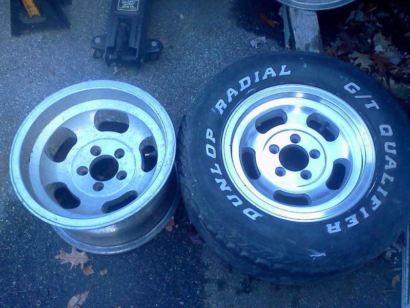

Im just wondering if they will fit under my fenders. Modification is fine, im sure I will have to shorten the axle. And probably roll the fender lip. 8 3/4 rear end by the way.
I have 15x9.5 inch wheels with 3.5 inch backspacing.
Any help is much appreciated.
Na! They will scrub everything under the car. Back spacing is too shallow for a Mopar.
Well im a little embarrassed that I misspelled "these"
Even if I shorten my axle there is no room? I read on another forum that someone had 325s on his GTX with a rolled fender.
You should really be using wider rims with a 315 tread anyway, probably cheaper to get the proper back spaced wheels rather than shorten the axles.
