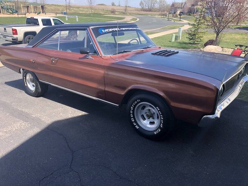

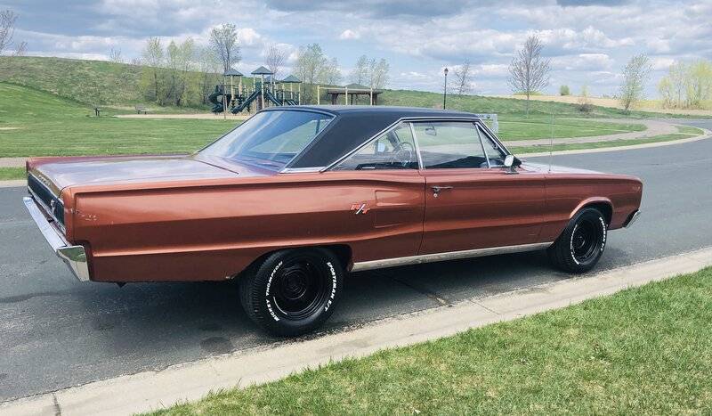

I just replaced 14 inch mopar rally rims and went 15 inch mopar police rims. Tires are easier to find as well with the limited sizes we have to work with (depending upon your setup obviously).
Before and After:
9305EF49-3205-432F-A362-86E35771D9DF.jpeg 5A470A74-5DD5-4D2E-ADA1-F04A5D039383.jpeg

Your car with that color combo really looks nice with the steelies imo.
Thank you! I am going for something unique and my own. I know it’s not factory spec but the car would need a lot to go that route so just doing things my own way. I have a lot of respect and admiration for those who get every correct bolt and screw on their cars - just don’t have the time or $ to do that.
Anyways - thank you! And mopar440bbody just wanted to give you a visual since we have basically the same car - I’m a visual person so hope that helps your decision in whatever you decide to do. Take care!

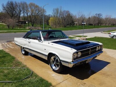

@Reamzer has switched wheels on his 500. It looks great! I think he skipped 15's though.
