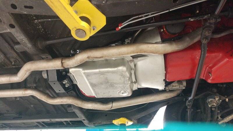

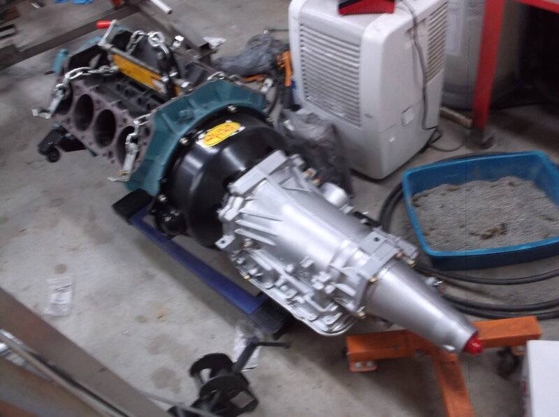

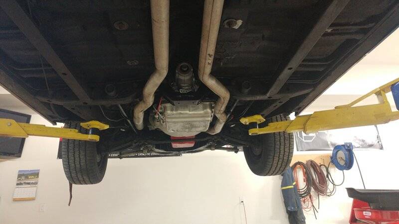

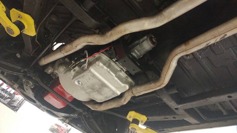

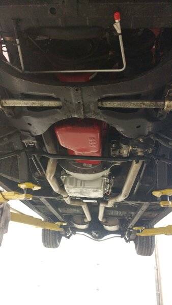

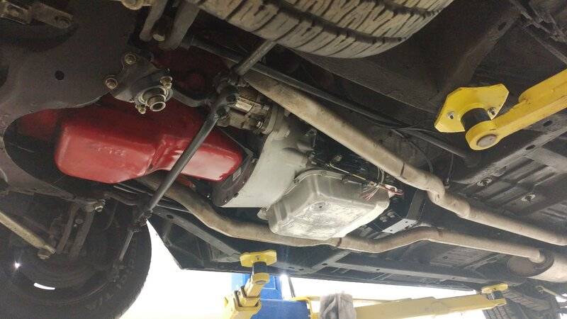

Here is my 4L60E being mocked up for motor and transmission mounts. It was built by Phoenix Transmission in Texas. It uses a Quicktime Adapter Bell Housing, so it is a 93 up General Motors transmission. Mine is built for about 550 horsepower. I asked Greg at Phoenix what we would do if it didn't stand up to the motor. He said if it failed just send it back and he would rebuild for 1000 horsepower. Yes, they can be built for 1000 H.P. I wanted the overdrive and lockup converter to help with gas economy, and this seems to be a good decision today.
The A41 is not a good choice for any horsepower and that was why I did the 4L60E.
I looked at the 4L80, but the entire tunnel would have to be re-made as it is physically much larger than the 4L60. I only had to beat out the tunnel a little and made one rectangular box for the left side. The transmission has worked well, a few times WOT, BUT not raced.
Yes, probably $4k or better for everything.
Don't know about the comment that they are the same?
Just my 2 cents.
PT in Tennessee
