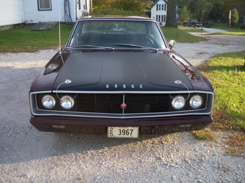

here is SEM hot rod black, nice paint , tree sap , bird crap, ect wash off with no ghost marks left.

You have a point Gpuller - I said correct. I should clarify that and say the correct look! I just care that the paint is correct looking and does the job. I really do want the hood which is fiberglass to have the correct look. Just didn't expect that a quart would cost that much.
I painted my hood 3 years ago and it looks like the day I sprayed it. My car is no queen and gets driven and yes birds do crap on it. I've read all the rat rod guys use John Deere Blitz Black, so being in a farm community and plus being a Deere fan I figured I'd give it a shot. A quart was $11, couldn't keep it wet enough to not streak and look dry. Sanded it all off and sprayed the SEM stuff. Went on like a dream. Kind of spendy at first I thought but was worth it.
