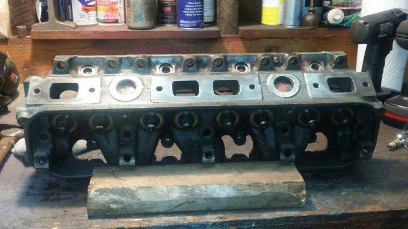

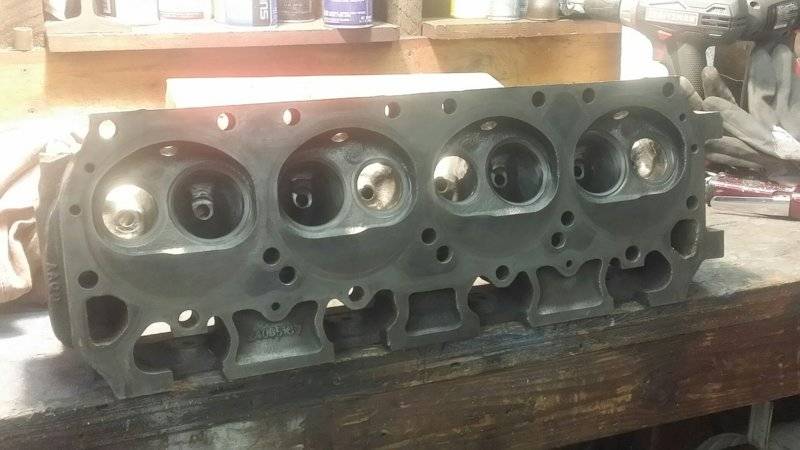

First, the valves were hand-lapped and the heads were ported a little bit. This was done last Friday April 17th, 2020. Here are a few pictures.....

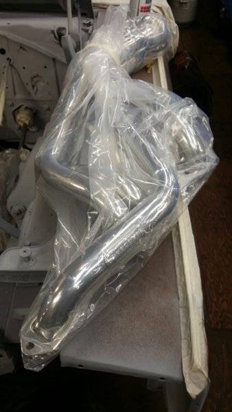

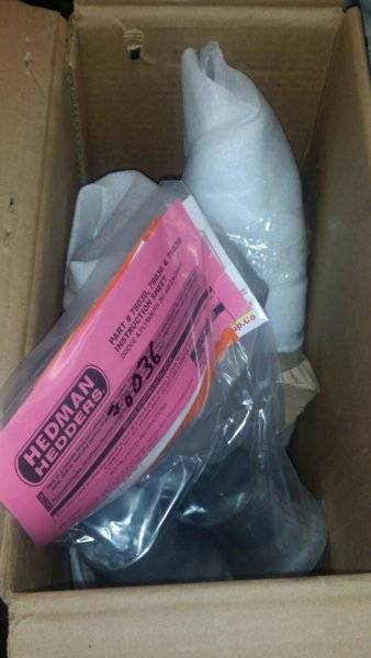

We Struck Gold!! :D. Not really, I wish :(. Just opened up the headers box and took one out to see what they looked like. That's mainly it. We opened the box on Saturday April 18th, 2020.....

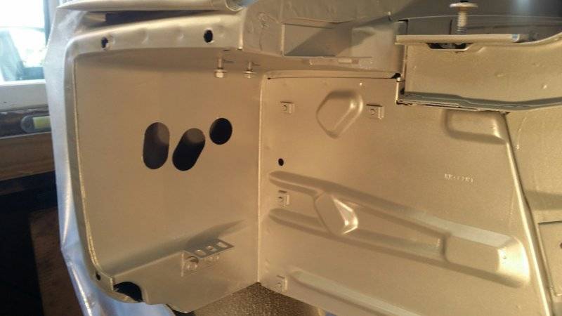

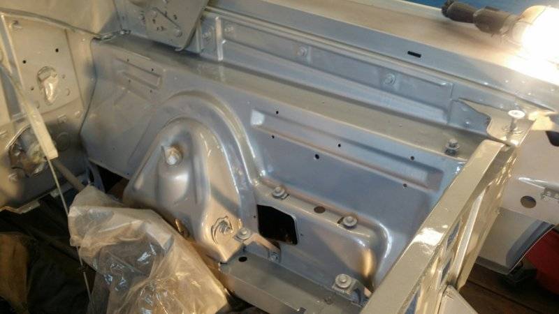

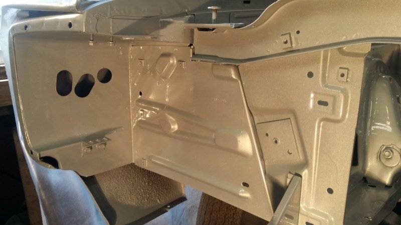

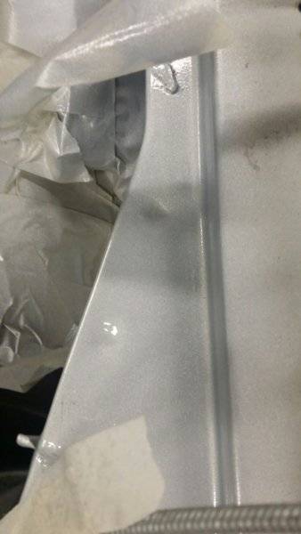

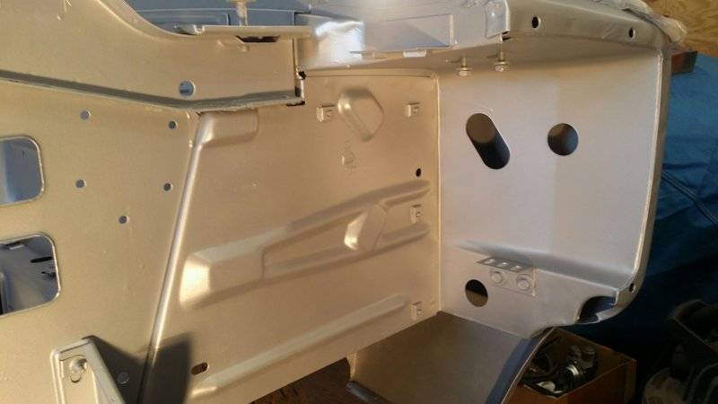

We Now Have Silver Color!!!:) :thumbsup:. It was applied Sunday April 19th, 2020. This is 2 coats before 2 clear coats.

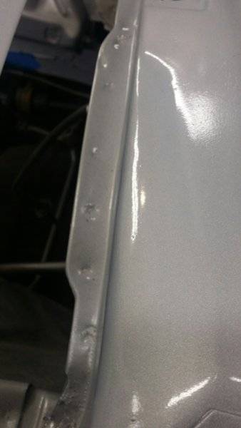

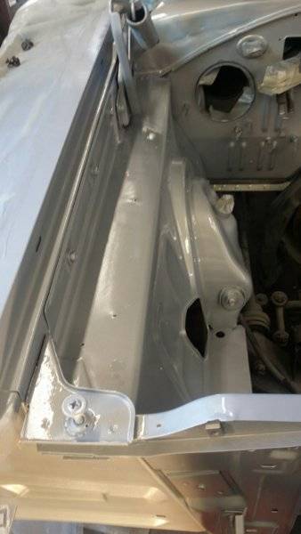

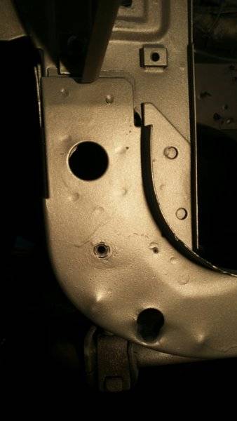

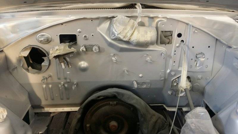

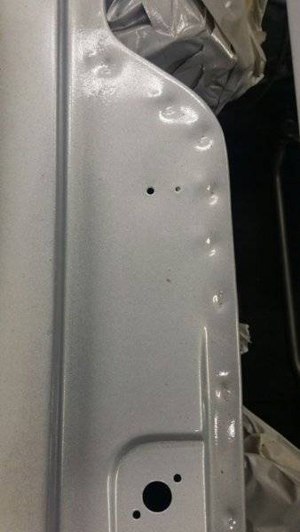

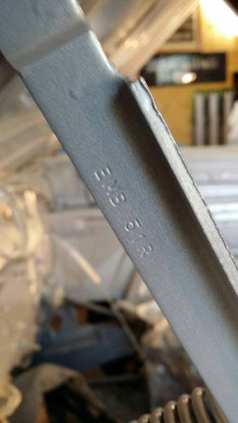

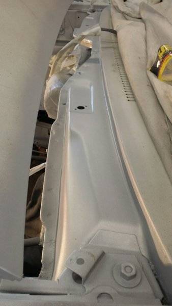

Above are more spot welds I did not notice before.....
You guys sure are going to town, lets see some pic's of your paint gun.
Thanks I appreciate it Roger. I actually did not think of getting a picture of the gun, sorry about that. This is mainly all the pictures I have for now anyways.

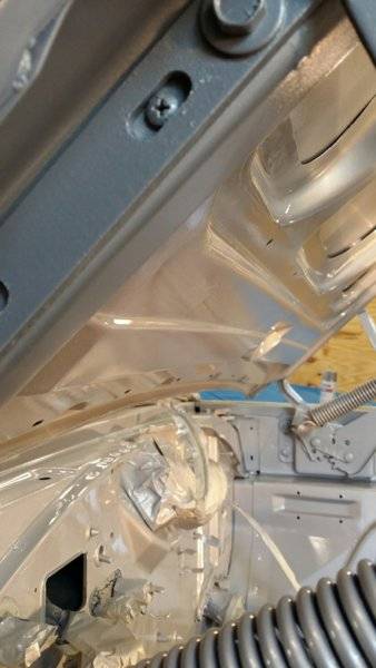

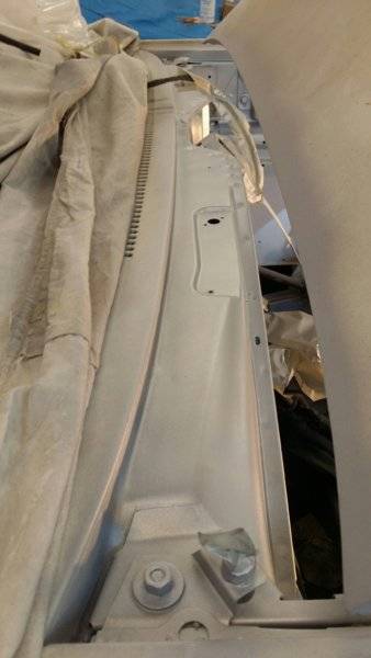

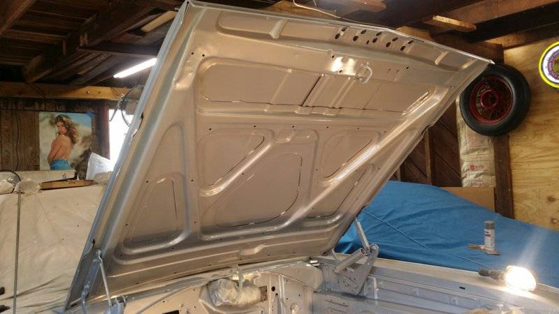

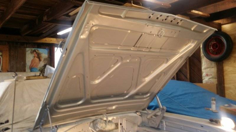

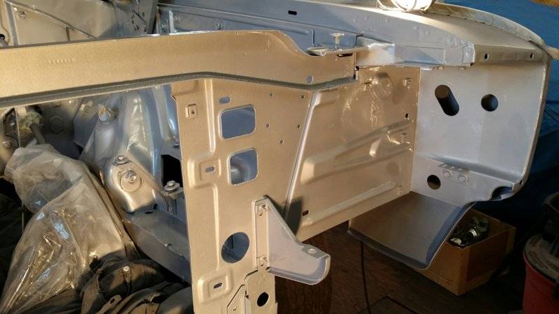

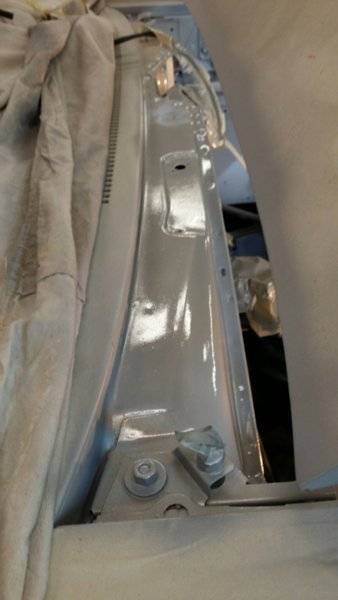

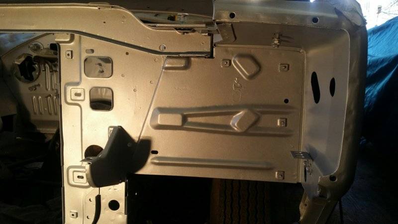

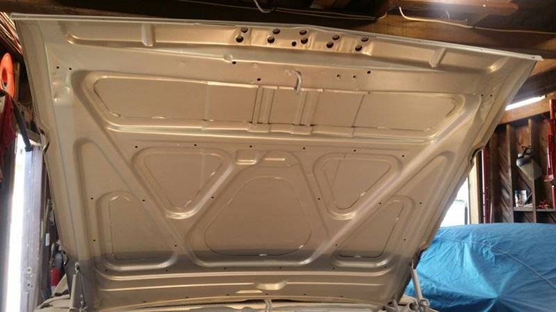

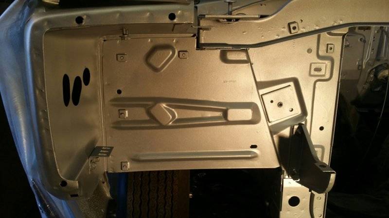

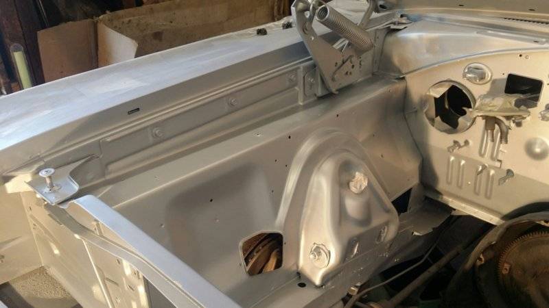

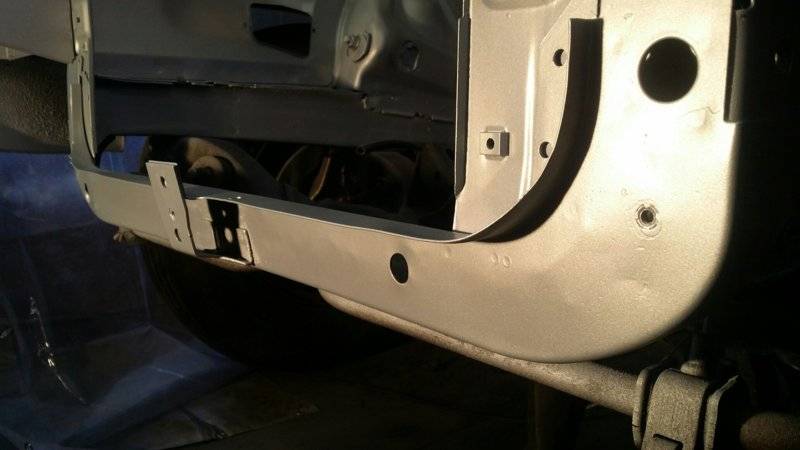

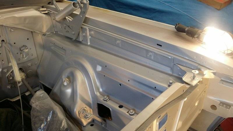

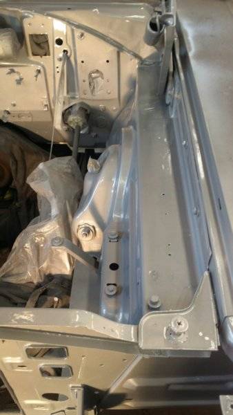

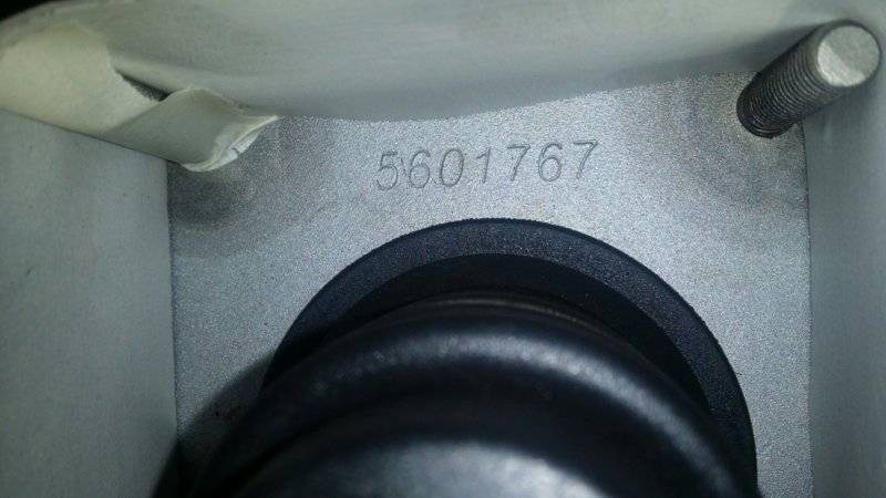

More. Notice anymore factory spot welds?. Got some on the core support, and by the cowl on both sides that I did not notice before.....

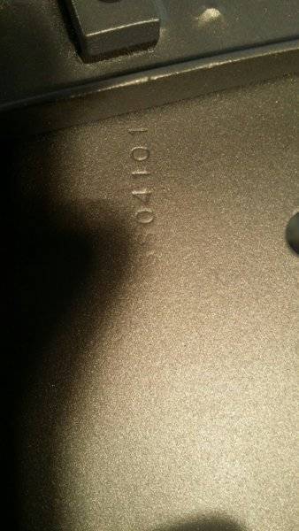

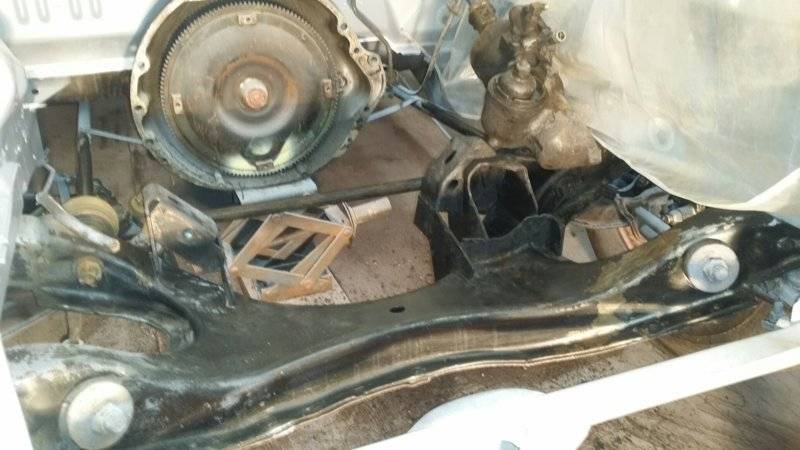

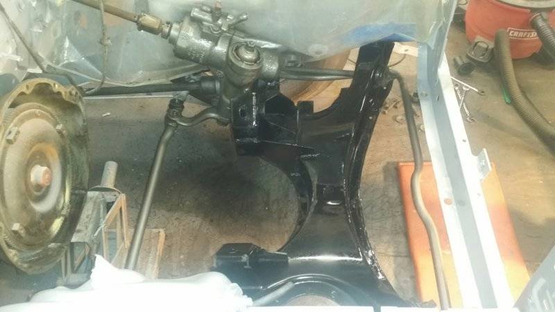

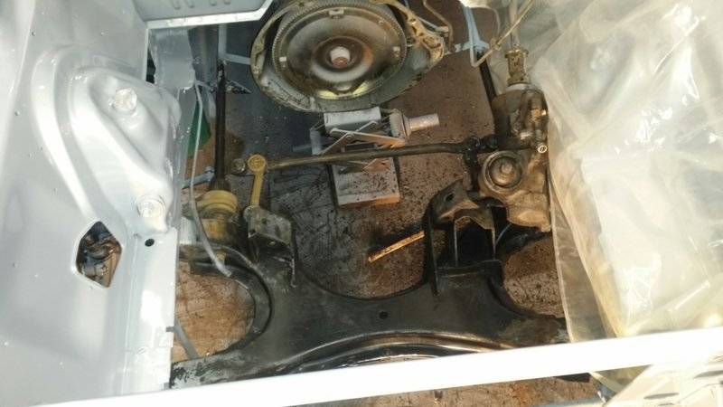

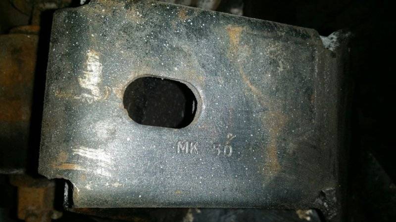

K Member Time! It was cleaned, sanded, and painted Tuesday April 21st, 2020. Here are pictures of it before.....

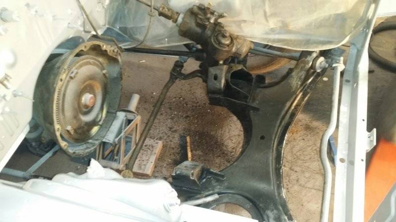

Motor mount.....

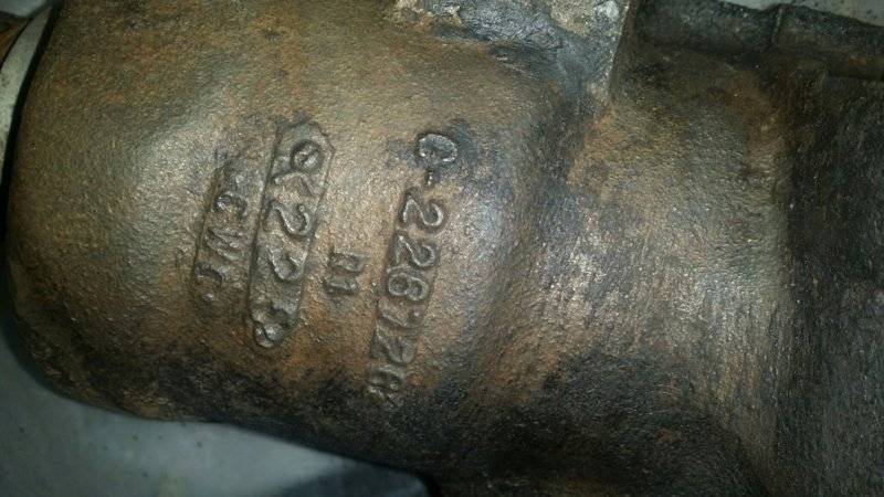

Steering box, date coded October 22nd 1965 at least to my knowledge.....

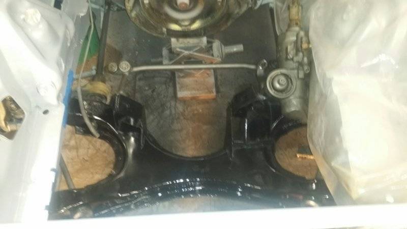

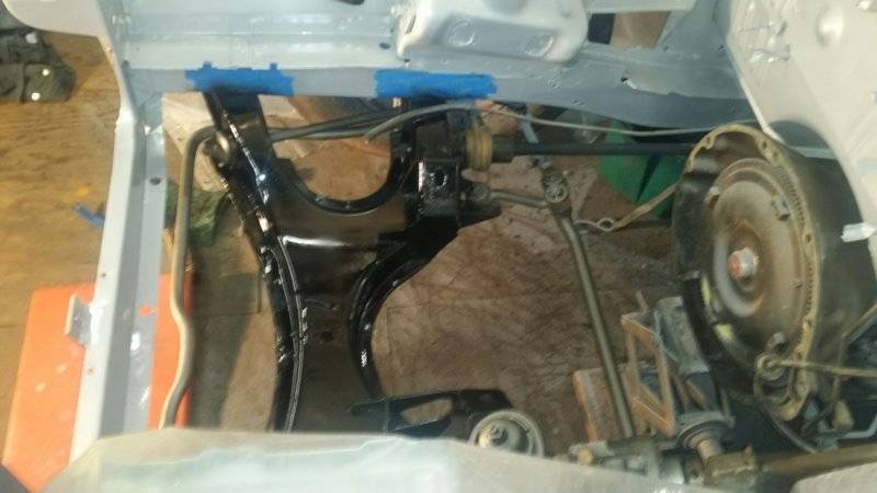

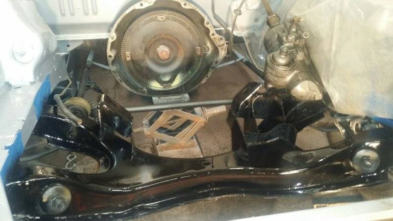

After sanding and painting.......
That is all for now. The most recent thing that was done, was painting the top side of the engine. Stay tuned for that......
It would be a good idea to replace the front seal on the transmission while you have the engine out.
Thank you for the advice Mr. Frelier. It will be checked when we take the torque converter out. As of right now it does not leak so it should be fine, but will check just in case. I will update you when it happens, most likely tomorrow as it is raining and is a lousy day here today. Stay tuned.......:)
Yes but if it's an old seal, simply pulling the torque converter in and out might cause it to start leaking.
It's an easy seal to change and inexpensive.
Now is the time to do it.
Also be careful when putting the torque converter back in that it seats all the way.
Note where it sits relative to the front of the casing now.
It needs to be there when the motor goes back in and gets bolted up.
