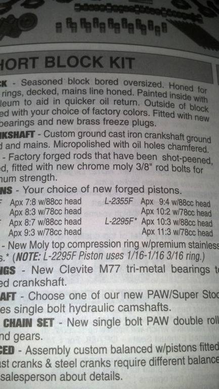

Went treasure hunting through the basement and found an old board game and the P.A.W. catalog that I purchased the engine out of back in '05-'06
So is their compression estimate close or way off? I went with the 2355f's. Is the .509 too much cam? I ordered a priming tool and timing light from mancini racing. I hope that flaming river timing light will work with the m.s.d. ignition....

What compression do u have? Do you run pump gas?
The thing is i'm learning more and more as time goes on. But what confuses me is compression and quench. I understand that quench is to be set around .040- .050 to get a good burn. But how can guy's say the have 10:1 and this quench. Or 12:1 and quench? The engine I bought is thought to be 9.4:1 compression, but it has open chamber "452" heads. So i'm doubtful I have anywhere near good quench. So how is this going to effect my engine and which octane gas should I use? I realize I haven't picked the ideal components for this engine, but how do I make what I have work? Or should I just start looking for a closed chamber head?
