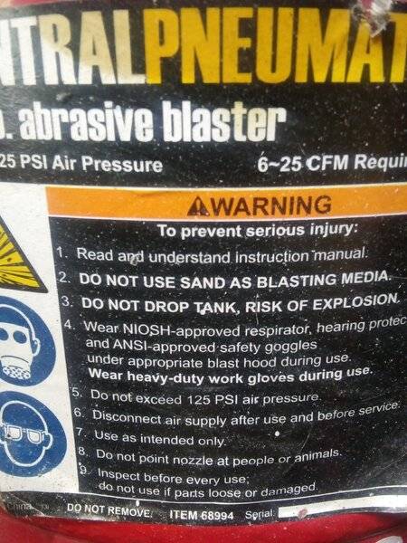

Horror freight seems to be a slippery slope when it comes to blasters. They put labels on all i've seen saying, not for use with sand. Though they don't list what media they're intended for. I haven't found a good soda blaster yet. I've thought of building one from scrap.
