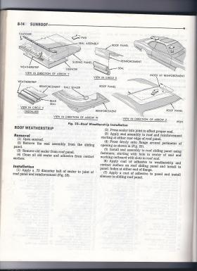

Well, I found the diagrams, but the don't show the wheel well end of the drain.
They're a bit intimidating to decipher.
I was looking for the cable drive layout, and that is perhaps the most difficult thing to see. I think they may have even omitted the cabe for "clarity".
They also look like crap at firts glance, but enlarge nicely and become quite clear.
