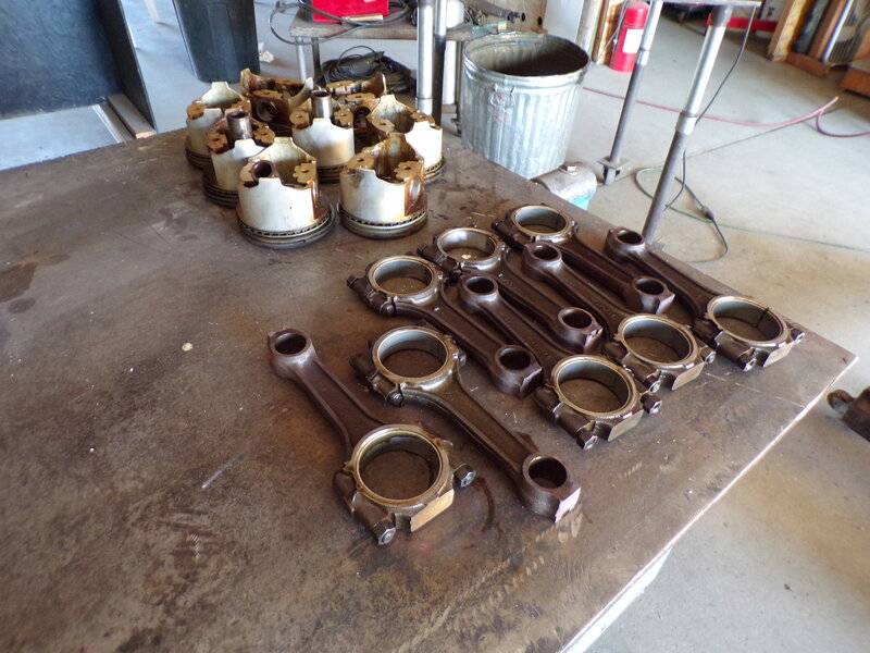

I used the 6.358/400 rods...............Do you use the 440 or 400 rods?
Polished the beams just to reduce the weight and added ARP rod bolts............they will be resized by Performance Machine in Idaho Falls.......the same people who will grind the crank...........
I used the shorter 400 rods simply because I could buy pistons for those at a lower cost...........
