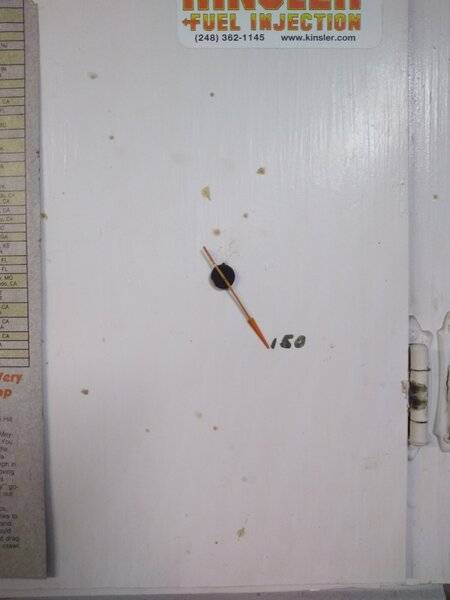

Usually if the speedo is good so is the odometer and you can set it to match the one you have.
I did it in the Plymouth.

The Odometer is an integral part of the Speedometer assembly, and won't function on its own. If you want to retain the mileage reading, write down the number or take a picture before sending it for repair. Setting the odometer to display what you want is a fairly simple process unless you drop all the small parts on the floor.

@patrick66 Sorry, don't know of a shop to send it too but they are not that hard to work on. I've done a couple myself over the years. The only reason I can think of why the needle dropped down past the zero mark is because it came loose from it's post. Open it up and take a look. It wouldn't be the first time to see that sort of thing. Chances are that all you need to do is press it back on....but be gentle with it. It's delicate.

I've had the cluster out. The needle is still on the post. There is no "springiness" to the needle. It just lays flat to the "zero" side. Tried to get the needle to do it's thing a few times. I'll look one more time before I send it out to see if there was something I overlooked.
