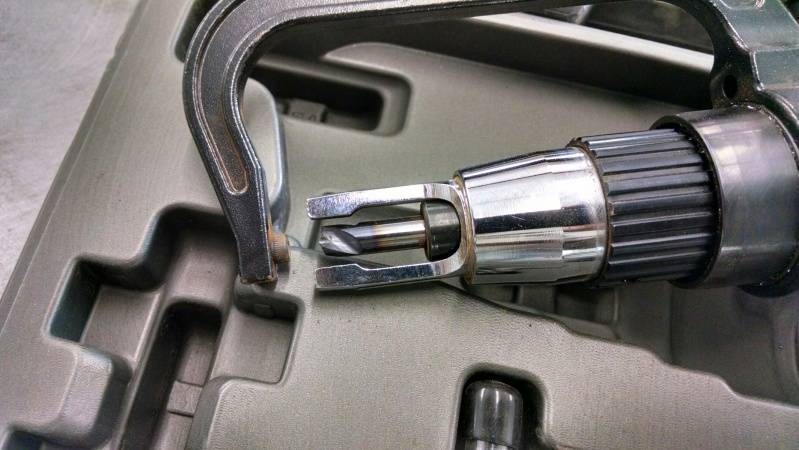

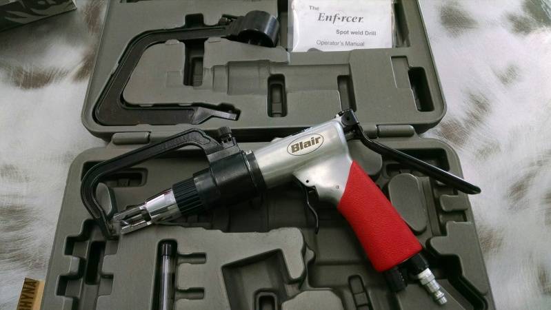

For many years I've struggled along with a cordless drill and the best drill bit I can find. Blair bits have led the pack for quite a while, but pair the Blair bit with the Blair "enforcer" drill... Wow, I truly love this tool.
Its like having a drill press that you can bring to the car. The forward trigger is to turn the bit, the rear lever draws the bit into the work. The depth of the hole can be fine tuned by dialing the area that would normally be a bit chuck.
Edge pinch welds are effortless. And you can fit an edge panel without pre drilling for plug welds. You can hang the panel and drill the plug weld holes in the perfect spots with depth control.
Simply put, this tool isn't cheap, but it us freaking awesome.

Thanks for the review Dave. Pretty sweet tool. Do you still need to dimple the spotwelds with a punch before drilling?

I haven't been using a punch.

don't go buy a cheaper knockoff
i have the eastwood version of that tool and
its not that great,i rarely use it.
maybe that blair one is a better tool.
i still use my electric drill with a blair bit most of the time.
