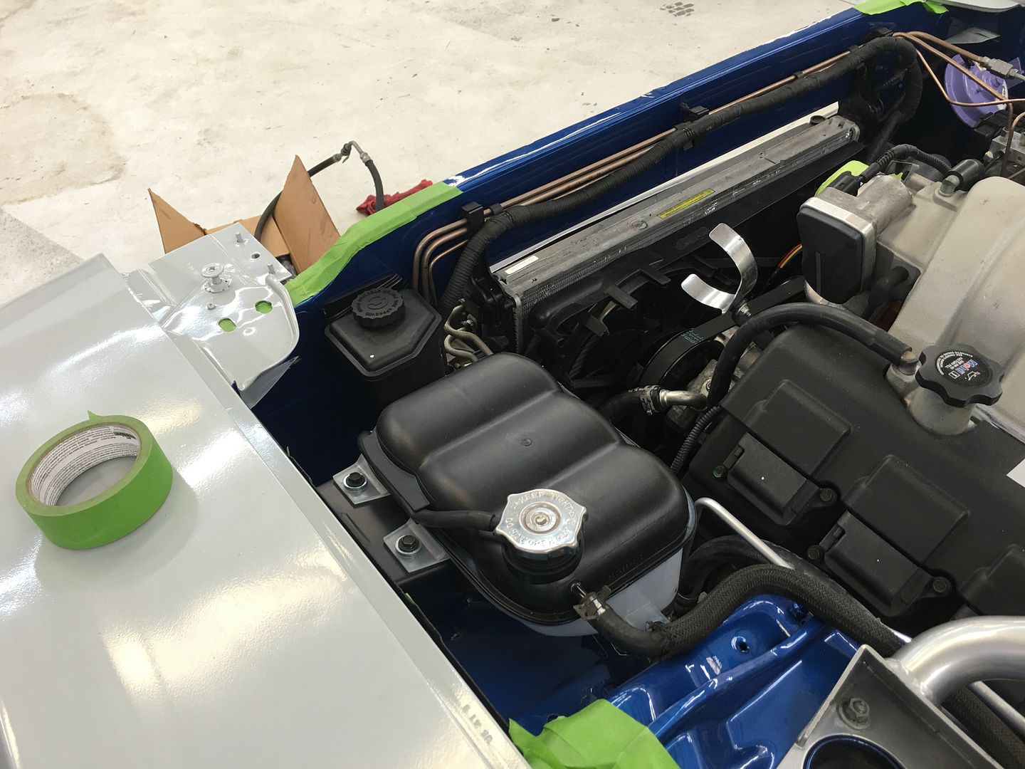

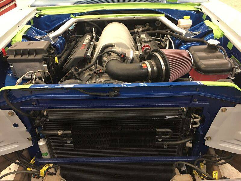

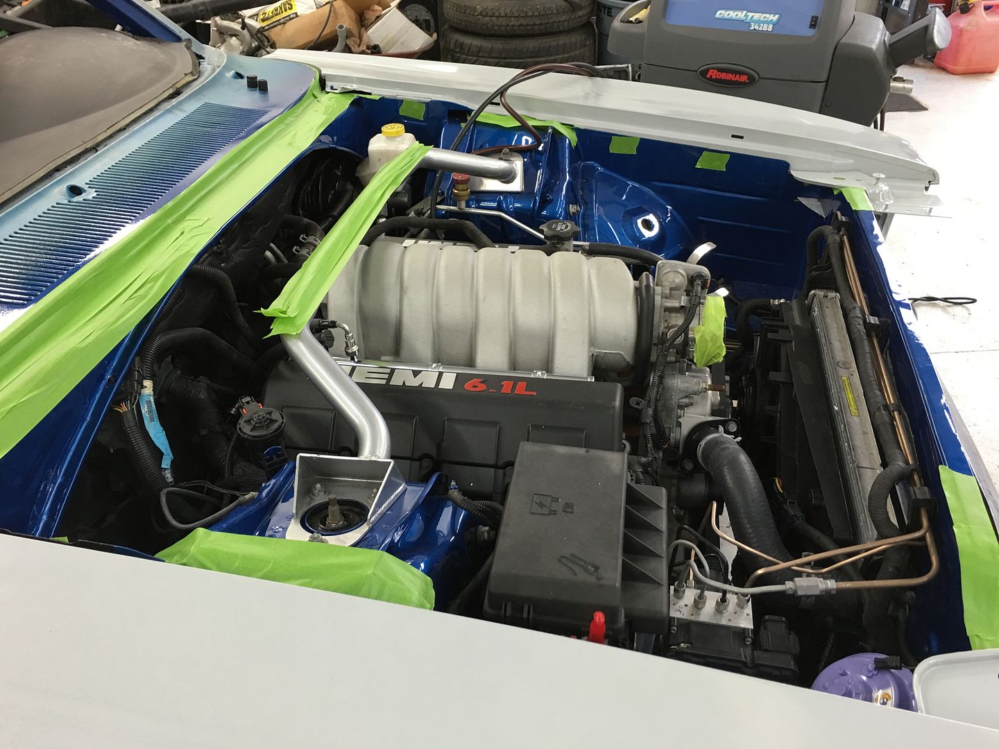

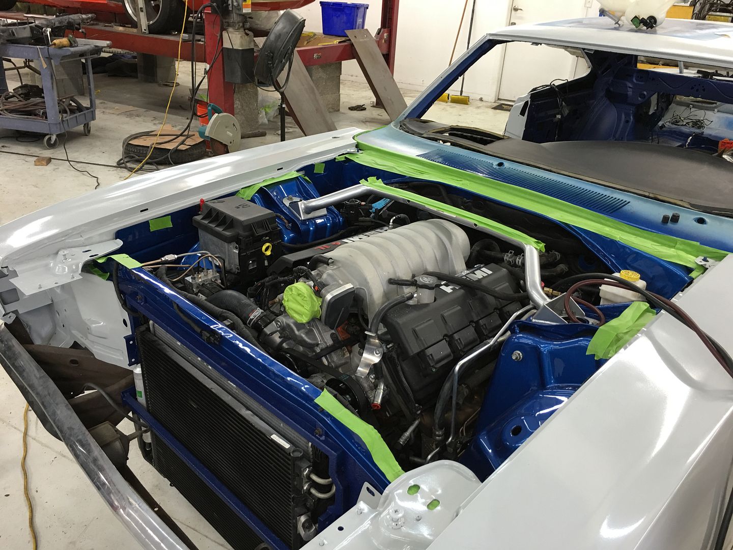

Threw the fenders on and bumper to fit the washer bottle. Need to make the surge tank and P/S reservoir bracket, and then calling it done up front. Per Darius, vacuumed A/C system and charged to verify no evaporator leaks. Much easier to switch out now if necessary, but it's good.

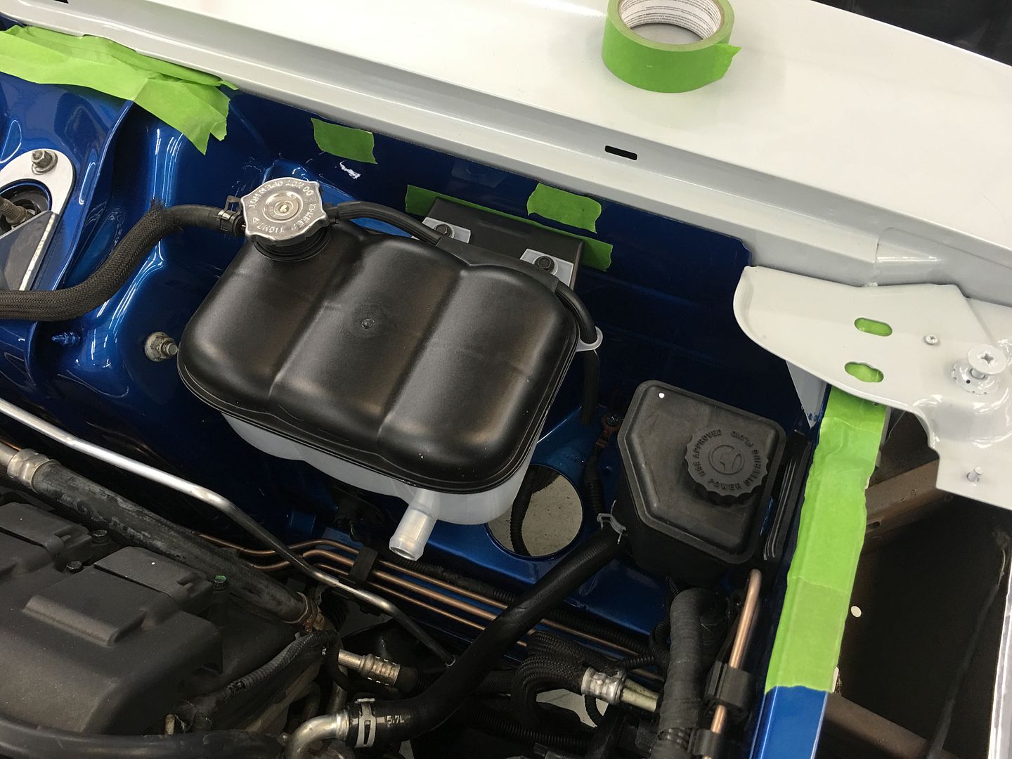

Got the coolant tank and P/S reservoir mounted. Keeping it Mopar and used the SRT res and a coolant tank from 2003- Hemi Ram.

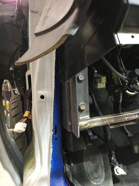

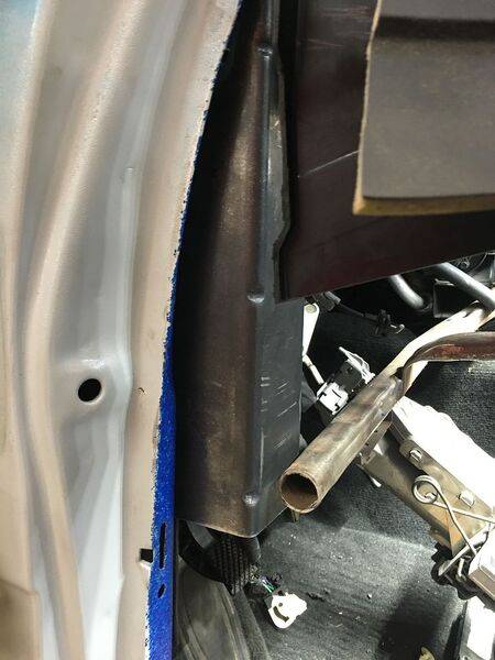

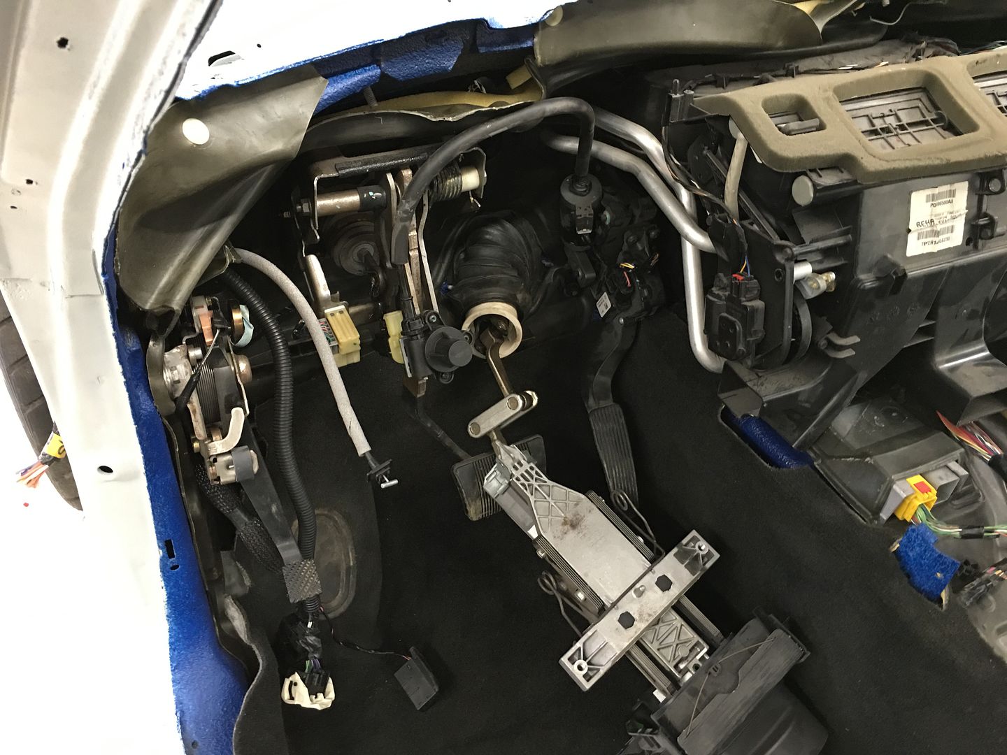

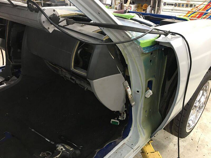

Been buttoning up the million little things. About done with the dash, which means it's ready to fire up and drive on a trailer to the body shop!!

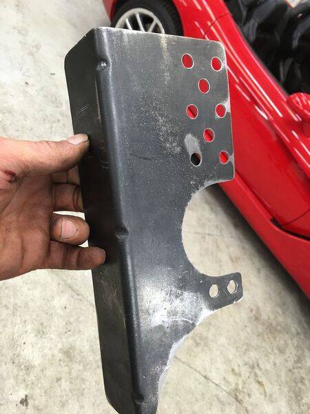

The dash brackets. Starting the upper, forward attachment and A-pillar clearance next. Upholstery guy deals with the finish work.
