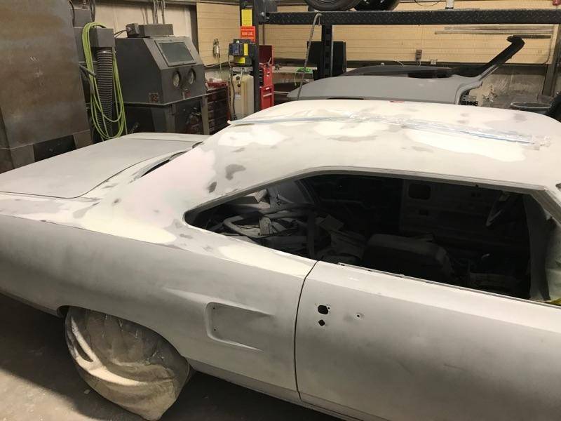

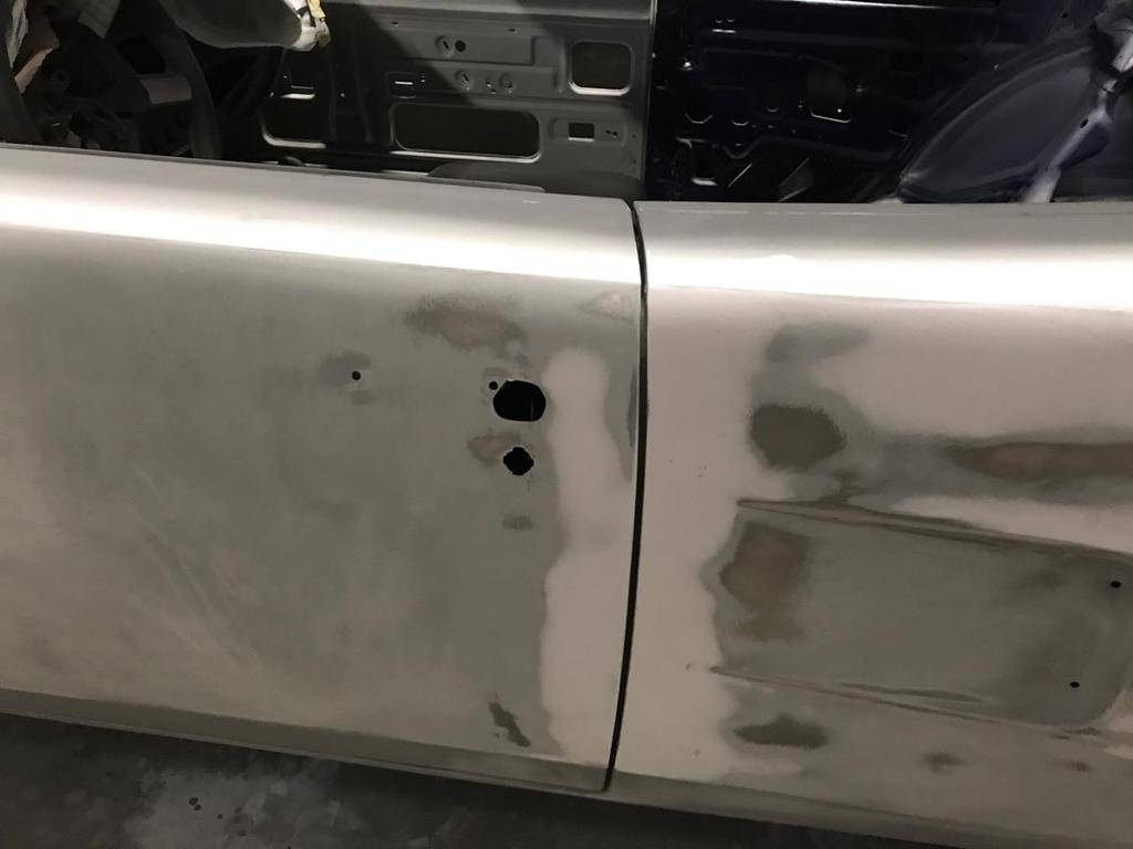

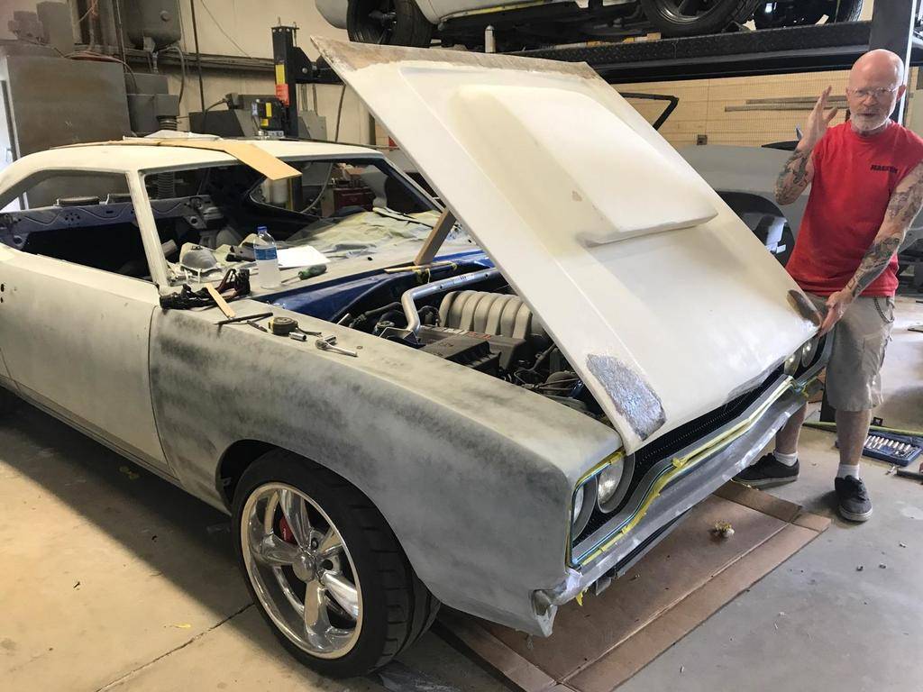

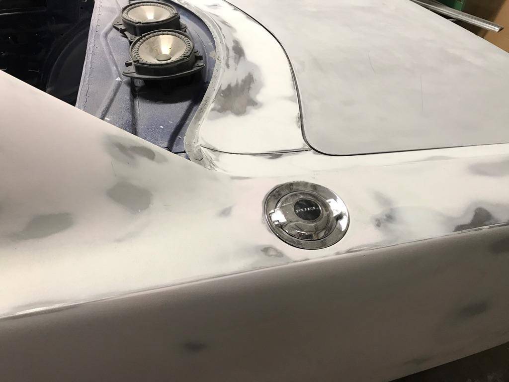

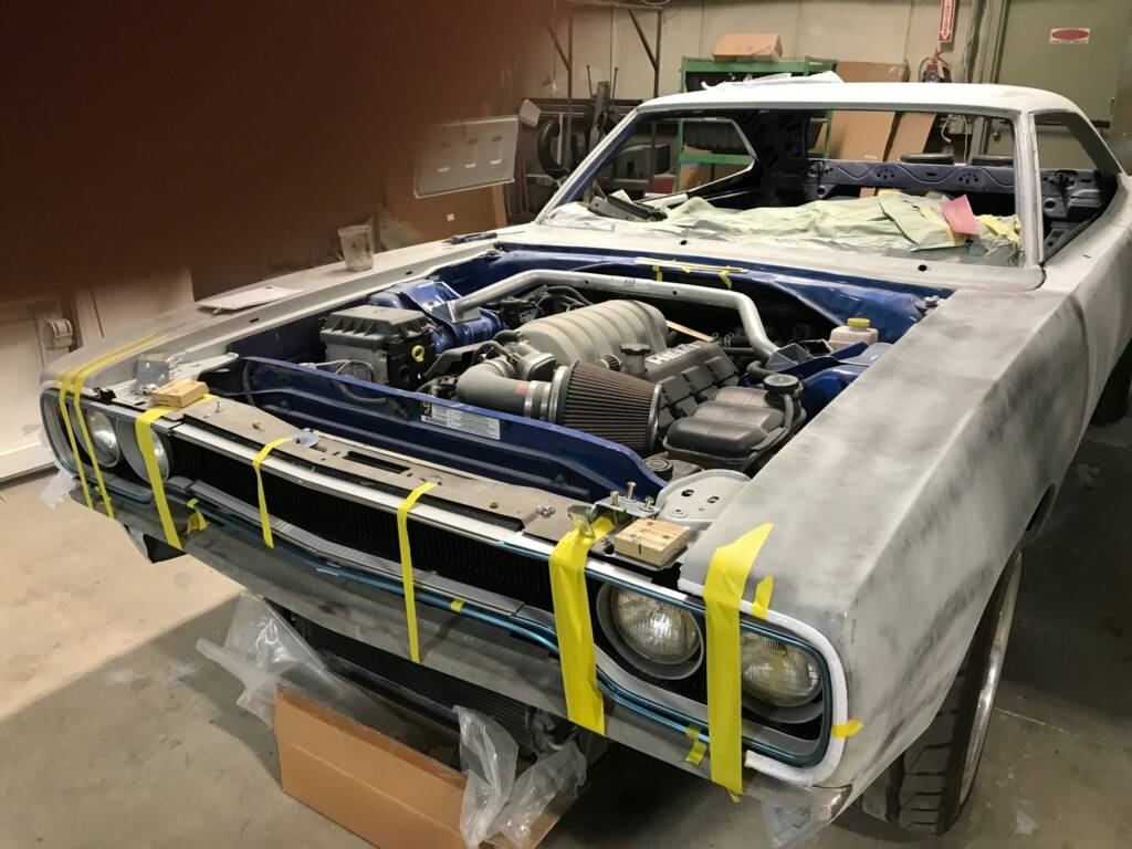

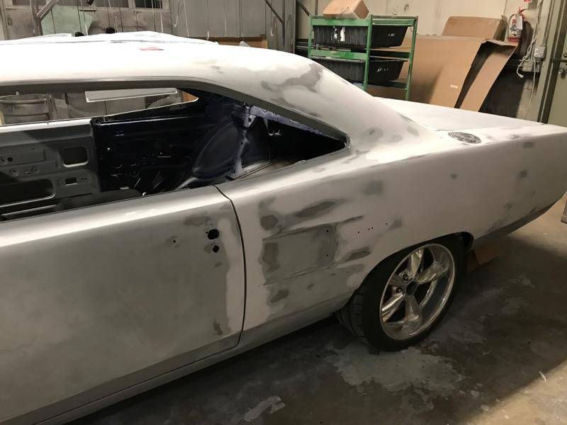

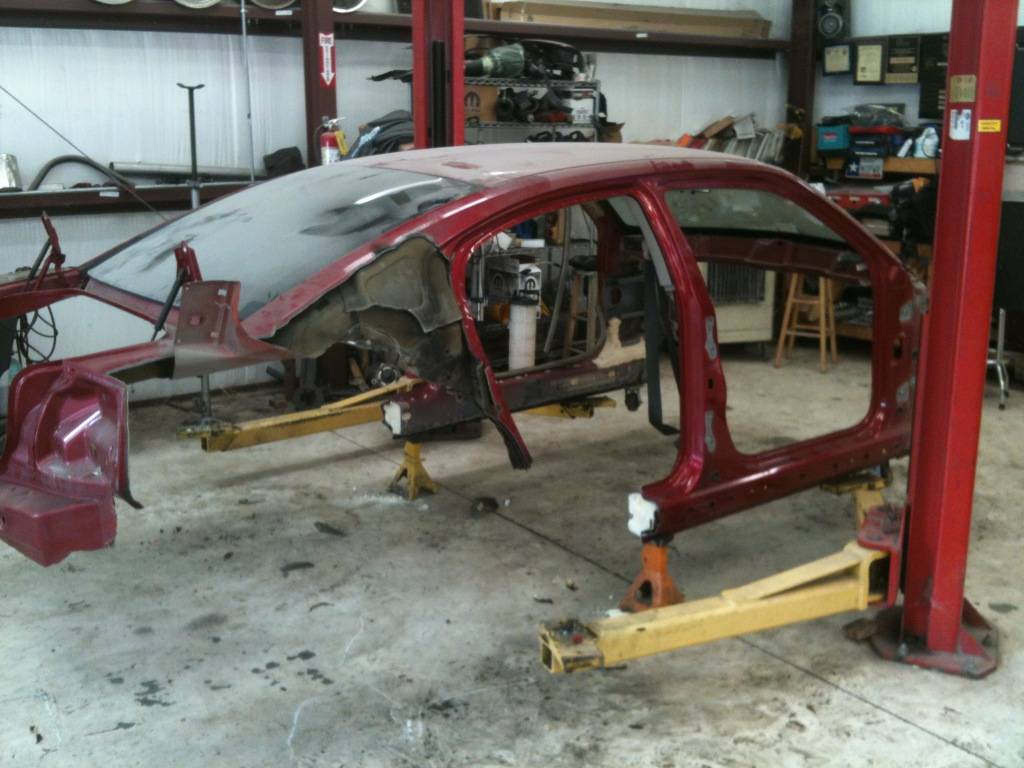

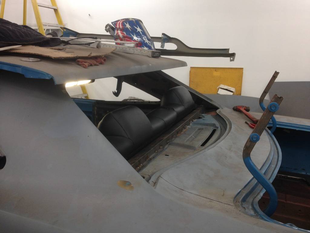

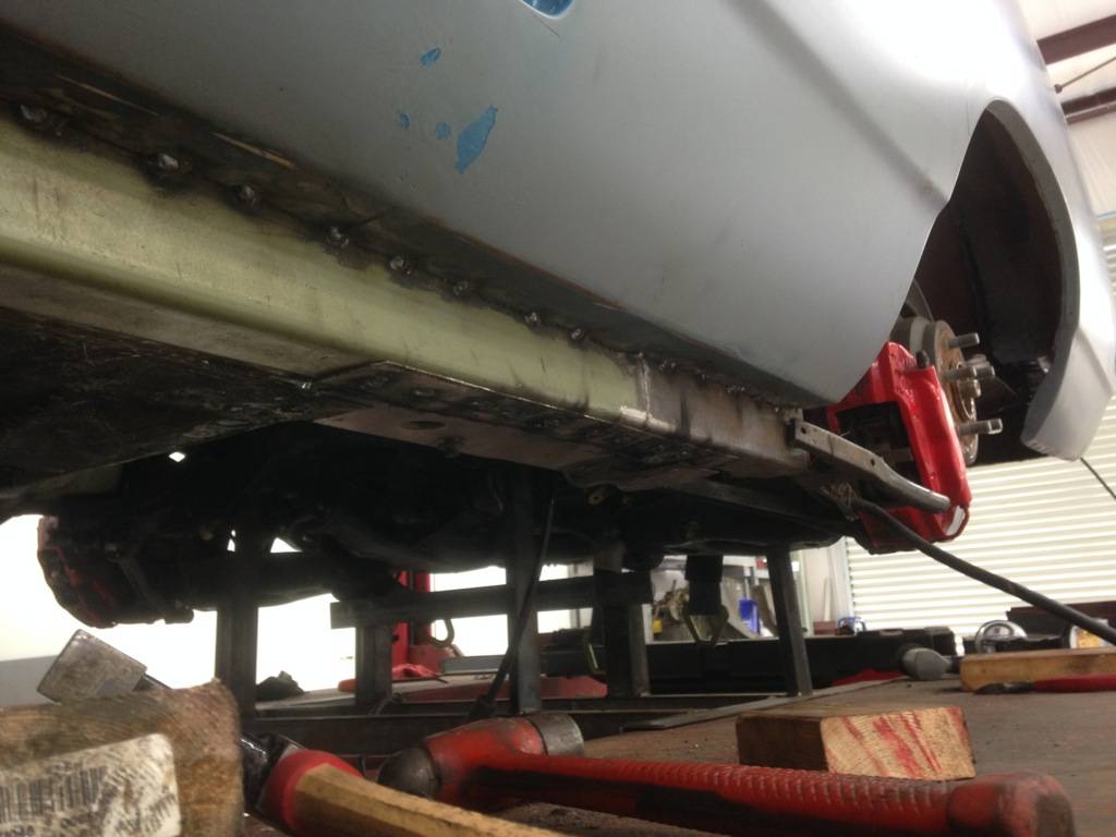

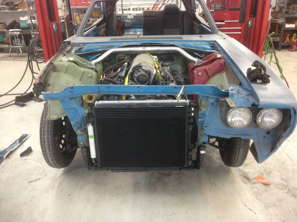

Sorry guys, never got a notification of replies to the thread. That being said, paint jail with no parole. Being told a "few months". This is what I got from the shop last week:
couldn't they at least cover up some of the car without getting body shop dirt all over that sometimes is the hardest to get rid of when done :popcorn: it's going to look very nice when done :thumbsup:

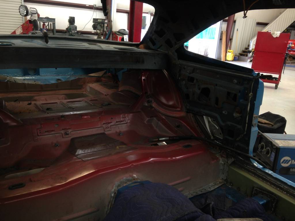

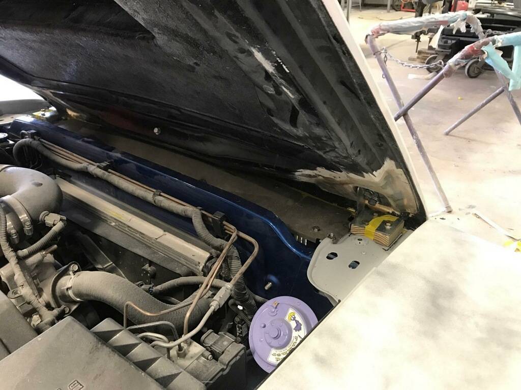

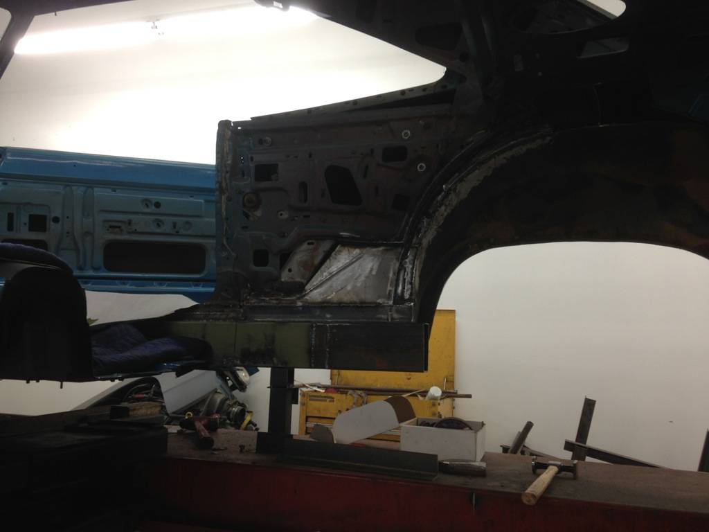

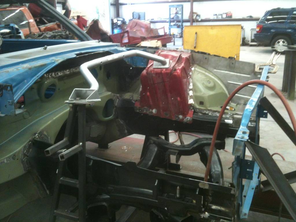

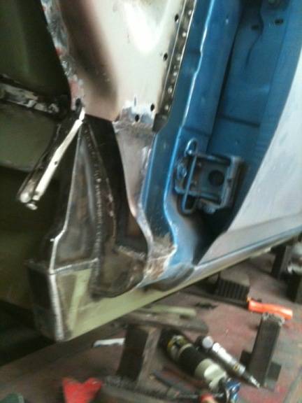

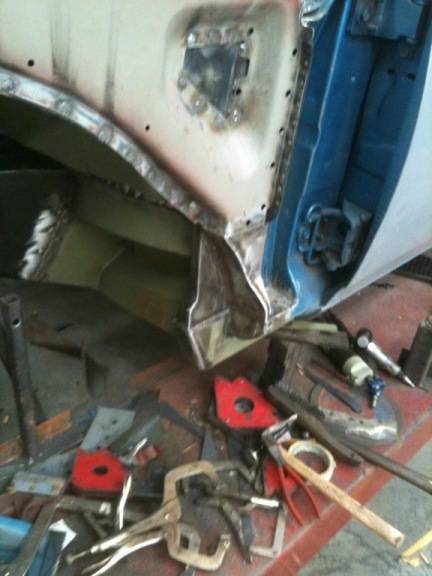

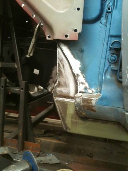

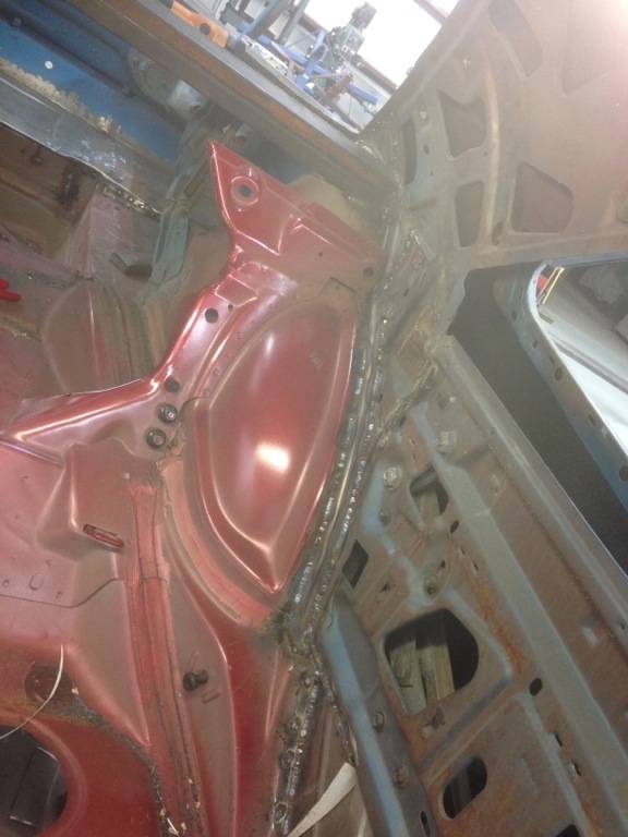

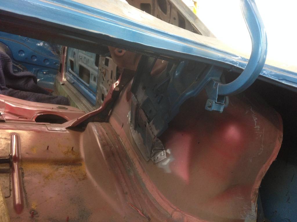

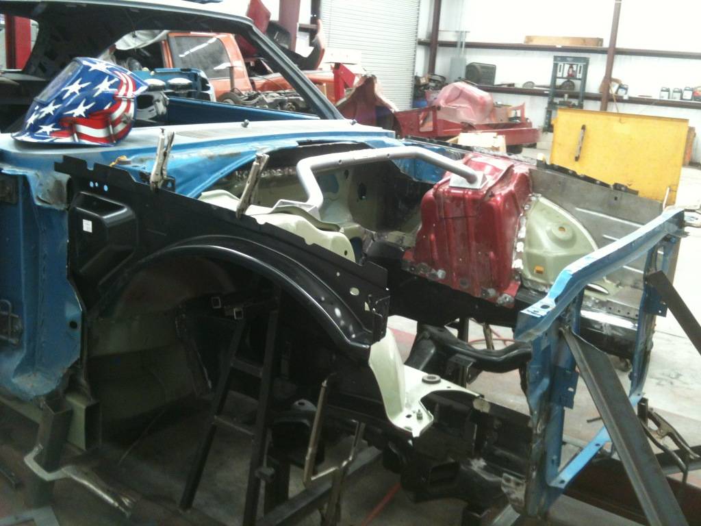

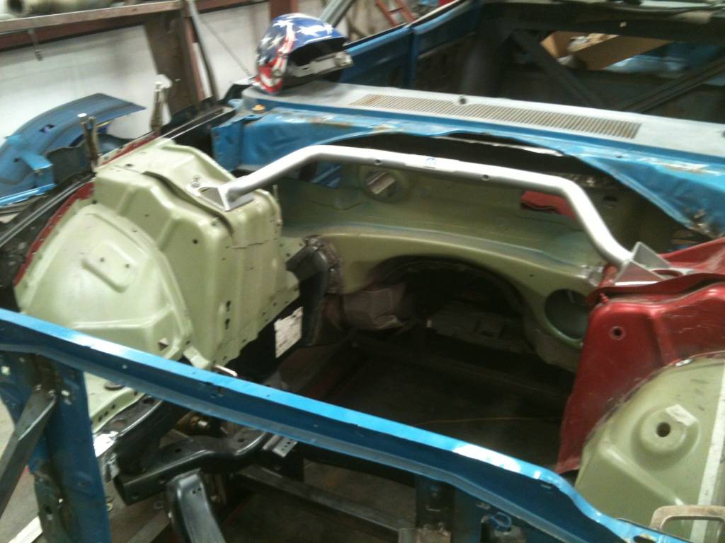

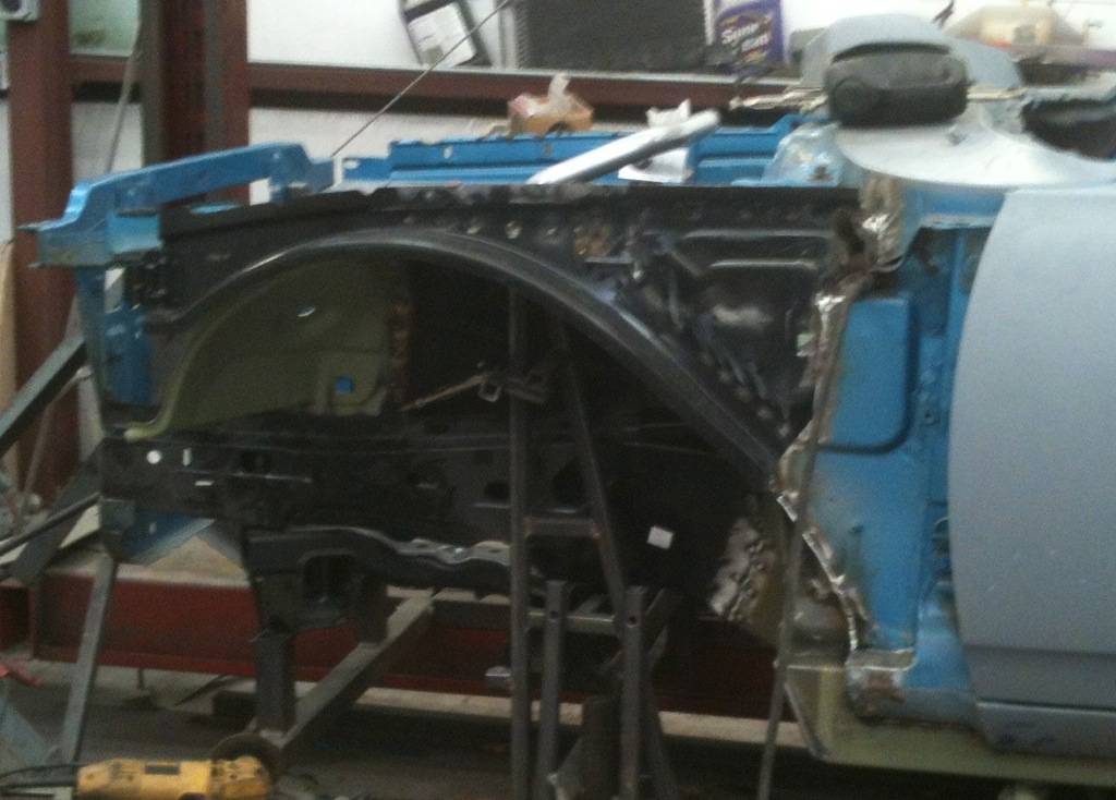

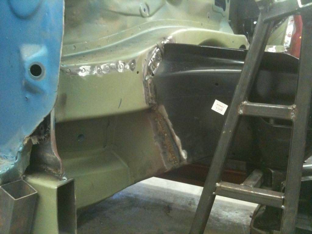

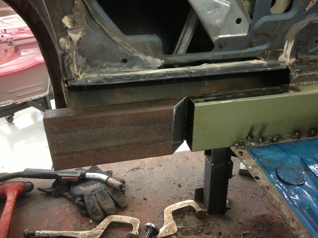

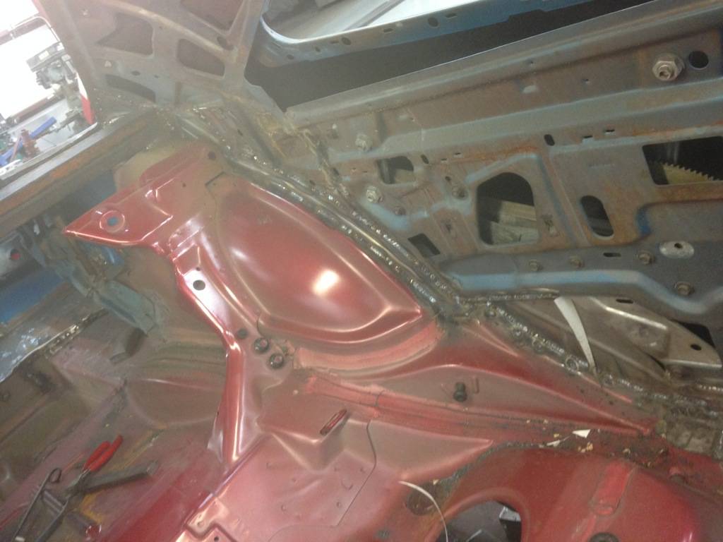

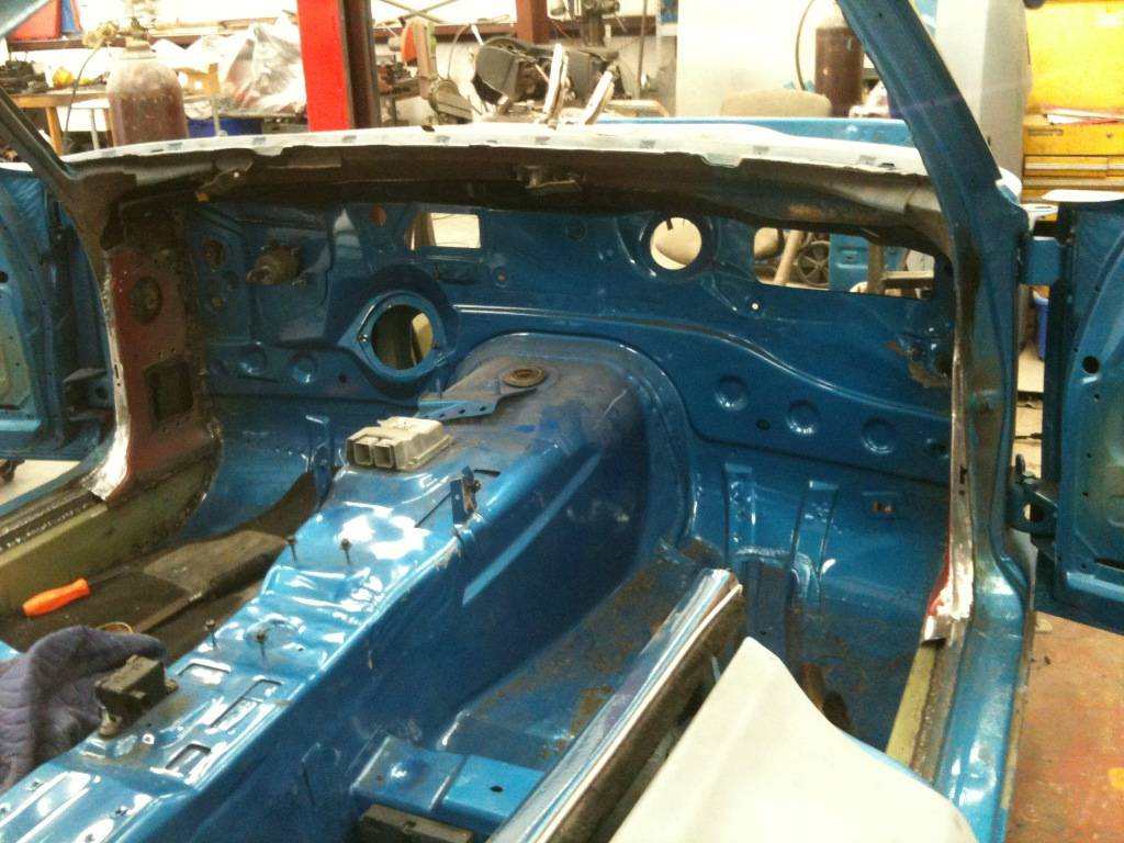

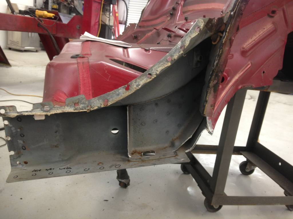

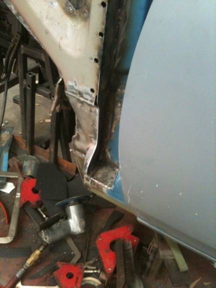

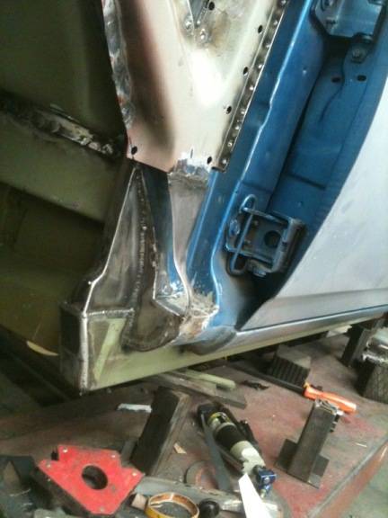

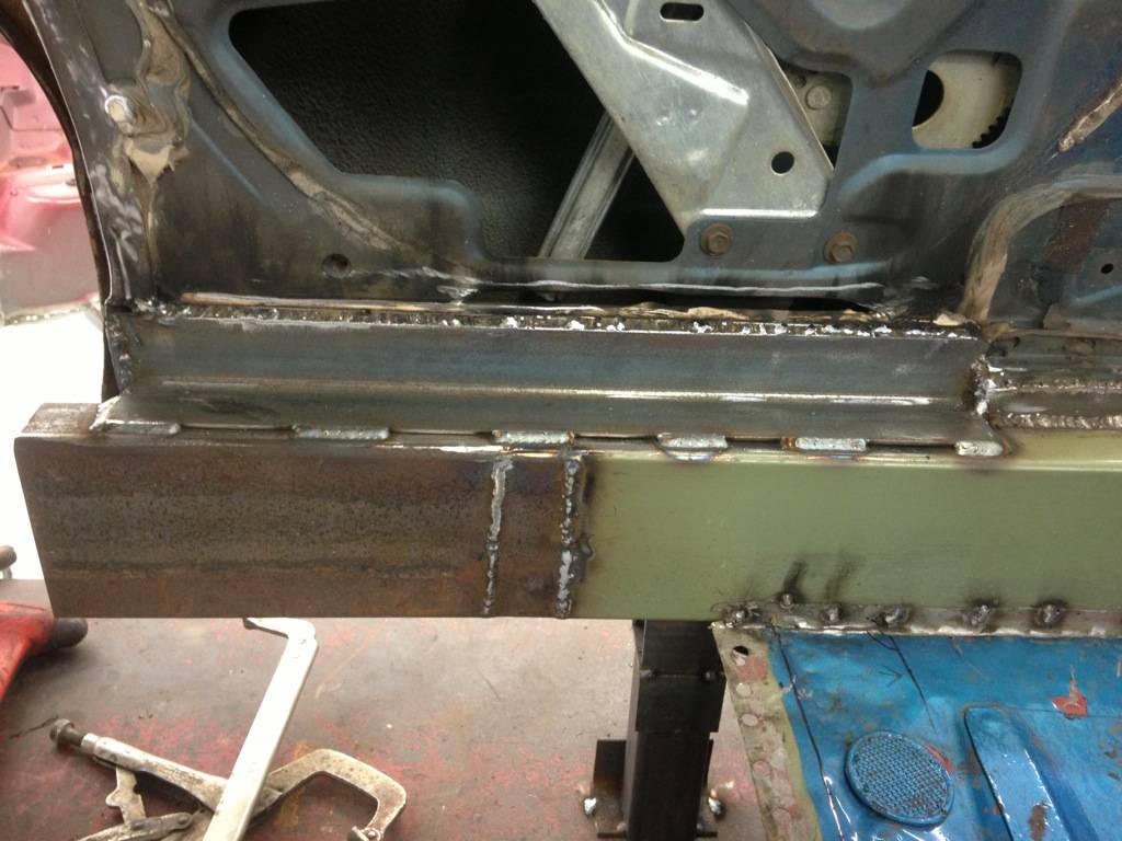

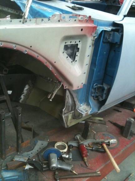

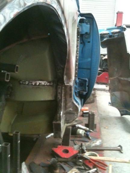

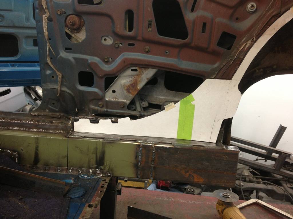

Back to it. Now to tie the firewall structure to the RR. Again, in layers, for strength:

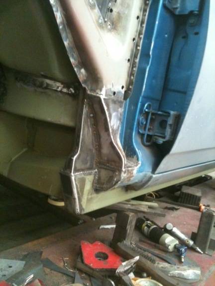

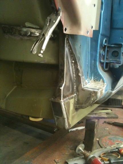

An example of the layers here. Tying the LX structure to the box beams and RR cowl and door support:

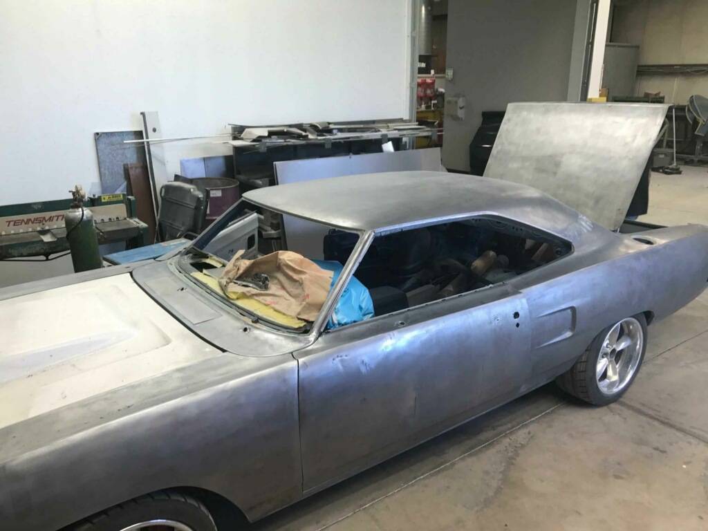

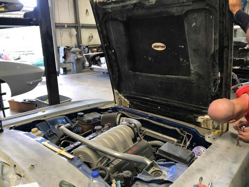

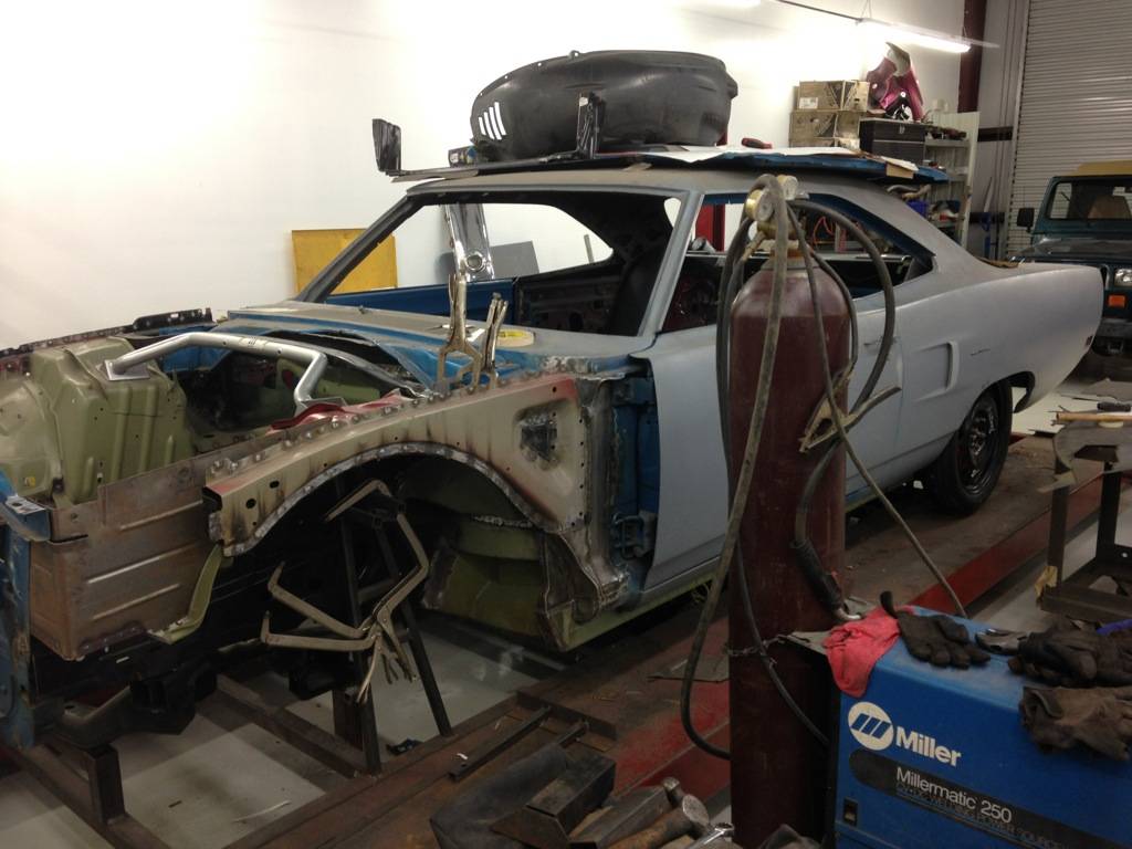

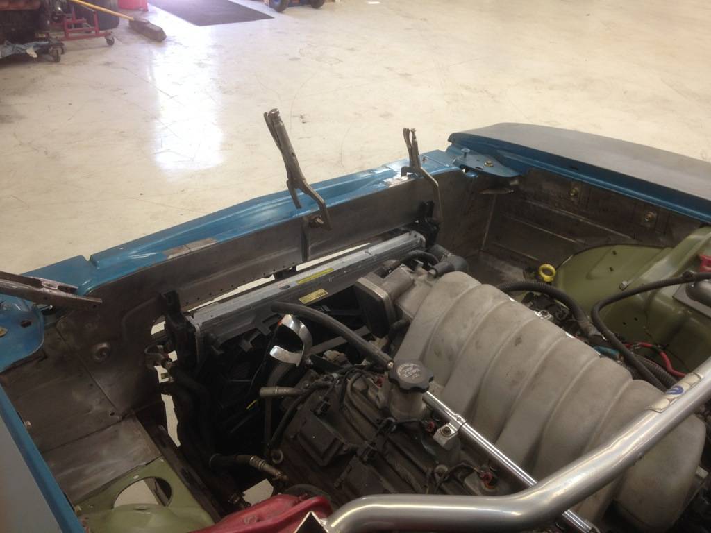

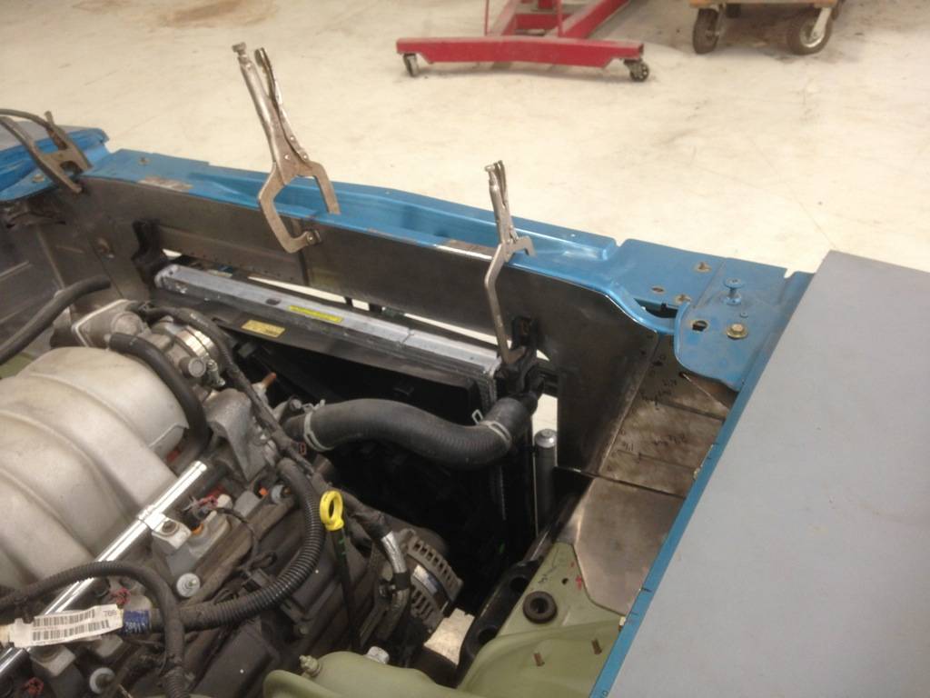

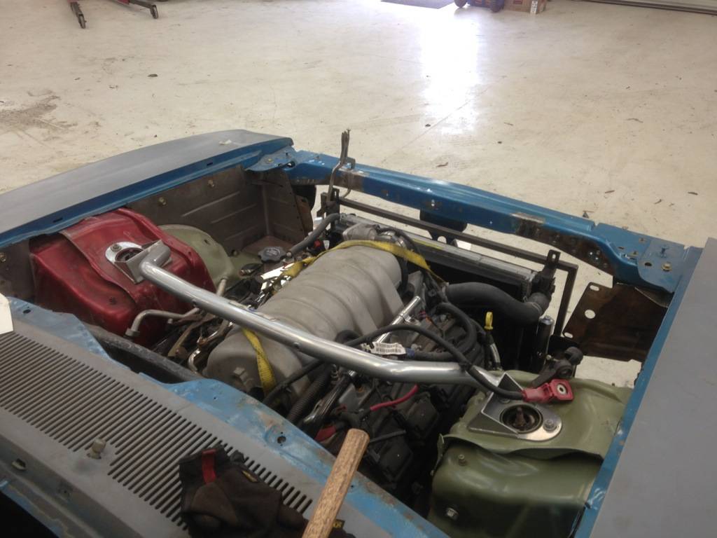

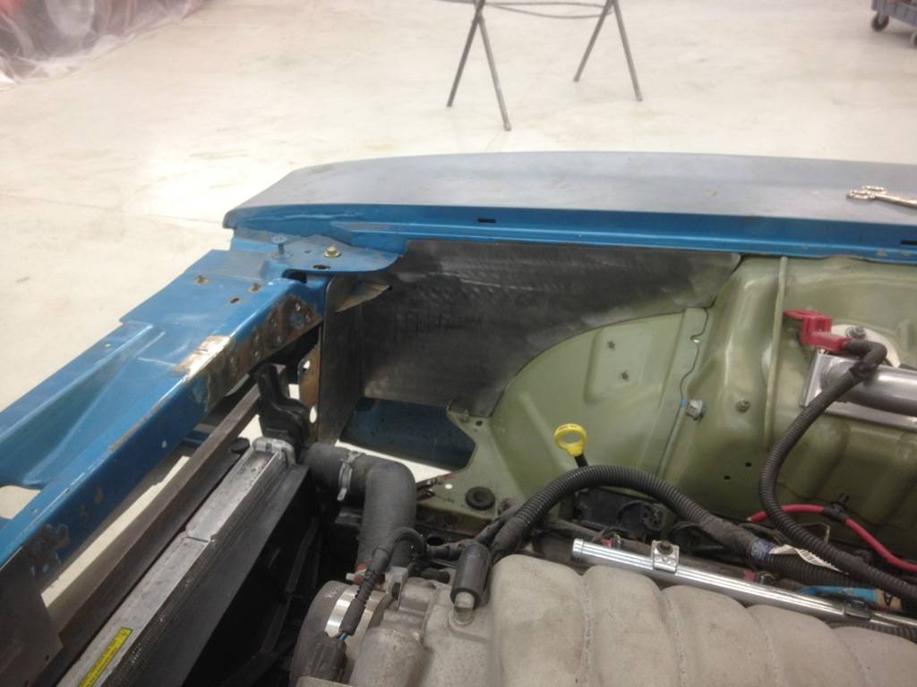

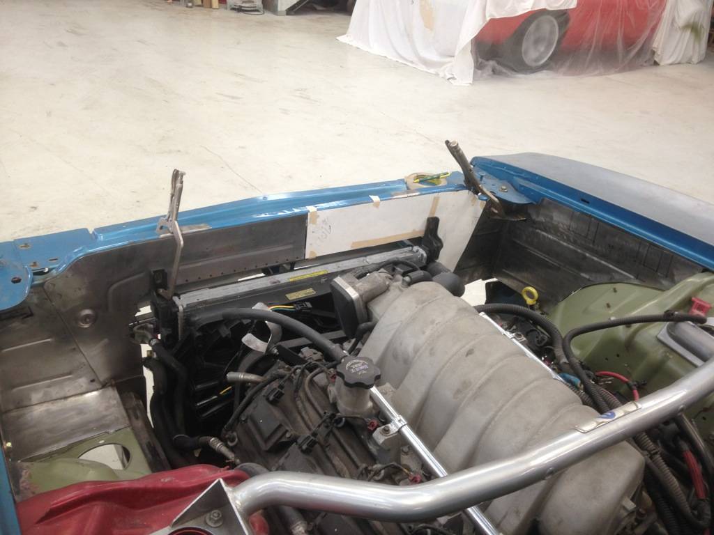

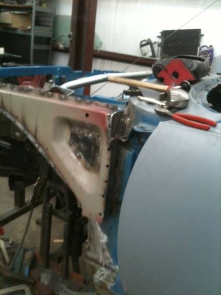

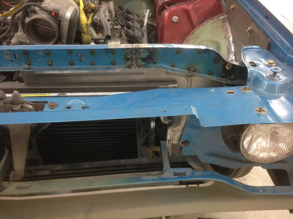

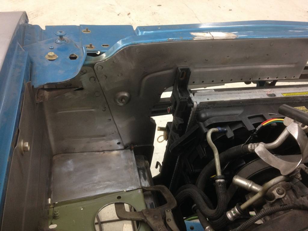

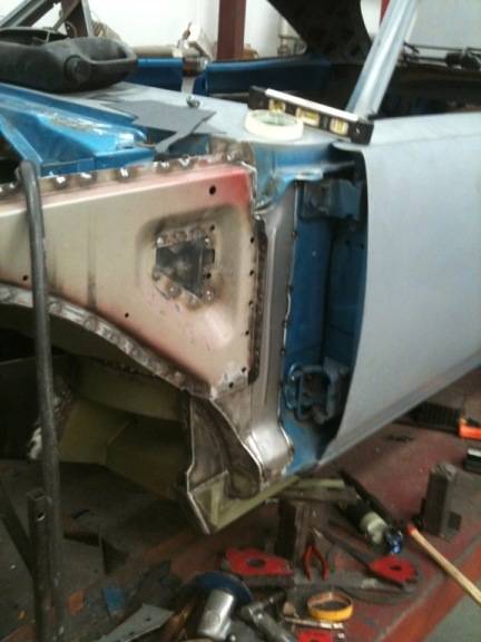

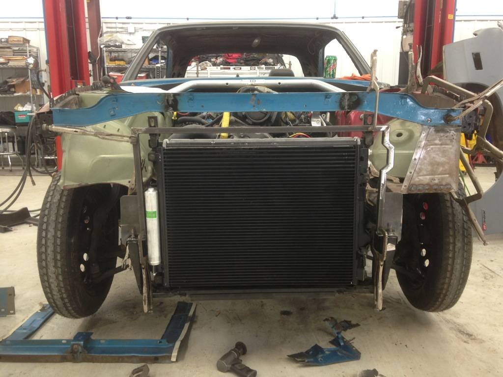

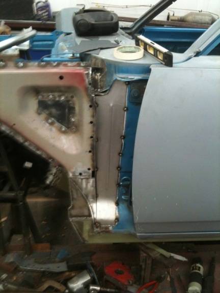

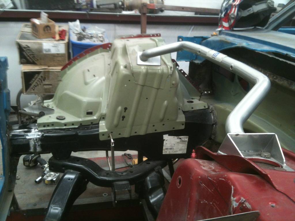

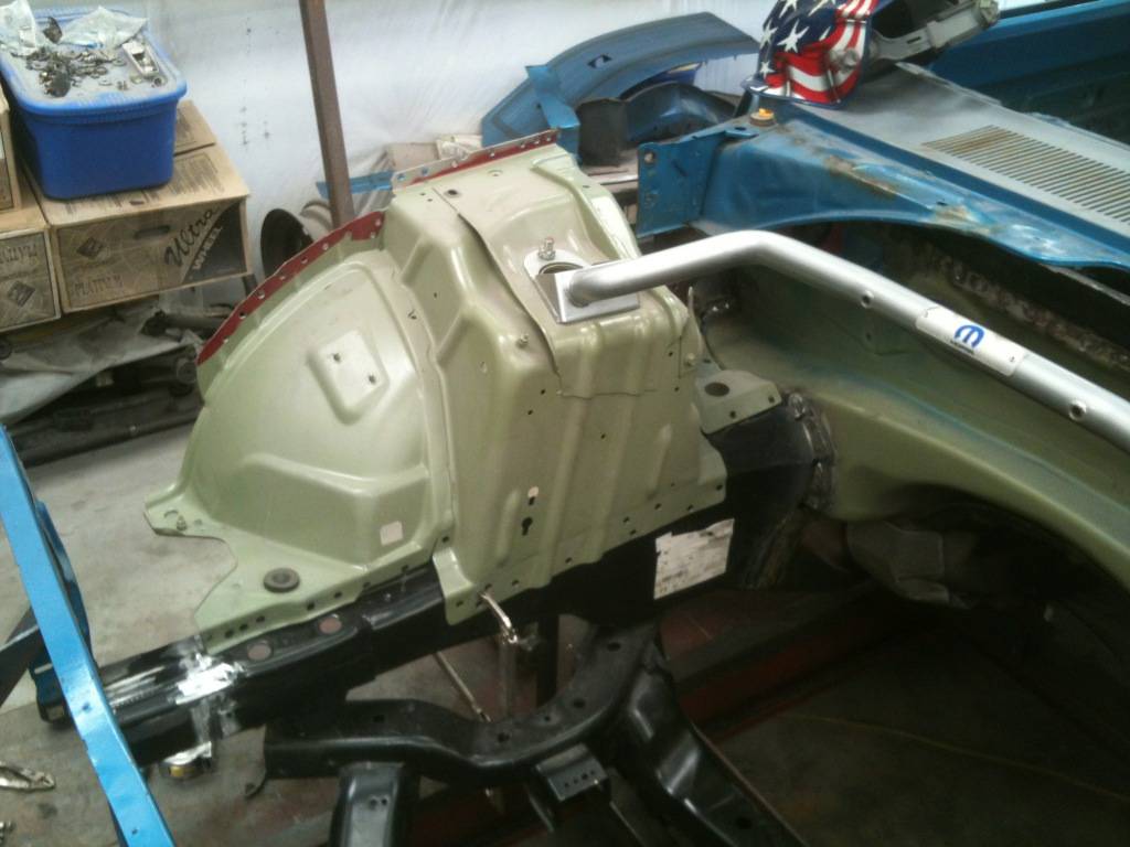

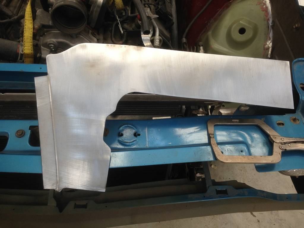

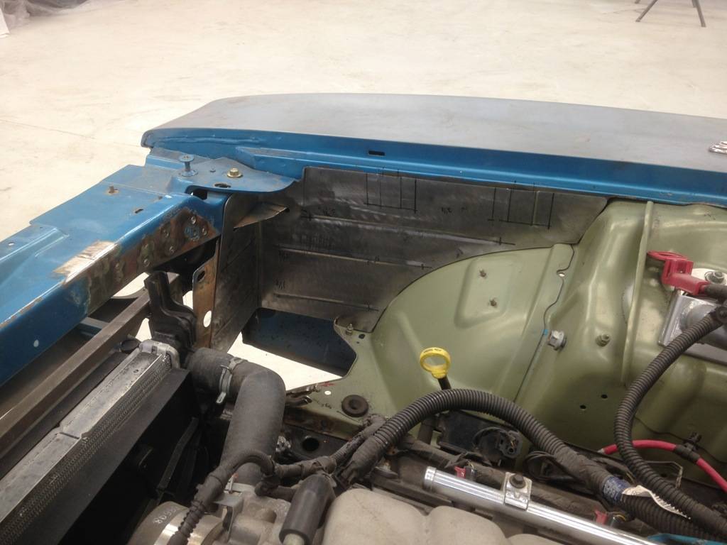

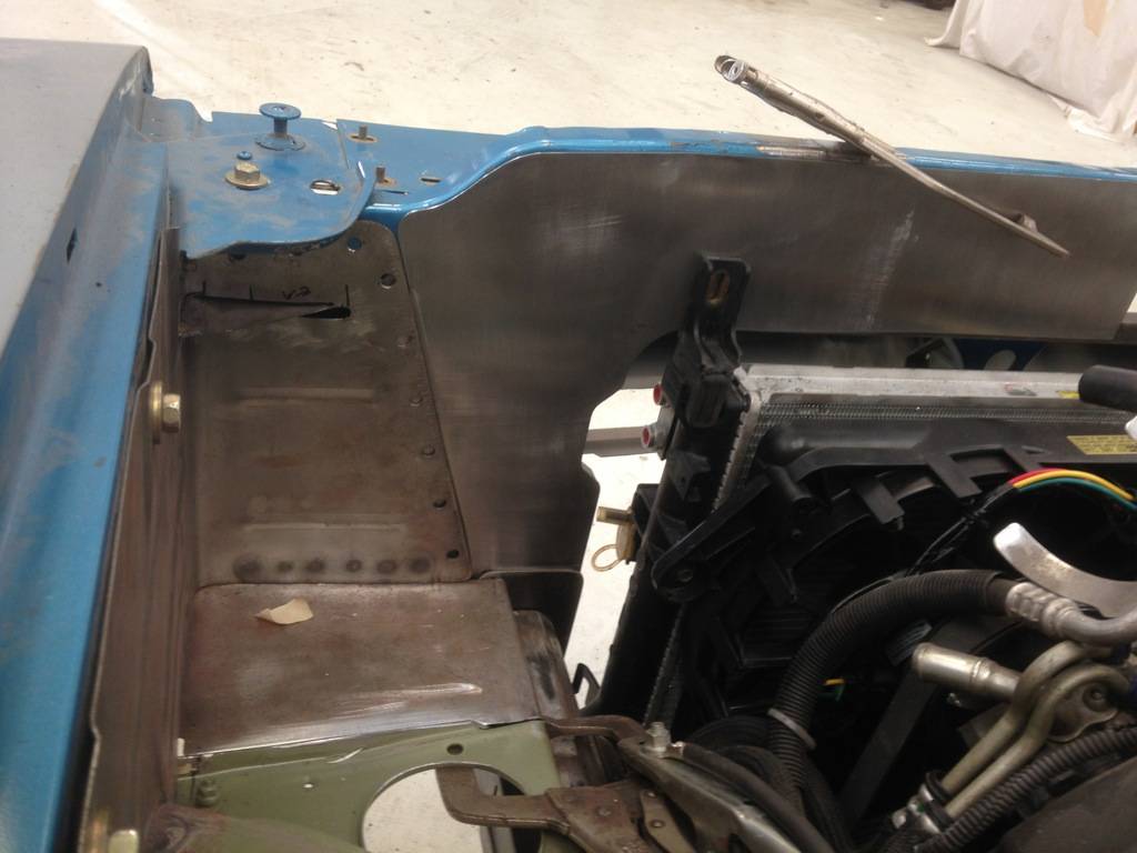

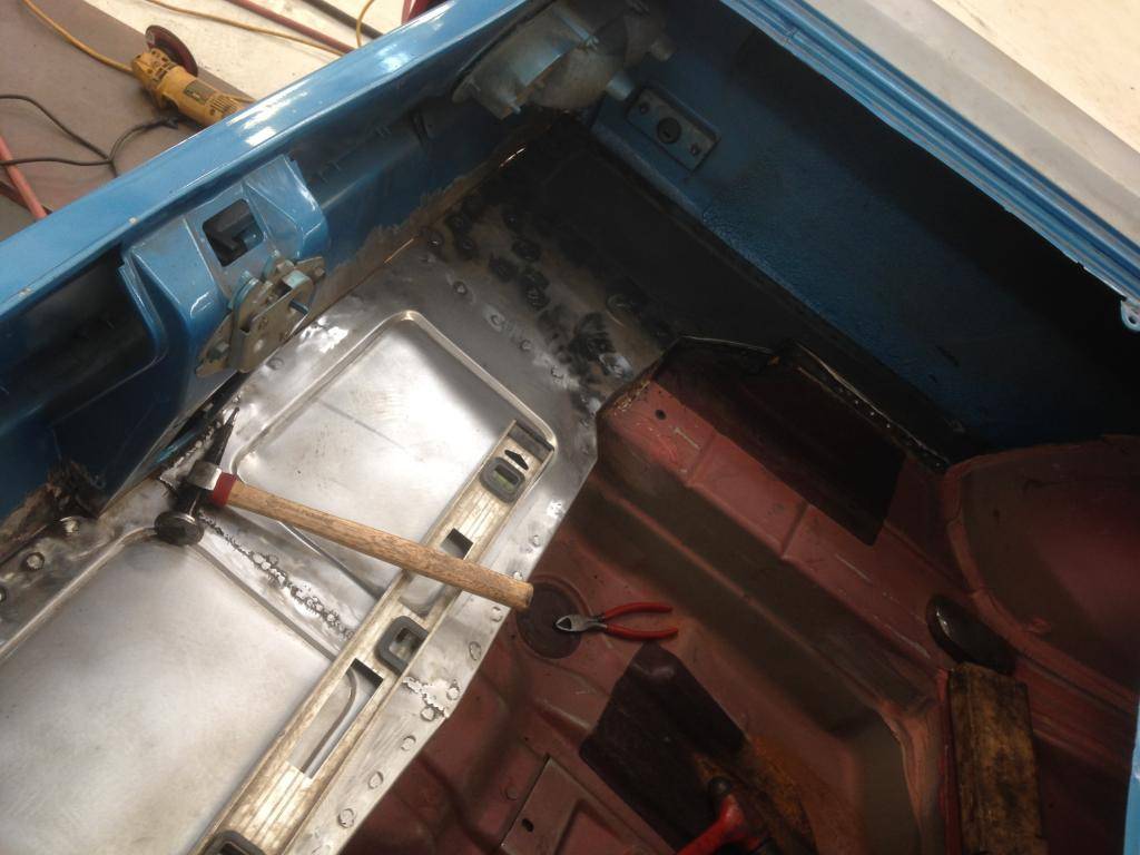

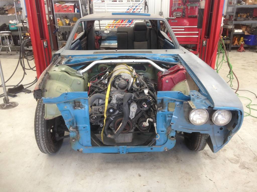

And working the front. Was trying to keep the original core support for a little old/new continuity, but in the end just wouldn't work. Did manage to use the top:

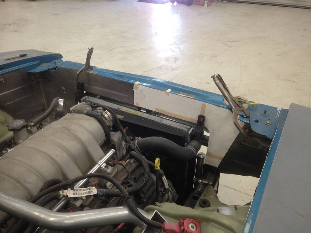

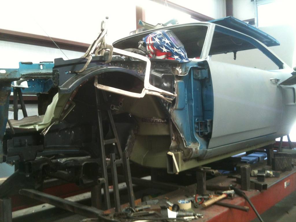

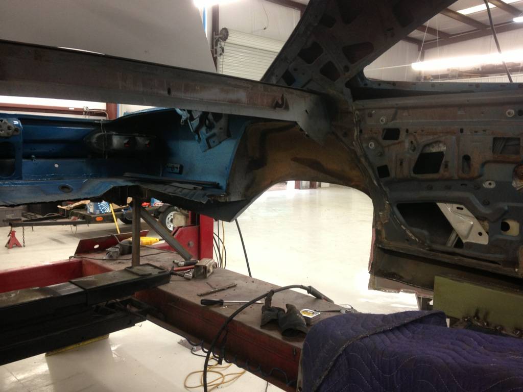

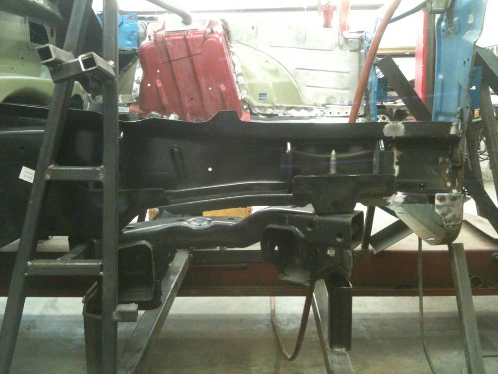

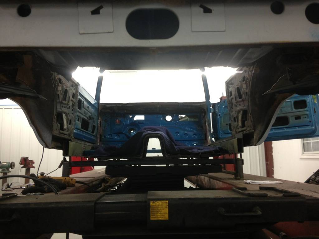

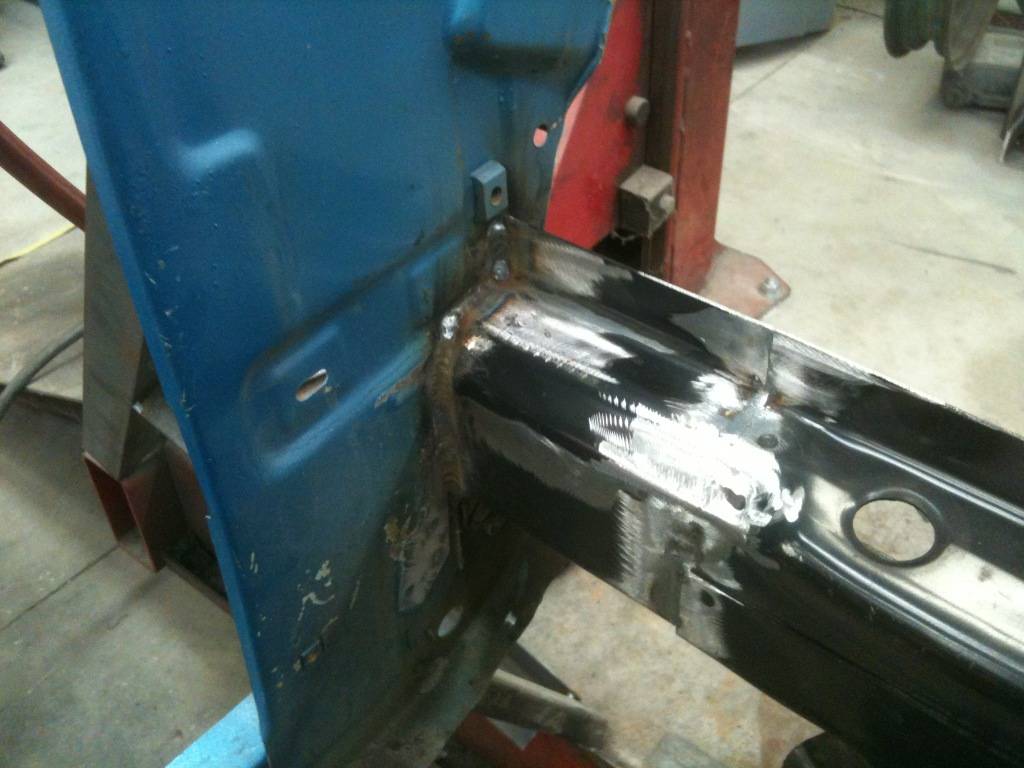

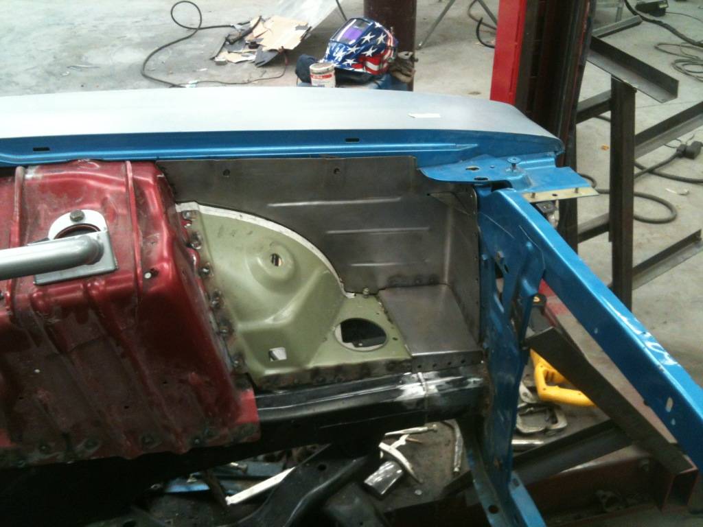

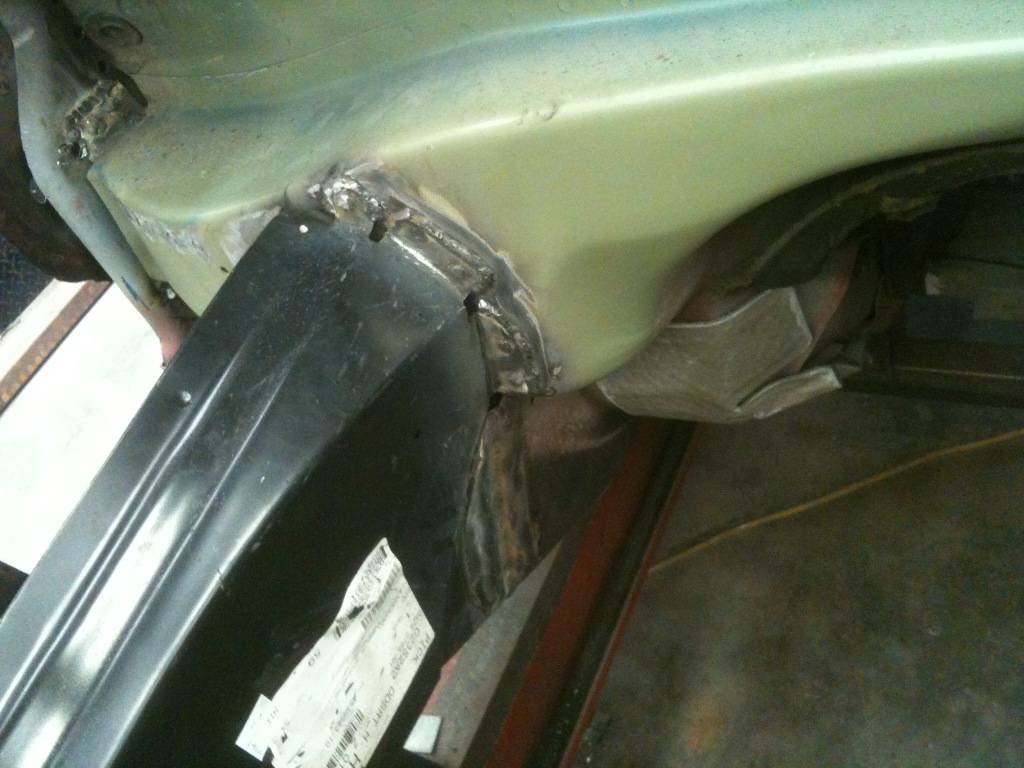

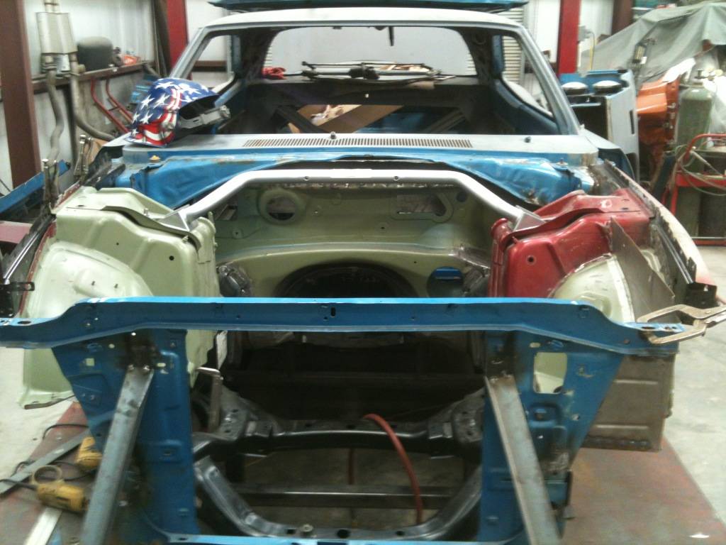

First order of business is to replace the front frame rails. Remember the frame shop got them in the correct position, but they are pretty mangled. Couldn't replace until I had the structure in the jig:

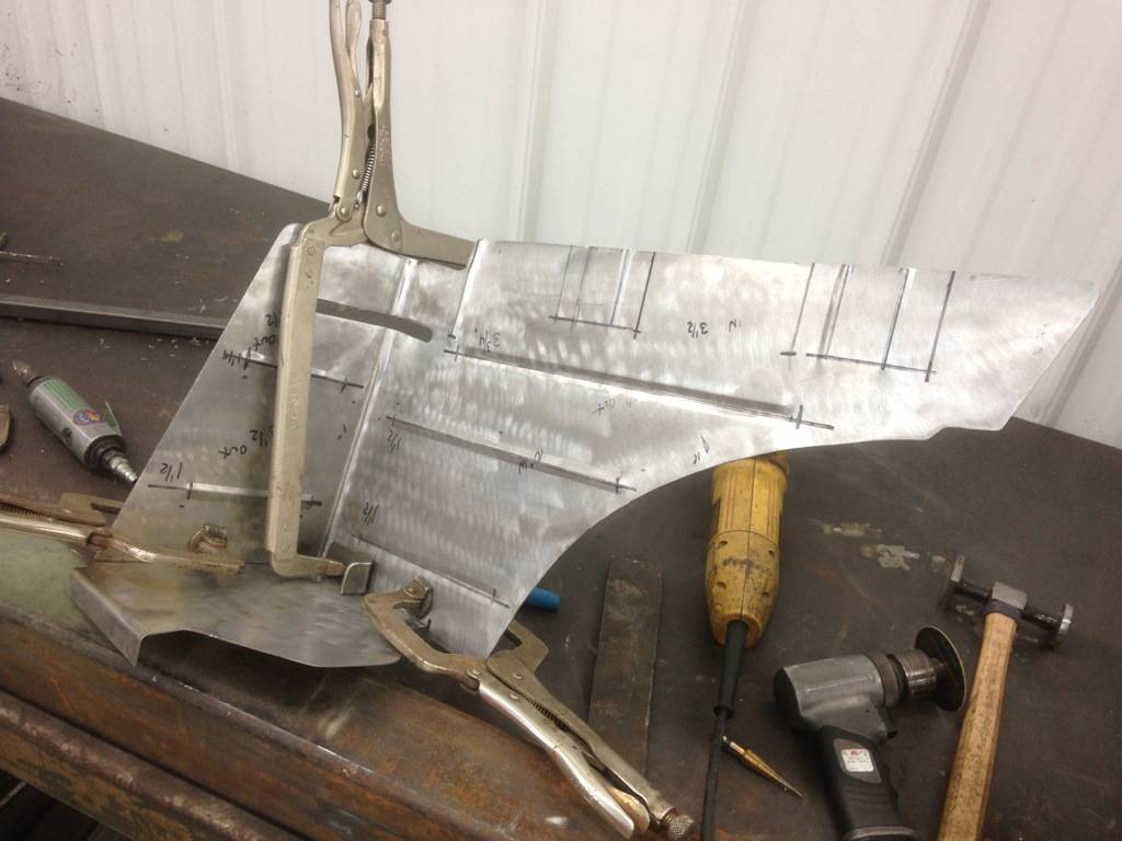

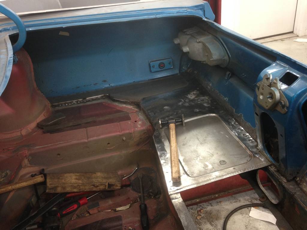

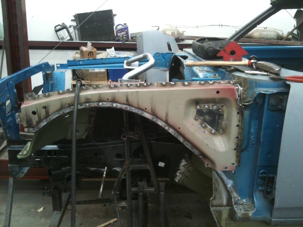

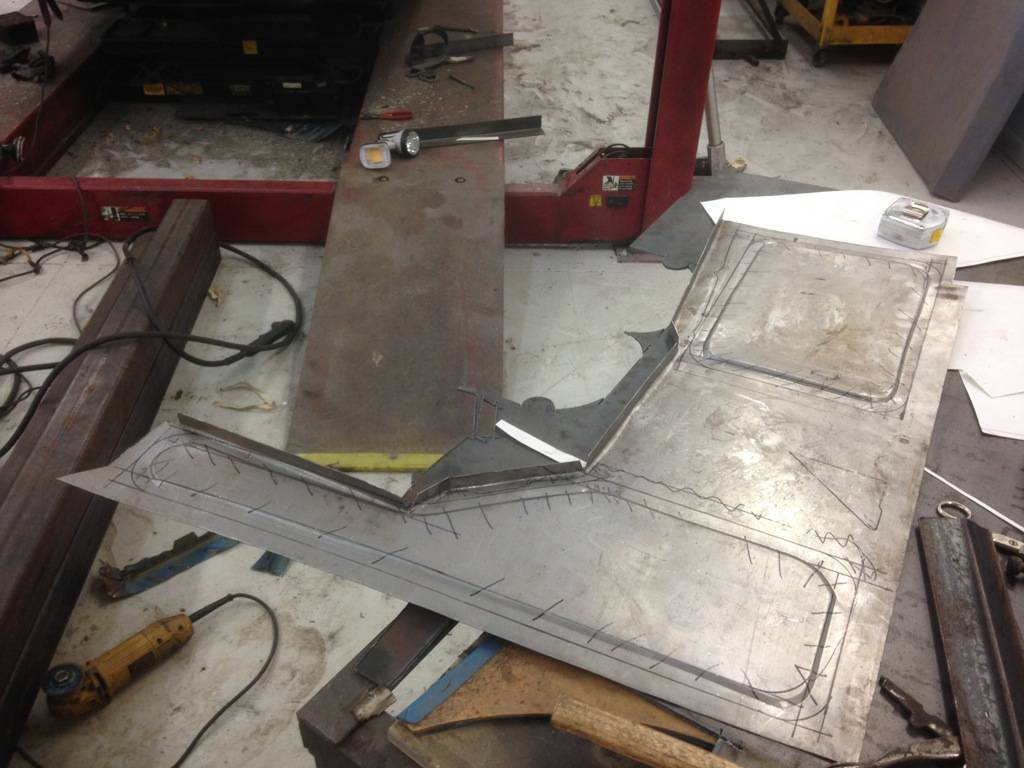

And make a place for the fenders to mount and closeout:

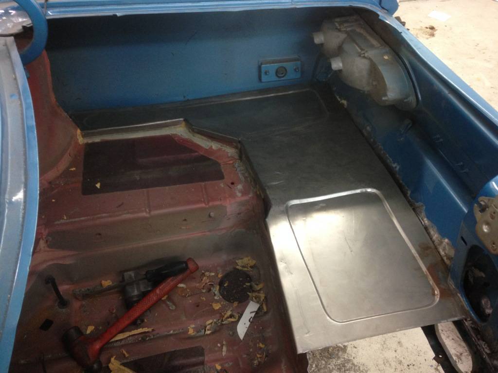

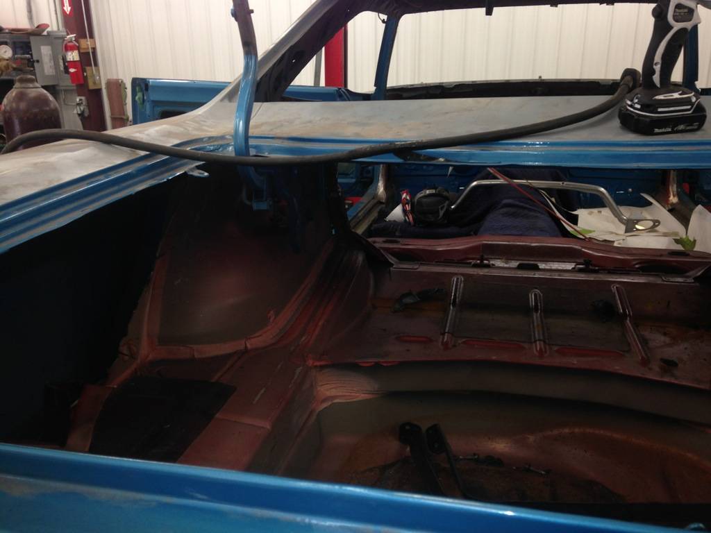

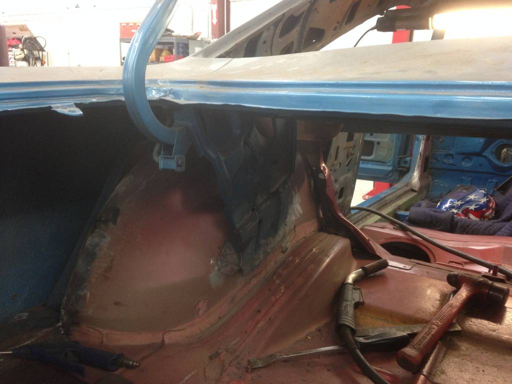

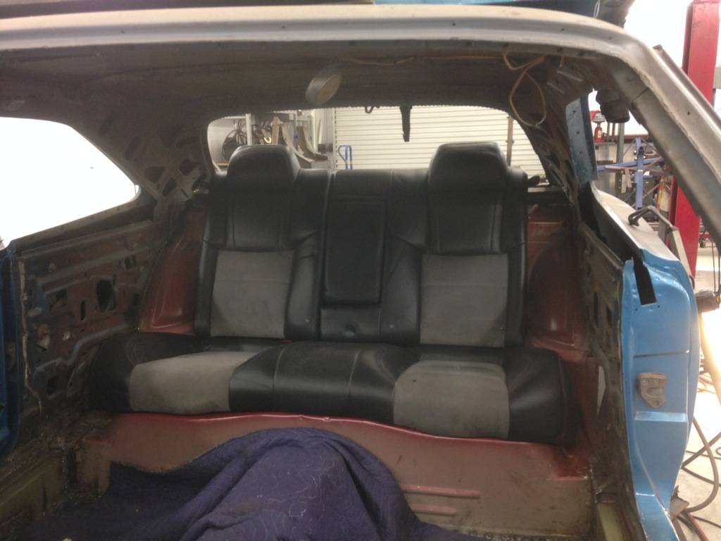

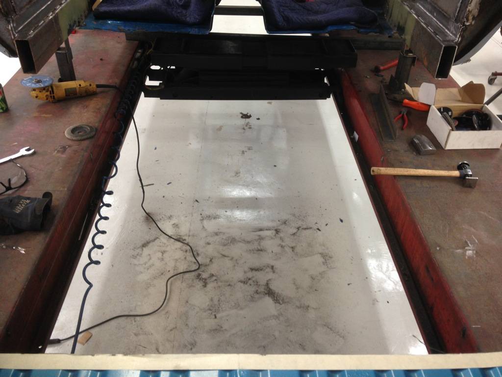

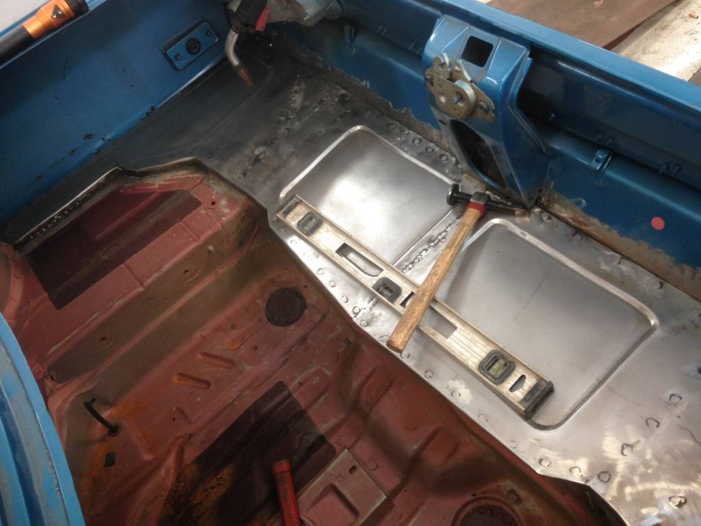

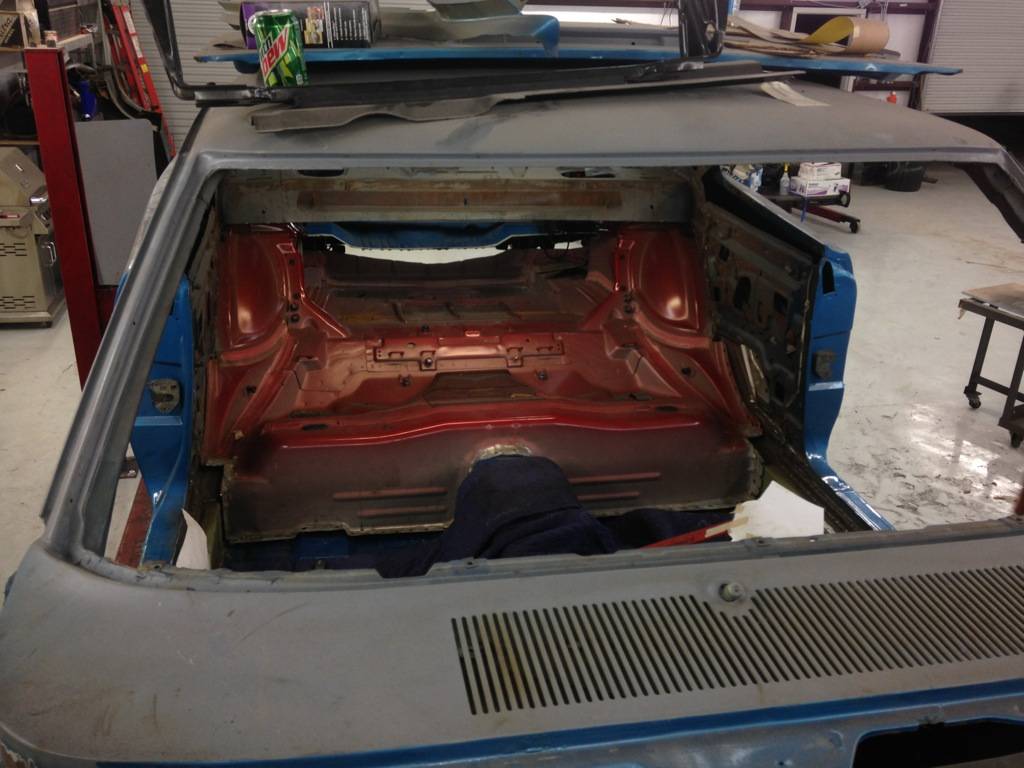

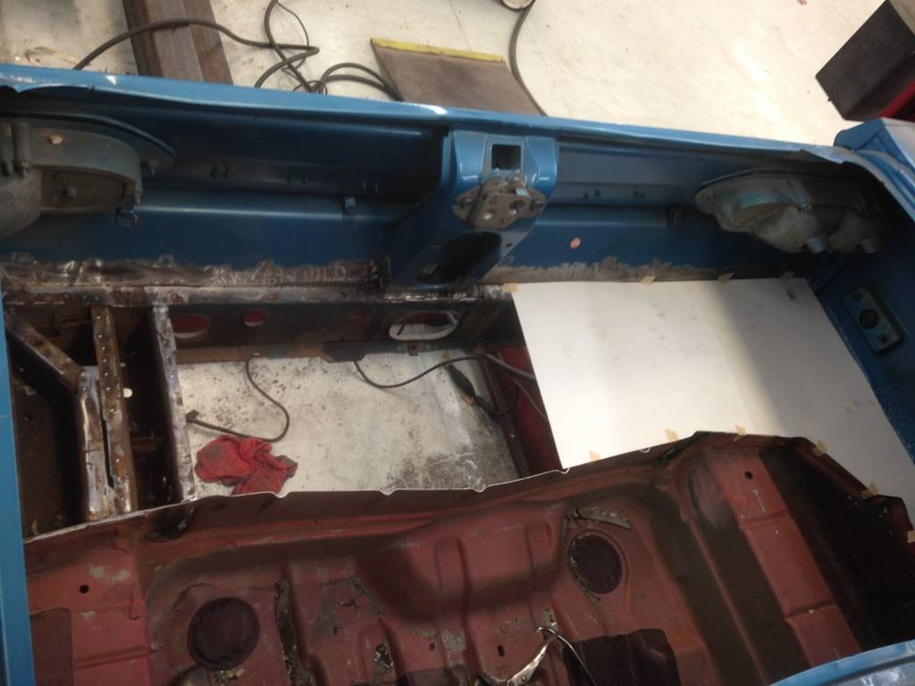

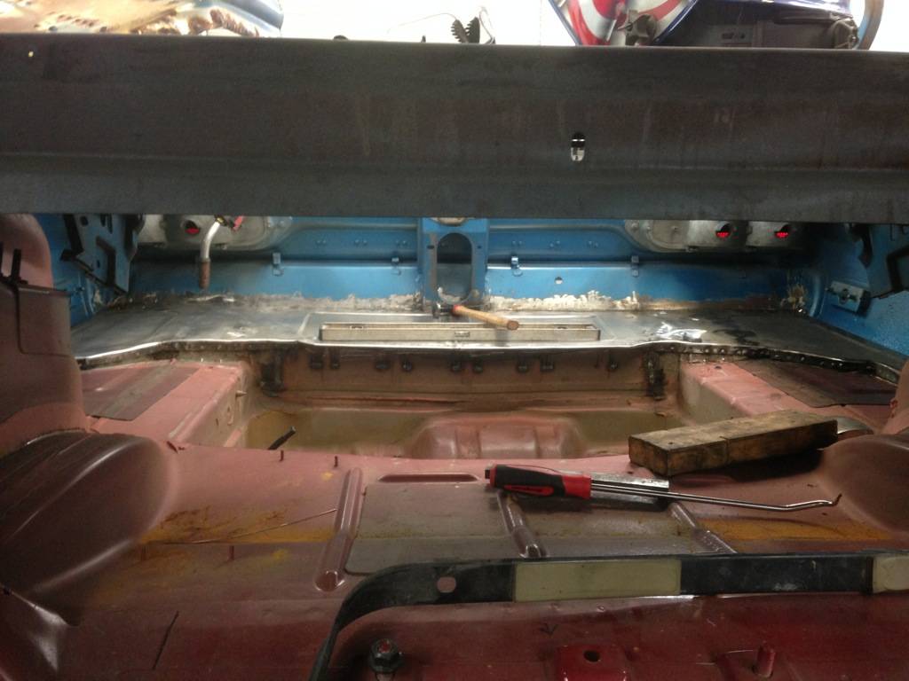

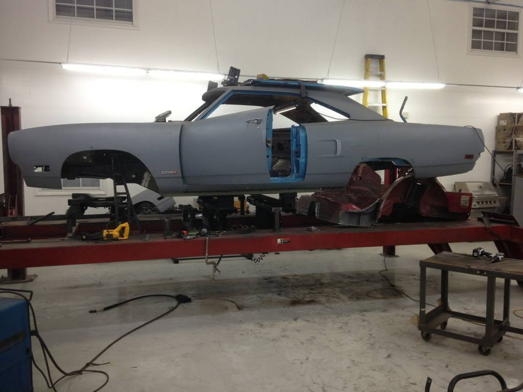

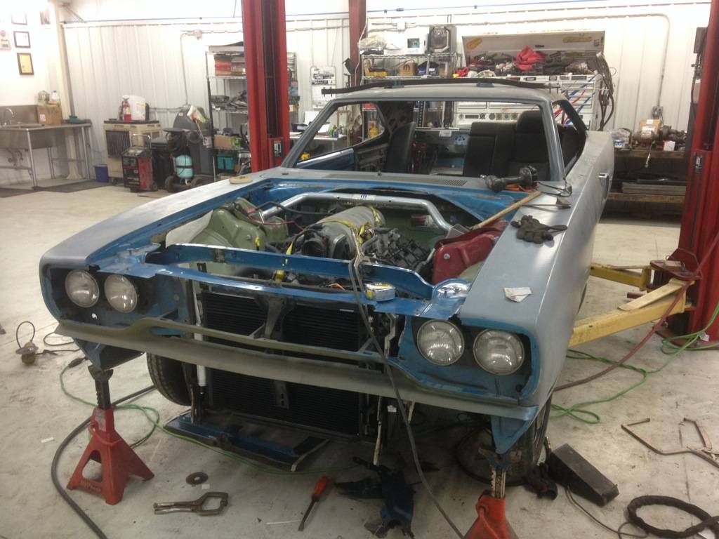

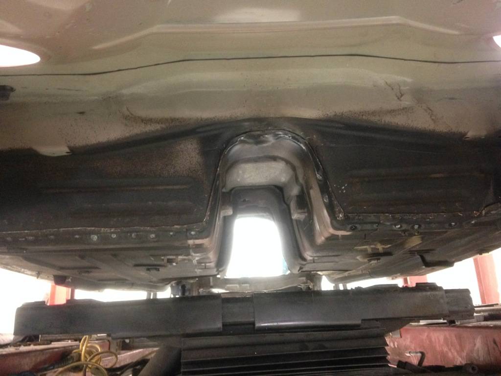

Time to put the back in:
Excellent fab work
