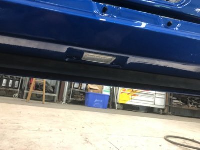

One thing to note on the doors. I am using the factory harness from the SRT throughout the entire car. The high line cars use door modules and the switches are low current signals. The door modules cannot drive a conventional window motor without built in Hall effect sensors. After comparing the wiring diagrams between a base and premium car, i was able to use the base door harness and switches so everything works. This eliminates the door modules and the switches become switched power. It did require pinning in the two base wires. For some reason, only the base door harness has puddle lights. I thought it would be a nice touch and cut the bottom of the door to install.

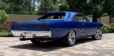

Still debating rear exhaust tip placement. Haven't adjusted bumper yet, so it's still crooked making tips look crooked. Opinions welcome.
Just my opinion, but I would think they would look good if they were right up to and in line with the bumper. How tight to the bumper can you tuck them?
Oh, and they're crooked.... :lol:
Indeed, closer to the bumper. Or remove te reverse lights and use these holes... ;)

Yeah I agree with you, closer to the bumper, but that’s a lot of work! The pan is from the LX, and it’s not as easy as just moving them up!
