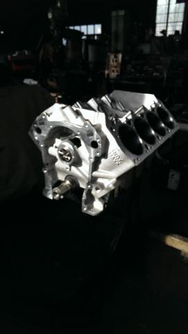

I'll get some pics up shortly. Indy Maxx Aluminum block 4.50 bore,standard deck height, bored and honed with TORQUE PLATES.
I'd like to know what you think of the indy Maxx Block, how much $ machining to finish it up to the point of assembly
So far it's my 2nd indy maxx block this year I bought.
If I were not under the gun I would have waited for a KB block but 8 months wasn't happening. I just finished a hemi build with a KB block and I really didn't see that much of a difference in quality.
I opted to get pushrod oiling which indy calls hydraulic oiling directly done from them as well as bushed lifter bores an the thicker sleeves. I went with a 4.490 rough bore and my engine shop finished it with a torque plate and line honed.
Total price from Indy delivered was $5700.00

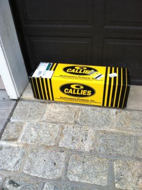

4.75 Callies crank is all balanced and the assembly starts tomorrow.
looks like 24"-36" of snow and 65 mph inds. So hopefully it'll get started.
nice new Magnum Crank.

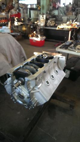

Bottom end is just about done.
Aluminum block is 185 lbs. lighter than my mega block. The blue Plymouth should wheelie like a mofo now even more with the frontend even lighter now.

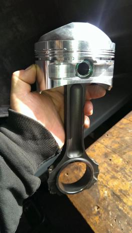

Went with Oliver rods this go around. They didn't way much more than my GRP and my MGP rods.
