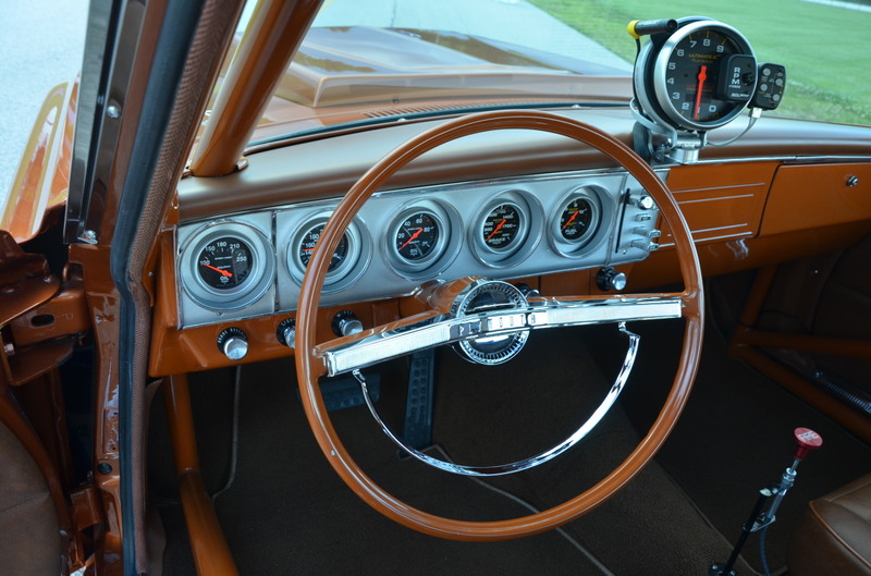

That plus the fact I am still running with the stock steering wheel. Don't know if I can fit between the cage and steering wheel. My steering wheel isn't removable. It's only about $400.00 more to add on too.
Got to have it

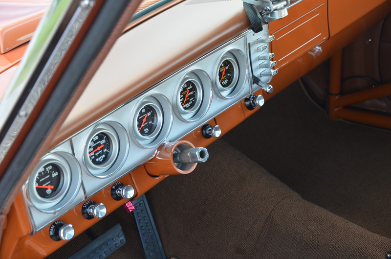

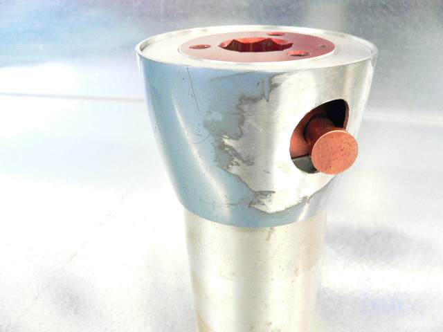

Your telling me that your steering wheel is removable between rounds?
Not between rounds, when I get in and out of the car, lol. It comes off with a push of the button.

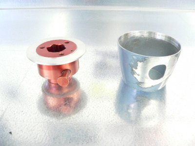

Care to share who makes that trick piece?. That's the hot ticket right there.

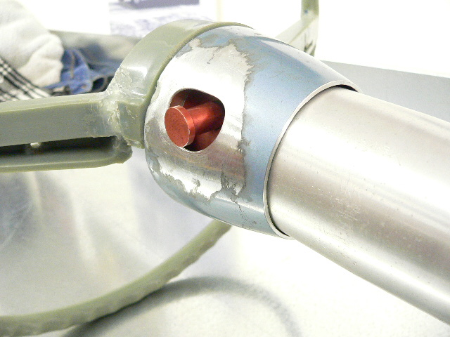

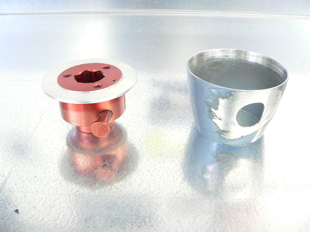

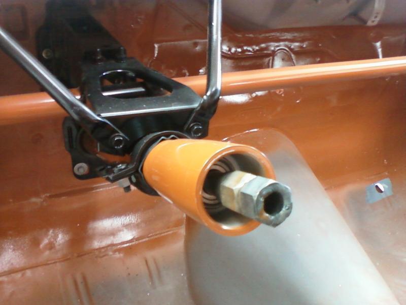

DVW What's that trick setup costing? I could use one in my 65 AWB

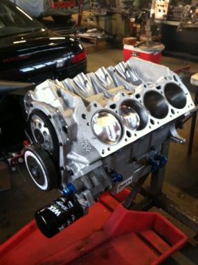

more done to the hemi today. hemi heads will be gone through tomorrow, installing new crower roller lifters
more
The shift bowl is stock with the guts removed. The Three on the tree nub was cut off and the remaining hole opened for button access. Hub is $32 at Summit.
http://www.summitracing.com/parts/lng-56600?seid=srese1&gclid=CNGU6Pmt28MCFfLm7Aod7DQAKg
Inner hex welded to the shaft. I swapped the stock shaft to .083"x.750" moly tube to reduce weight. Machined a step on the hub face for a flat circular plate.That plate was welded to hub. Bowl was then epoxied to the flat washer as it's only decorative. Drill holes through the wheel and bolt it to the hub.
Doug

bushed lifter bores done.
jesel belt drive installed
milodon oiling system is on
