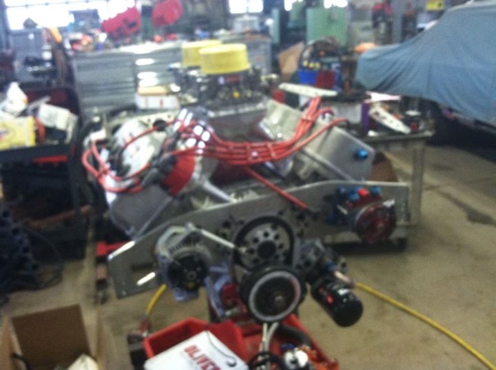

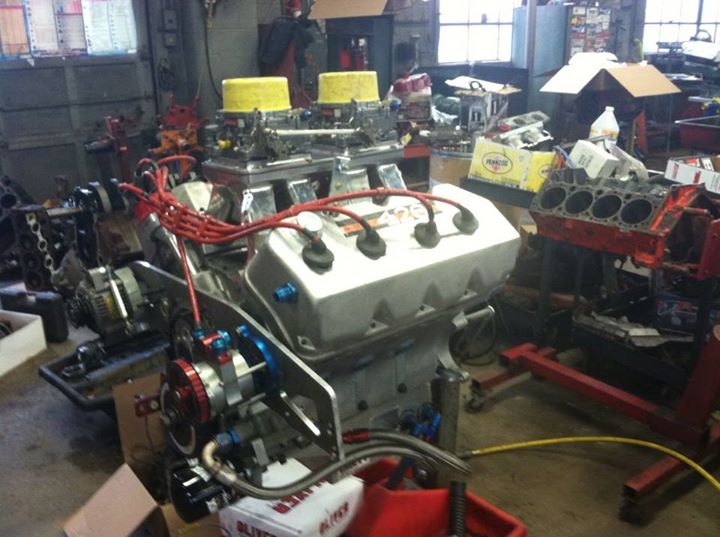

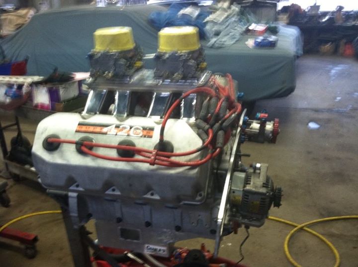

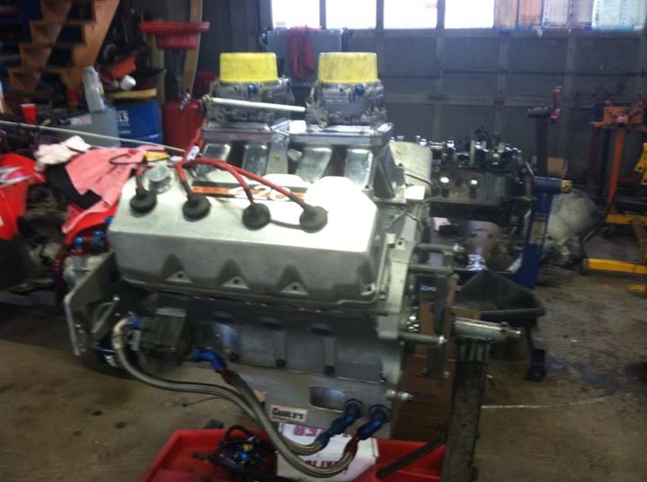

Here's the finished product, going on the run stand today and will be running on Friday. New Aluminum Indy block,pistons, rods, lifters, rocker shafts,cam, and 4 new valves.

Looks nice
can't wait for the videos

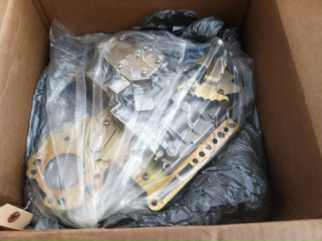

Then the new free neutral valvebody goes in to compliment the new PPP Shifter.

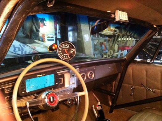

Drivers seat is in, all wiring done with added grounds, PPP shifter cable in and all the ARC switch panel switches functioning properly.
Racepak dash all installed as well.

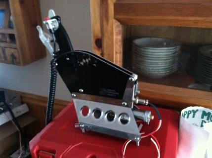

That shifter sounds like the right shifter for a lot of us to have. Where did you get yours from?
PPP Proflite, but you'll need the correct valve body to make it work properly. it has a neutral after 3rd gear.
I opted for the non transbrake version with only 1 neutral after 3rd instead of the neutral after park and hit the button to go in reverse.

Motor is done and put on the run stand yesterday, fired up without a hitch. Going up tomorrow to readjust the valves, pull it off the run stand and make some time to get the 65 Plymouth up there for the motor install and to install the new A & A free neutral valvebody.
Not sure if I want to run it with my existing turbo action 8" converter or try the new A1 8" converter that stalls at 6000 rpm.
