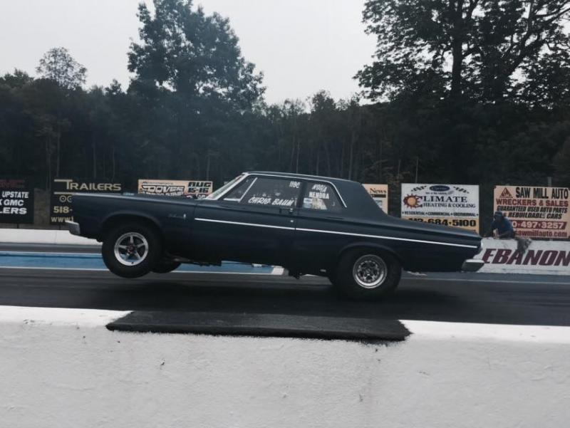

From yesterday. Bringing the wheelies down a little and gaining ET and MPH. 60 foot is much better too.And still looks presentable.

Pulled off oil pan today, swinging pickup was stuck in the back position. Last wheelstand sealed the deal. Had to bang down the oil pan floor so the pickup swings freely. Readjusted ladder bars, and changed the oil to Brad Penn 10W-30

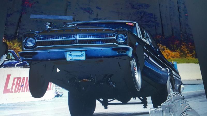

1st was a 9.14@148.78 with a crazy high wheelie for a long ways.This was with 1 click on the front shocks
9.02@149.06 with 2 clicks tighter on the front shocks which equated to tire spin. Don't know why wit only 2 more clicks its spins and not hooks like it does whith 1 click on extention.
Funny thing mine works better the tighter we get it. I have your old Afco's 6 away from full tight. Video the rear tires and see when it spins. We've done extensive video the last 2 months. If it's spinning right at the hit it may need a rear adjustment. Believe it or not my front and rear rebound were too loose and we're up to 14psi. Last pass was only 1/8. 1.26/3.68/5.74@119.3

I don't know my car anymore since I added 65 hp. and taking over 100 pounds off the nose.
I put 2 clicks in the front and back to stop the tire spin and this happens.
