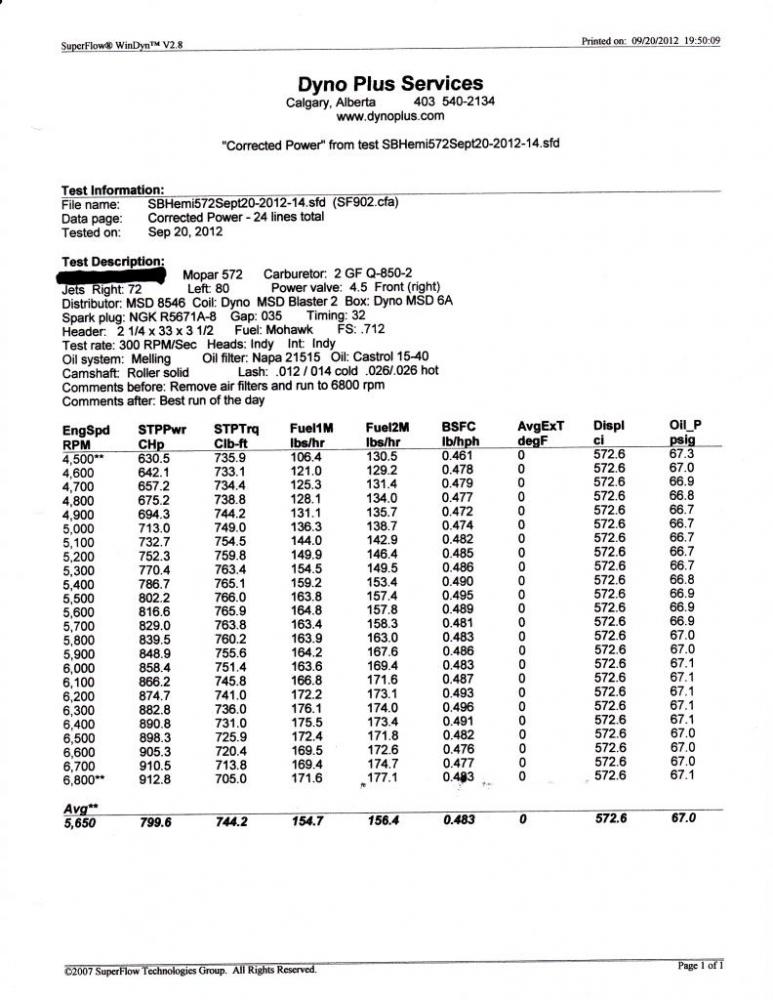

here's one
572
KB Water Block
Stage V(std valve Angles)
.616"/.640" Roller Cam(very easy on parts as the customer is a Street guy))
91 Octane pump gas..... and NO... we did not push the detonation range, it is very safe.
Already has 2 seasons and 8,000 miles on the Street.
We got it up past 925hp on the 2nd Day, sry, can't find those 2nd day sheets ?
We've done others(same pump gas builds) with Cast Iron Blocks.... which were good for 955hp, just seem to make better power than the Aluminum versions... albeit alot HEAVIER !
975 hp should be a great ride !

here's one
572
KB Water Block

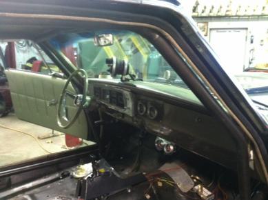

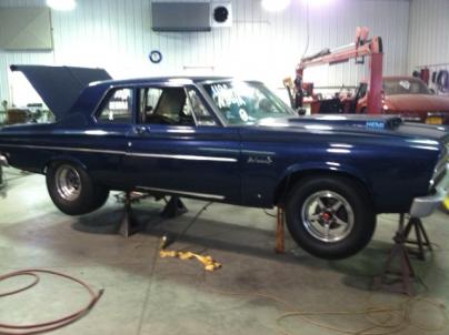

Well, C & F Racecars is transforming my car perfectly.
more pics.

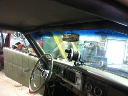

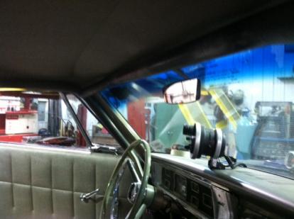

it's a no go on the funny car cage, I wont be able to sneak between the NON Removeable steering wheel and the funny car cage.

That will save you some weight.

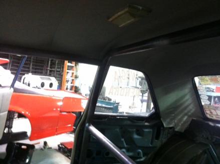

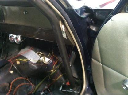

so are they going to do a dash bar &
full over head continuous hoop a cross bars &
down bars in the front thru or next to the dash
what kind of cage are they building or adding ??
why not add a removable wheel that's easy peasy deal ??
or are you trying not to alter the car much in that aspect ??
just curious
no

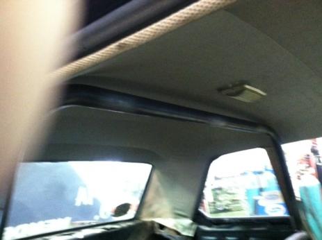

moly cage with bar across the upper window
because my original wheel is mint and that's not an option
yes
just curious
i know

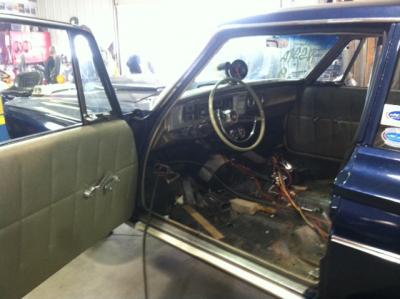

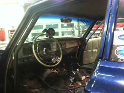

Looks like it will be done by the weekend. 1 week start to finish.

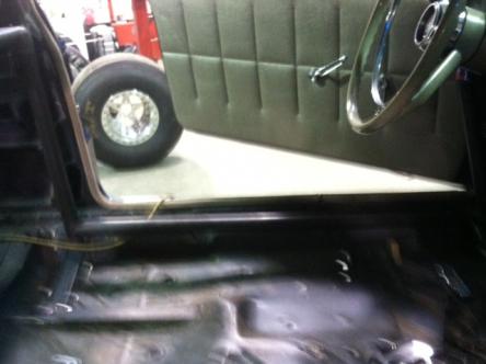

We tried to fit me for the funny car cage and it is virtually impossible for me to get in and out of it.

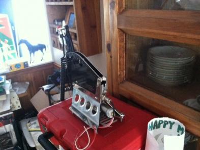

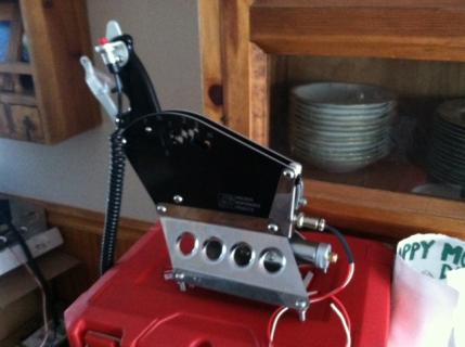

Bringing up the new PPP shifter with free neutral to get mounted up. I made the bracket for it .This is the best time to install it.

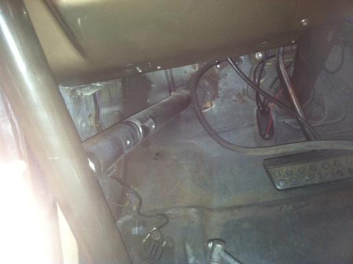

Just made up the floor bracket for the shifter
All attached and just need to get up to the chassis shop to make the legs and floor mount. Easier to do it now with carpet and interior out

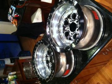

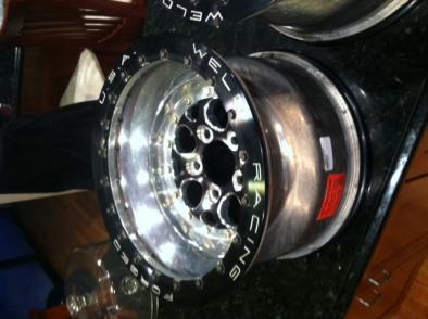

Christmas again in February. These should look awesome. I have a set of Alumastar centers if I want to change them out.
