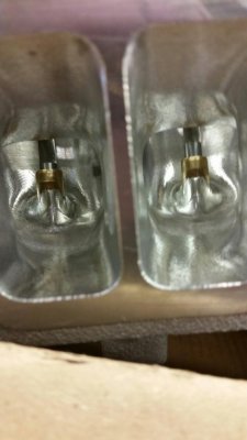

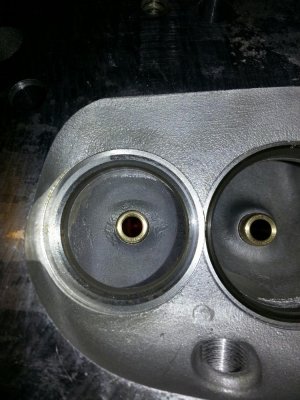

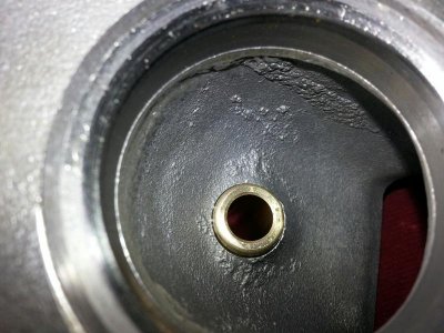

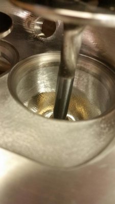

many will knock the point of origin, but my machinist specialies in Jap. imports, but is old school domestic and heart, says the MANY replacement heads he sells come from the same foundries as the Stealth heads and they are real good for the money, i purchased mine bare in November of last year for 450$ each, then took advantage of the Hughes engines 50% off CNC porting special they offered last year, i dropped them off at my local guy last week for a close inspection and final decking and prep. all in all, i think you should always optimize the air pump.
