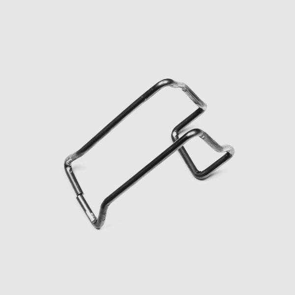

James should have mentioned this cool item for the '66 and newer couplers.
https://www.detroitmuscletechnologi...steering-column-coupler-cover-clamp-retainer/
