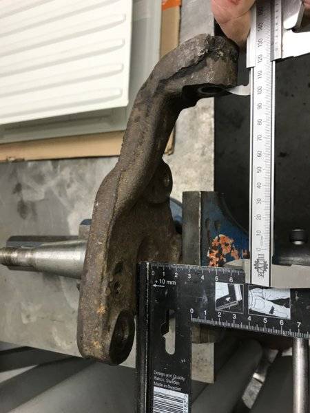

Am I having the right type of knuckles?

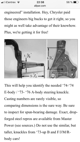

When I read the Disc-o-tech it says the ”right” type of knuckles have a height of 4-9/16. It’s a little bit difficult to measure but I get mine to be 4-7/8. Do I have the -73 and up b-body knuckles?

So, you mean I should use the knuckles that I have? The disc-o-tech article is stating, with exclamation mark, that these should not be used.

The man that wrote the "Disc-O-Tech" article is a smart man but he was just plain wrong in his condemnation of the later model steering knuckles. His contention was that the taller knuckle would result in excessive angles of the upper ball joint leading to failure. THis has been proven wrong by many other sources.

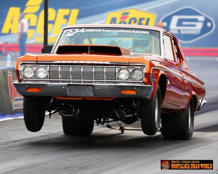

As stated above, used plenty of the tall spindles for conversions. My back ground? I was a suspension tech for over 30 years. Probably done 5000+ alignments. Plenty of repeat business. Never had an issue. The "over center" concern is from someone who never looked at the actual amount of travel. Same with the geometry. There's nothing critical there either. I'm sure you seen plenty of cars in a wheel stand with the wheels all angled in at the top. Take a look at the two pictures. One car has tall knuckles, one doesn't. Can you tell which is which? The camber curve looks good in compression as well.
Doug
