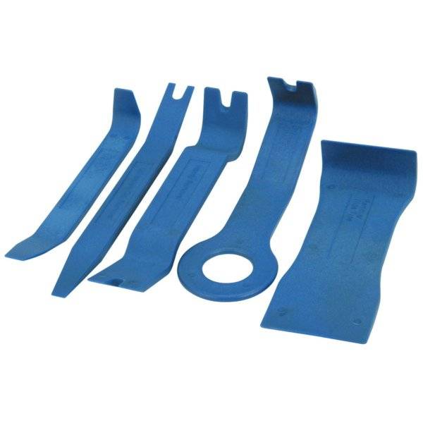

For the rail removal I would carefully apply heat and carefully use one of these trim tools to separate/lift it. Harbor Freight has these trim tools. Patience is a virtue. Don't rush and don't force anything.
Thank You DeltaV. I do in fact have 2 or 3 of those trim tools and a heat gun. I will give it a shot tomorrow and report back. They probably have that 3M stuff at my local Napa or Advance Auto! I hate this cold windy weather. I just had a new roof put on my house yesterday with O.A. Temps just under 30 and winds gusting over 40 mph. Even though they picked up most, there is residual debris in every direction around my house.
