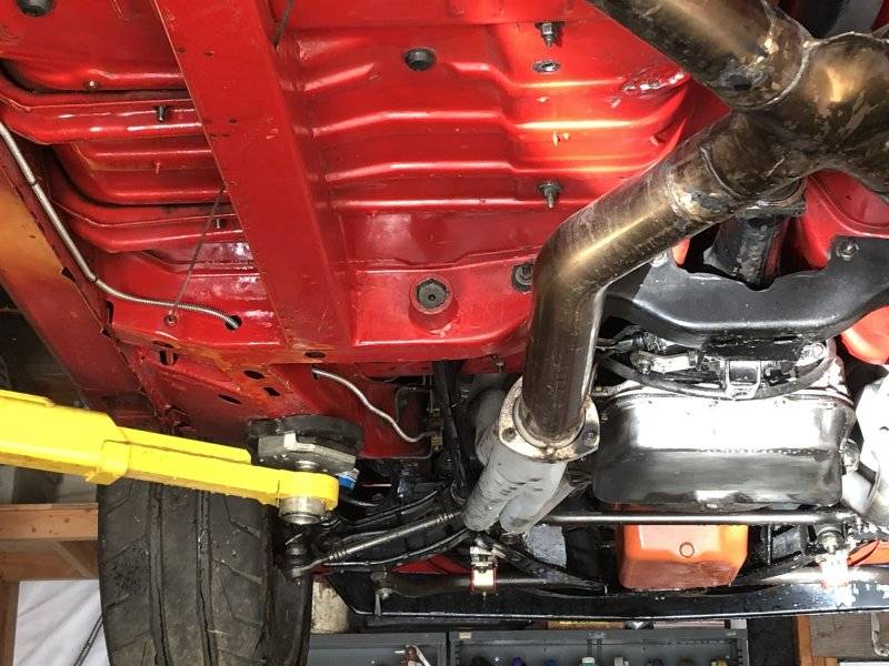

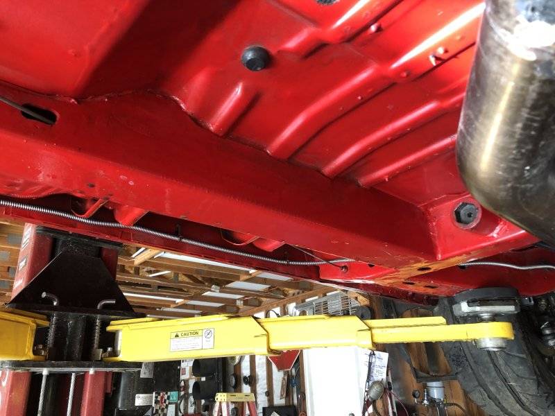

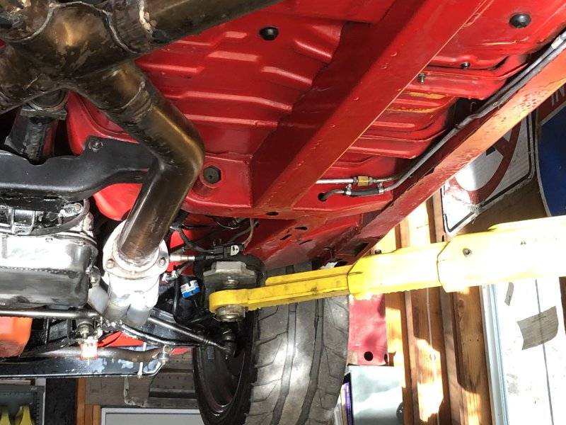

Looking seriously nice, Dennis. Do all 4 wheels have to be on the ground when those get welded in?USCartool connectors here. Fifteen years and many miles. No damage discovered. Lots of hard miles. Has rigidity more like a modern car. One of the best upgrades ever.
They seem to have the most comprehensive kit. i wish it was bolt in so I could do it myself, but of course it wouldn’t be as rigid then.USCartool connectors here. Fifteen years and many miles. No damage discovered. Lots of hard miles. Has rigidity more like a modern car. One of the best upgrades ever.
Any bolt ins that you would recommend?My 540HP Hemi RR coupe (no subframe ties) would visibly twist when hammered, but not enough to show any cracks; without the Hemi-specific chassis gussets, it likely would have shown cracks. Typically they develop at the cowl & quarter/jamb area, from cars I've seen.
Only ran DOT cheater slicks a couple times; on Radial T/As, yup, it would just buzz them until 3rd gear.
I ran bolt-in ties an a Nova and 2nd-gen Camaro, and although not optimal, they definitely strengthened those cars: I could feel the difference.
If you plan on slicks and really launching the car, I'd definitely add ties at a minimum.
Wow, you did a great job on those!I took 3 x 3 .120 wall tubing and made my own.
Mine were welded to the torsion bar crossmember and to the rear rails.
I made my own torque boxes from 14 gauge sheet metal.
Again, mine are not welded to the floor pan but I did put seam sealer at the edges to fill the gaps.
The car instantly felt more solid. It soaked up bumps and dips like a newer car.
