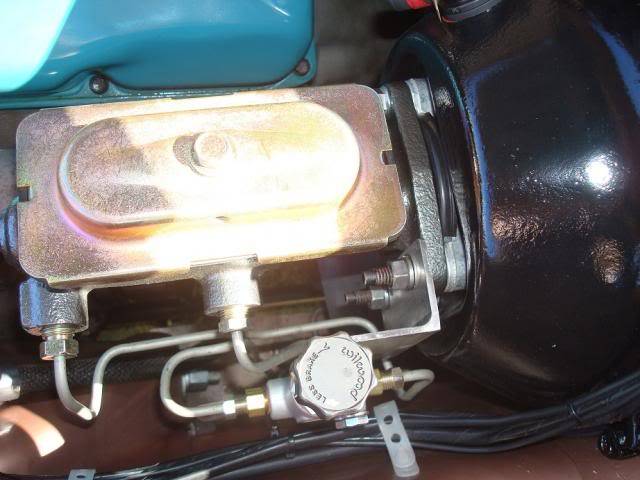

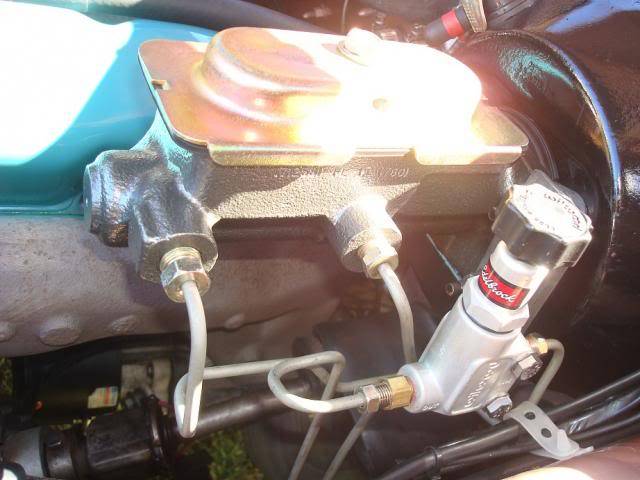

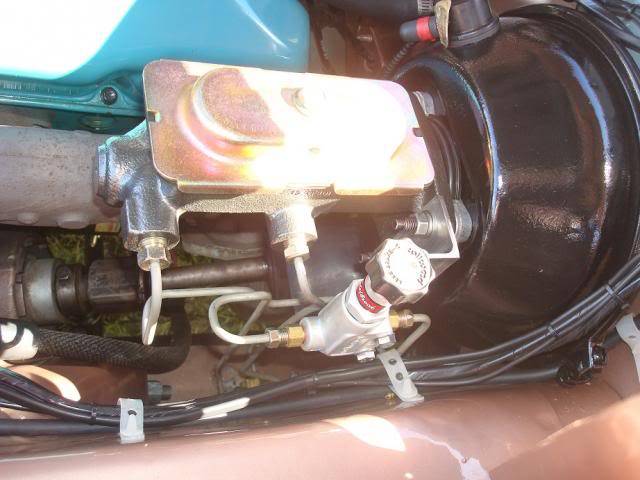

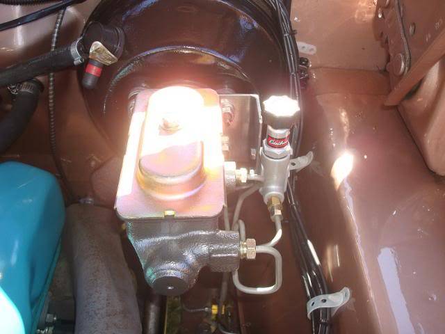

Here's a few snaps of the job done just last week;
Sorry about the glare...it's just so darn hot and sunny here :headbang: This is running original drums on all 4, and pulls the car up much better than the single pot master. I will start a new thread for MowPar so as not to hijack here. Hope the pics help someone.
