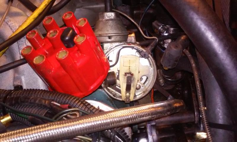

Can't hurt to recheck. Ok think we had it on exhaust stroke. Now, it is def on the compression stroke, plenty of pressure on my finger. However now dist rotor is pointed downward at No.2 cylinder. Don't think that's a good thing, lol.

That doesn't mean your on the compression stroke.
We cranked the engine with a finger on spark plug hole. The compression nearly blew finger out of the whole...and the mark on the harmonic balancer is at 0 on the timing tab (bumped the motor a tad to get it there). If this isnt compression stroke what is? The dist rotor wants to be pointed at No.1 cylinder I'm guessing.
I was responding to the post that you edited out. The one that says you stuck a wire in there and when it moved you thought you were on the compression stroke. If you want help, that's fine. If you want to edit post after someone has responded, don't expect any help. If your sure your on the comp stroke, put a mark on distributor housing that says this is # 1 and line your rotor with that. Now drop the distributor back in place.. When starting, leave distributor bolt just snug enough to move distributor. More than likely it will have to be advanced(turn clockwise) Have someone turn the key while you make the adjustment from the front. Add a small amount of fuel to carb before turning.
