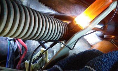

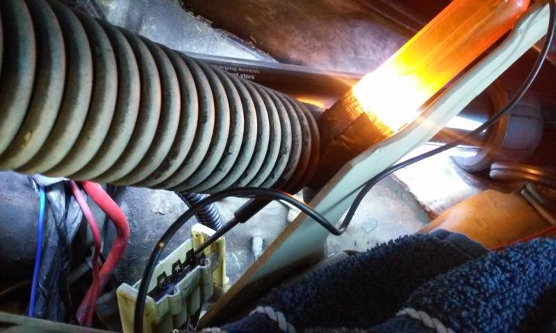

So I think Murphy Law stopped by here. I was replacing a gauge this morning...I reconnected the batt, opened the door..no buzzer, no interior lights (keys in ignition). Maybe batt is dead? nope 12.65amps just sitting there. Still no lights or buzzer, AND no headlights or horn for that matter. Nuthin. I took a test light to the starter relay, its hot. I rigged a remote switch across it, pull the trigger, starter spins. STILL no power IN the car. Turning the key in the ignition switch produces nothing. I thought maybe there was an issue with the firewall connector. Checked that with test light, clean as a whistle, no problem there apparently...juice is getting into car, at least from the engine side of the connector. Check fuses, all is well. So why is the interior dark, and no horns or head/brake lights than? The fusible link can't be the problem or there would be no current from the batt to the relay. Now what? Maybe a problem with the ignition switch in the steering column? Could that cause everything to go dark?

Pwr IS in the bulkhead connector (the non switched circuit that is hot without the key). What I don't get is why its not getting to the interior/exterior lights..some where there's a short or disconnect? AND of course the key in the ignition does nothing.

check your ammeter gauge wire...odds are..
if not that check your bulkhead connectors like it looks like you are in the pic.
shouldnt be any green anywheres.

The ammeter is bypassed. Did the "MAD" conversion....using a voltmeter now. I kept hearing those horror stories about guys cars going up in flames because of all the current passing through the ammeter...so one saturday morning we got out there and retro;d it. It's driving my bananas. I have a spare ignition switch..but that wouldn't explain why no headlights (no key is needed to turn them on).

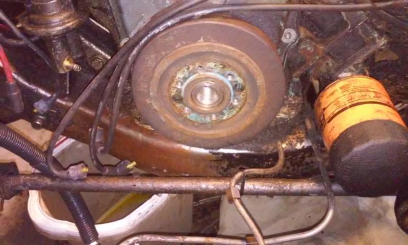

Hehehe....I can't comment on what happened then. I wasn't around during the "supercar" hey days (most sadly)...but I have seen pics of lines of cars at gas stations...Yeow!! THAT had to suck. Well, the impact driver is here.. FINALLY, lol. Trying to trace down this electrical gremlin first. If she won't start, then nothing else really matters. So far I've traced the heavy red wire from the fuse box up into the steering column. Its hot all the way up. So maybe there is a worn ignition switch in there?..I mean that's all that is left. Just lobbing guess until I can get the steering wheel off.

bad news...still trying to figure out what the hell is going on with the interior/exterior lights. There's juice all the way up to the Ignition switch in the column. So trying to figure that out also....ARRRGh!

I got to ask, did I read a few pages back were you had pulled the starter ?
did the battery wire get hooked back up ?
I know sometimes I overlook the chit like that ( :
