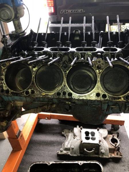

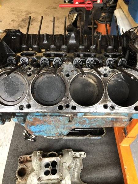

Tell me about my 360...

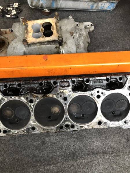

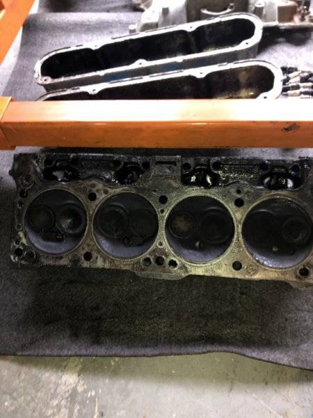

Well, heads are off...
Left side:
Right side had a bunch of coolant in the cylinders but I’m thinking it’s from the pressure washer.
Right side:

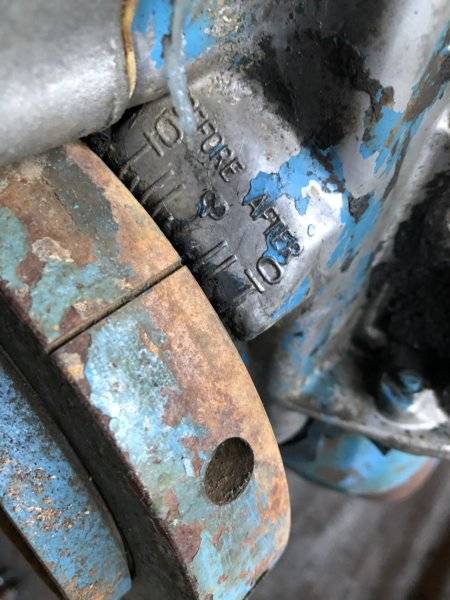

Is there any way to tell what can is in my motor? I noticed that it’s been degreed. Not sure if that would be stock or not.
we don't know if your cam is stock or what
you could measure the lift (lobe height - base circle)
that water most likely was when you pulled the heads
IDK what the picture is supposed to show

The picture is just showing my lack of knowledge With the motor at TDC, I assumed a Factory cam would be degreed at 0.
