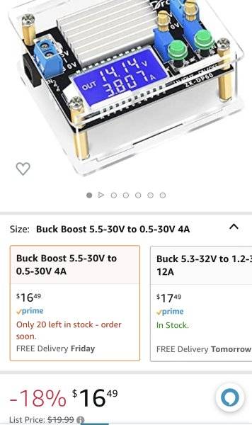

I used 12v to check all the lights and used a variable dc lower supply to check gauge response. Someone on here had a video of their setup. I used something similar. Check my resto thread. I think I posted which power supply I used.
If you don’t have a sending unit laying around…a simple variable power supply and a battery does the trick. Set the power supply to less than 5 volts to protect your gauges and then sweep the voltage down to test gauge response.
