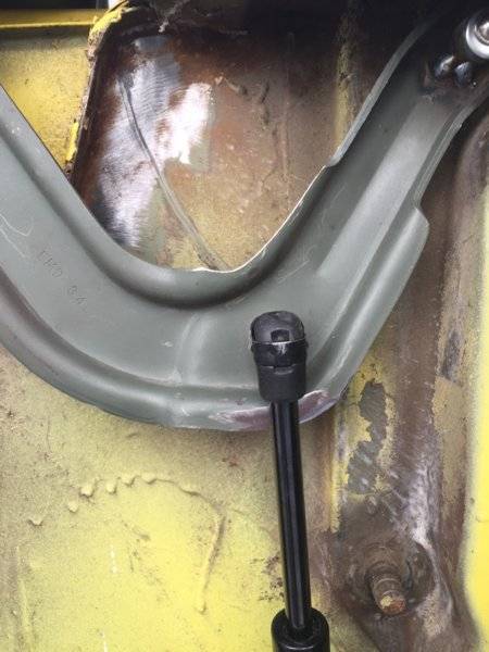

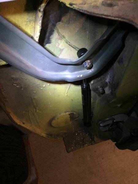

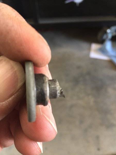

The hood hinges on the A bodies suck, to say it kindly. Mine would bow out towards the fender on the drivers side when I tried to close it. They aren’t bent, it’s the design of them that allows this to happen. So I got some gas struts, ground the main pin, punched it out (that thing was grooved from 40 years of use) and installed the pivot pin for the gas strut. Drilled 3 holes for the lower strut bracket and used nutserts so I didn’t have to weld anything and it can go back to stock if need be.

It’s working good, but I think that the 150lbs of force should be higher. I’m thinking 200lbs would be perfect. I’ll call the gal at Gruden tomorrow and see if the have something close to what I have now (extended length, stroke and size) but more force.

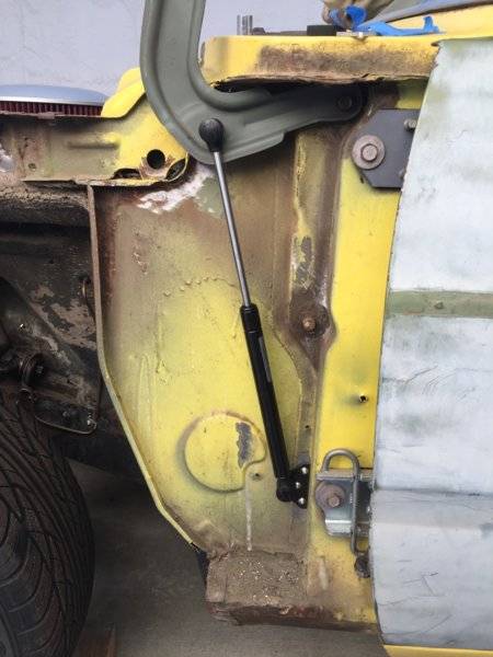

I got the idea from FABO, but no one that has done it cares to show how. The small problem that I’ve run into is the head of the fast strut is riding the inner sheet metal. And if you move the head to the outside, the hinge just wants to bow out. Got more work to do. I’ll try to post a pic when FBBO is working correctly.
The gas spring (strut) isn’t powerful enough to open the hood (150lbs). I have another set that I’m gonna try. They are a bit longer and also bigger in diameter so they should do the trick.

will it be easy to replace if need be? or does the fender need to come off?
only reason i ask is because my gas spring on my ram failed sometime back. it was easy to access and replace
watermelon
It will, just need to pull off the rear splash shield and your golden.

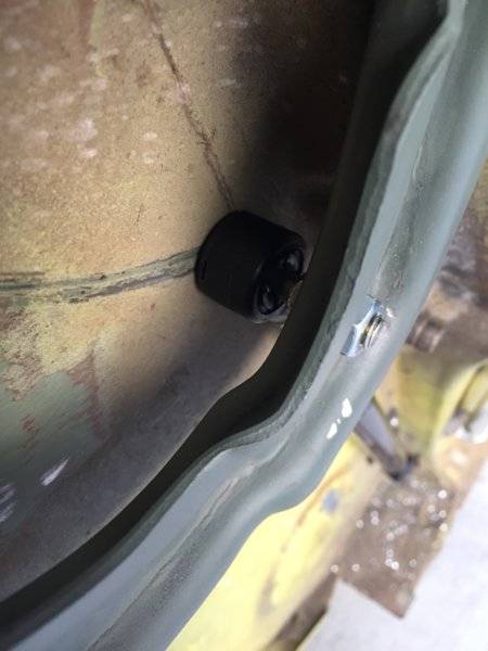

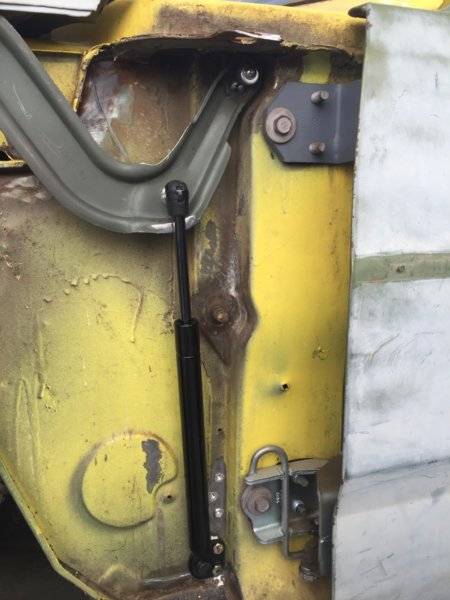

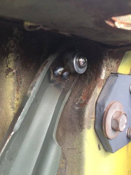

Got it done. I used 2 gas struts for a 2004 Mitsubishi Montero lift gate, 5/8od x .497id steel tubing and a 10/32 button head machine screw. I drilled out the hinge hole, tapped in the steel bushing, welded bushing to hinge (this spreads the load over 3/4” instead of just the hinge thickness). I drilled/tapped the hinge pin. This is just to keep the hinge from walking outward. Installed the gas strut and bingo, I’m set!

I thought the hinge pins would be “hardened”, nope! Drilled/tapped like any other metal I’ve done.
