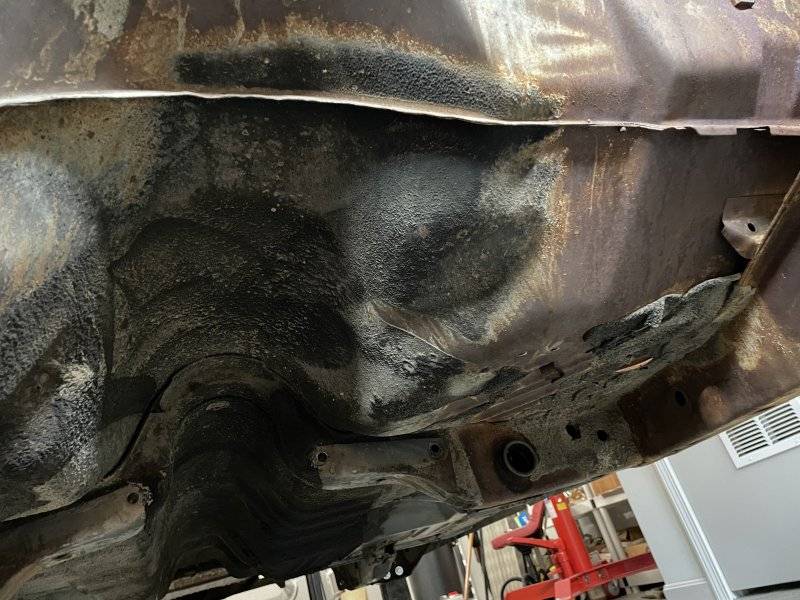

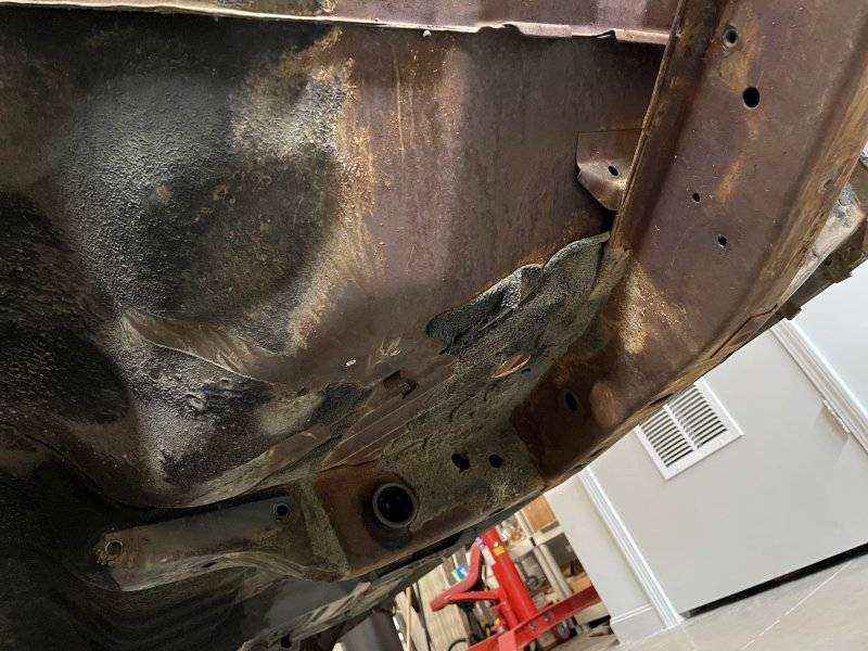

Been working on my back this weekend scraping off undercoating where the subframe connectors and frame stiffeners will go. What a miserable job.
This side is completely clean View attachment 1450952
On this side I just have to clean the residue off with lacquer thinner and test fit the frame pieces.
Go buy a cheap needle scaler from Harbor Freight. They work awesome for removing undercoating, the thicker, the better.

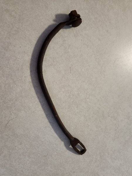

Mark if you get a chance I need a pic of the bolt for this. Mine snapped and from what I can tell it has like a 1/2 inch spacer/nut in between the two pieces. Thanks Dave

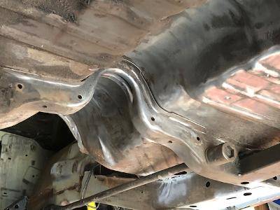

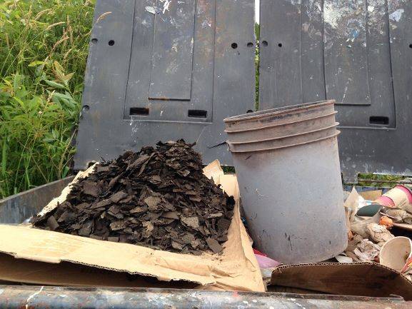

Took me more that a few hours. Using a propane torch, couple of different putty scrapers, wire brush and some red scotch pads plus the kitchen spoon. But by the time I was done I had filled a five gallon bucket full.
On my car, the bracket was removed (found it laying in the valance) and this is what the other side looked like ....

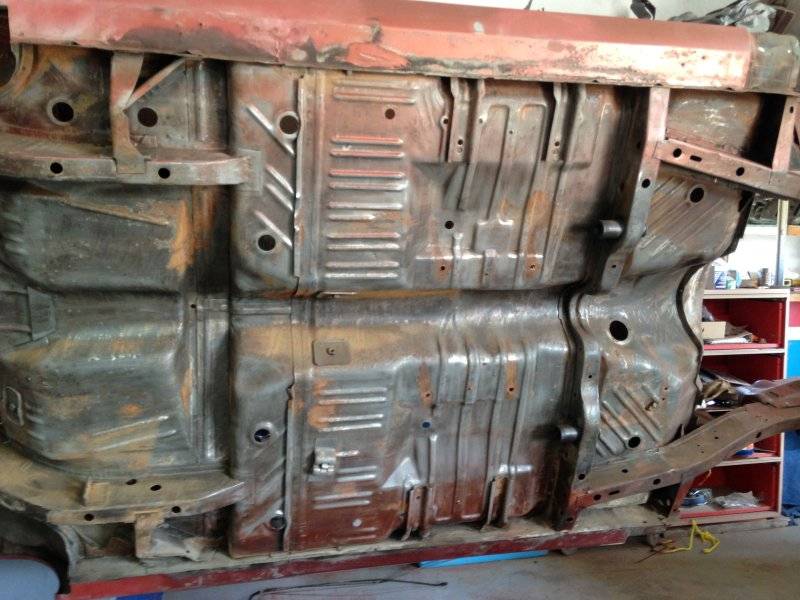

On my Plum Crazy purple Charger R/T the car was from California and was not undercoated from the factory. I spent a week hand sanding the entire underside of the car removing a layer of dirt and grime to reveal most of the factory grey dip primer. I put a nice thin even coat of undercoating on it to protect it as I intend to drive it a lot. It looks clean and fresh without being overdone.

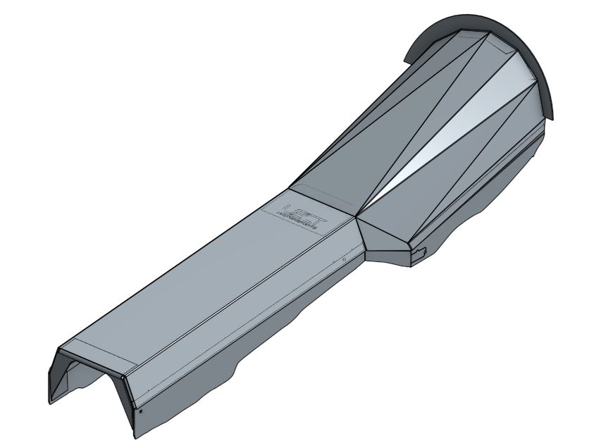

Pretty skimpy job of undercoating. Since I'm going to have to cut the tunnel for the Tremac transmission. I think I'll removes some more from the tunnel where the transmission will sit.
Sorry if I missed it in earlier posts, but which Tremec are you planning on using? The TKX? Tunnel mods should be pretty minor with a TKX
