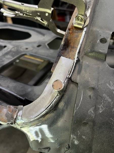

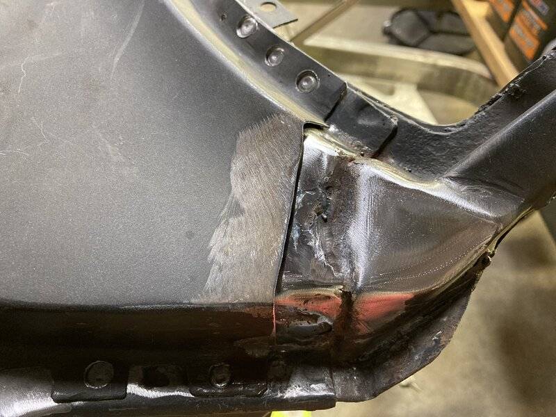

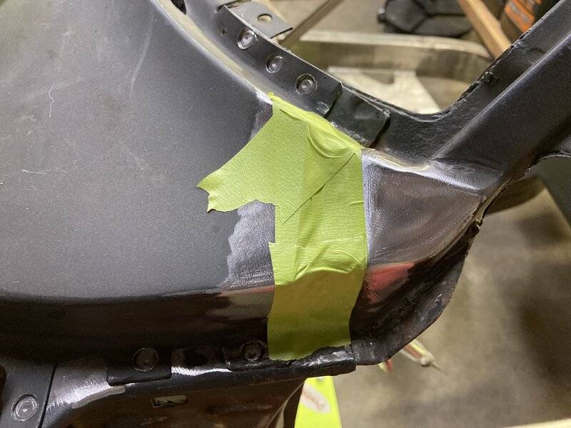

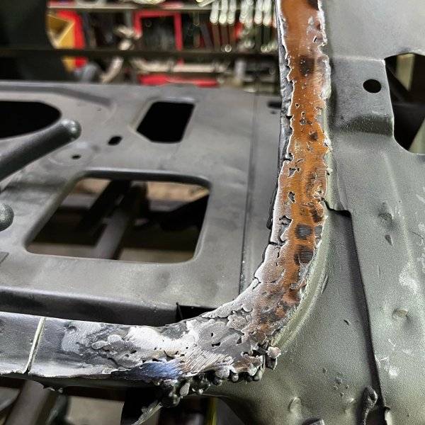

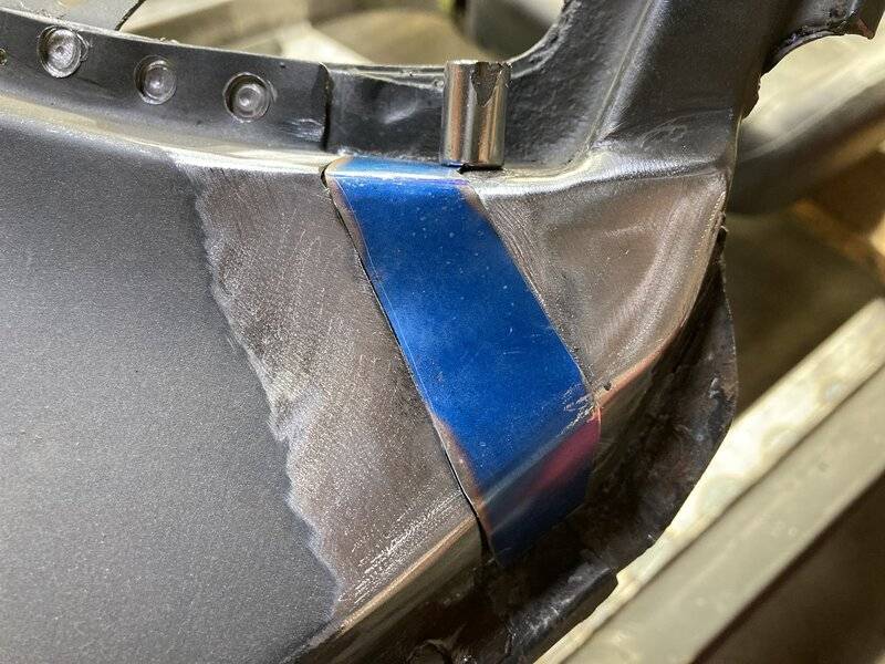

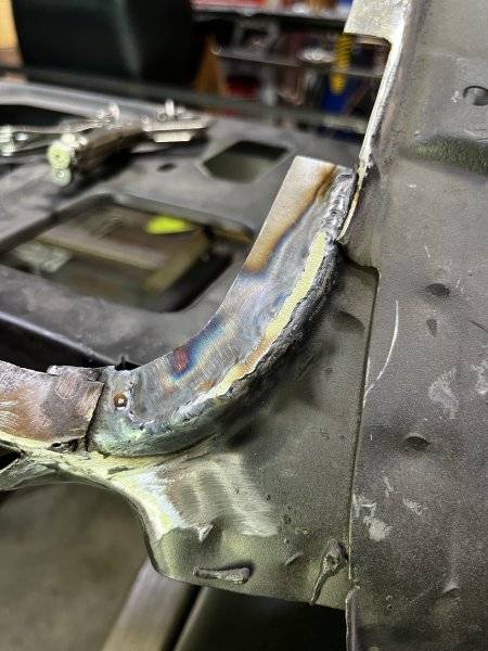

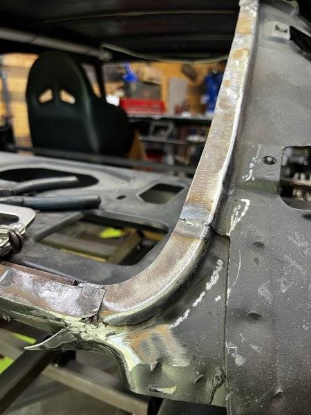

    Nice work, while looking at the pics I was reminded of a video I saw on youtube wherein a builder puts silicon bronze in all those seams, it flows really well and can be painted over or left visible.
    • Like Like x 2
    • 1970RT
      1970RT Well-Known Member
      Messages:
      375
      Likes Received:
      756
      Joined:
      Oct 28, 2014
      Location:
      Oak Cliff, TX
      Local Time:
      12:53 AM
      Thank you! I like that the silicone bronze has way lower heat input (like 1/2 with .045 filler), blends easy with a DA, doesn’t shrink nearly the same as 70S, and planishes very nicely. You just have to lay it over a really good series of 70S tacks. I’m almost certainly going to do that on the flat seams for the corner extensions where the cowl joins the pillars.

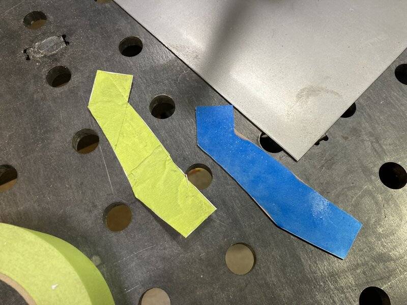

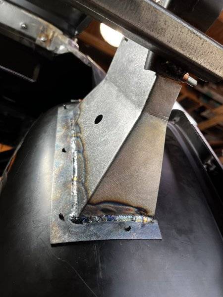

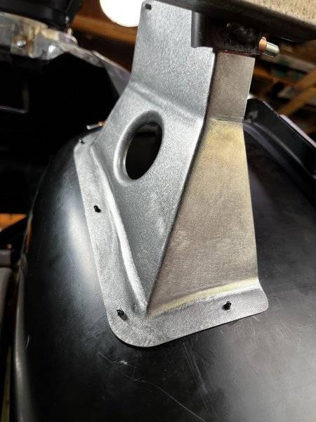

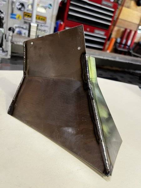

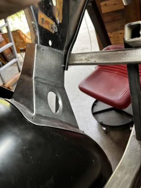

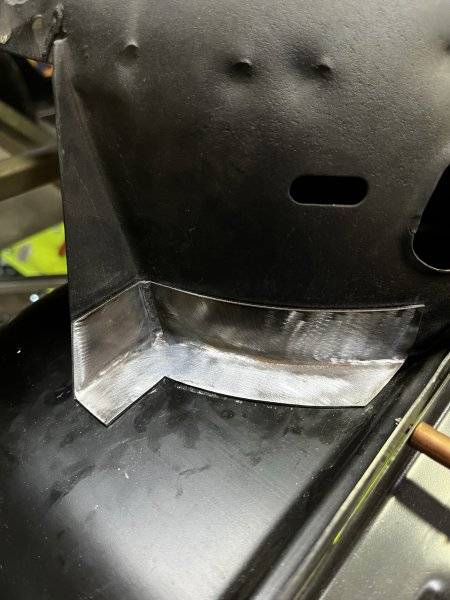

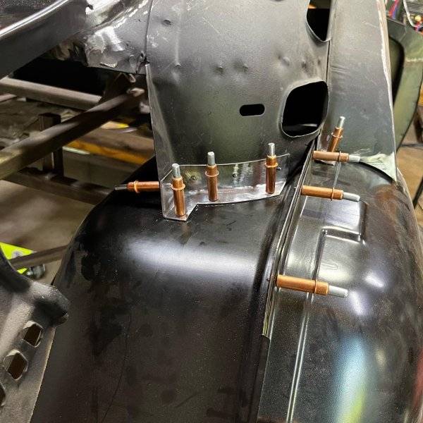

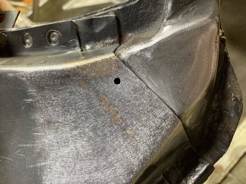

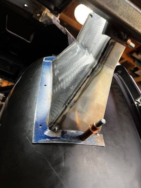

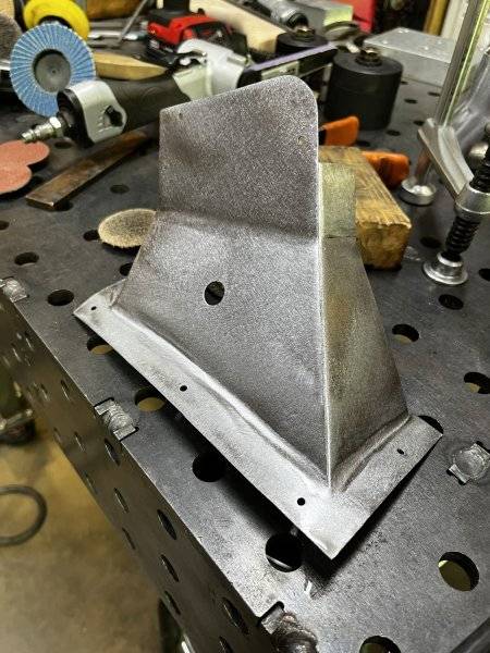

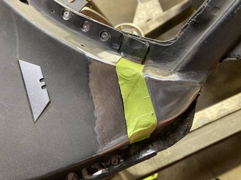

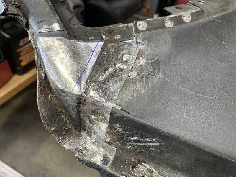

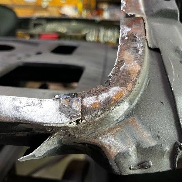

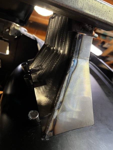

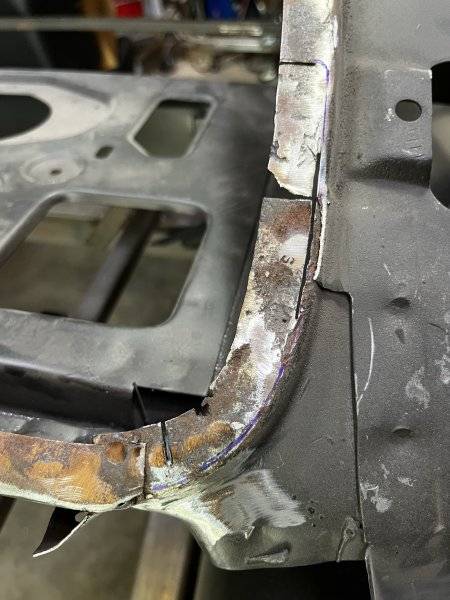

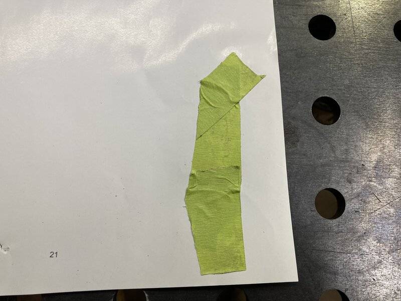

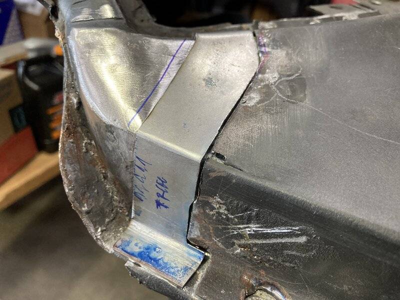

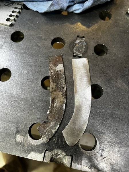

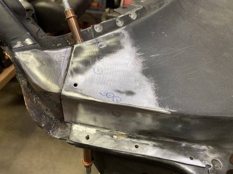

        Working to eliminate another lead filler line, and extend the upper cowl to meet the pillar.
        One side:

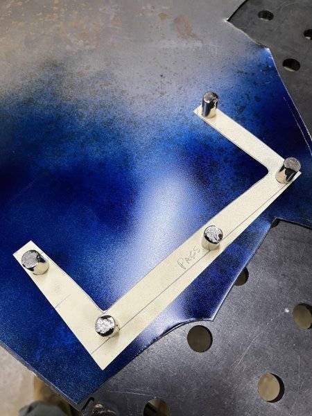

        The other side, and how I made the patch.
        From there, it's just finely fitting the roughed in patch, and then more welding and blending, and maybe a smidge of planishing to deal with weld shrinkage.

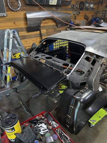

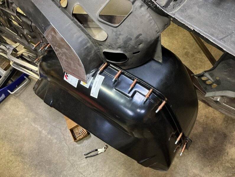

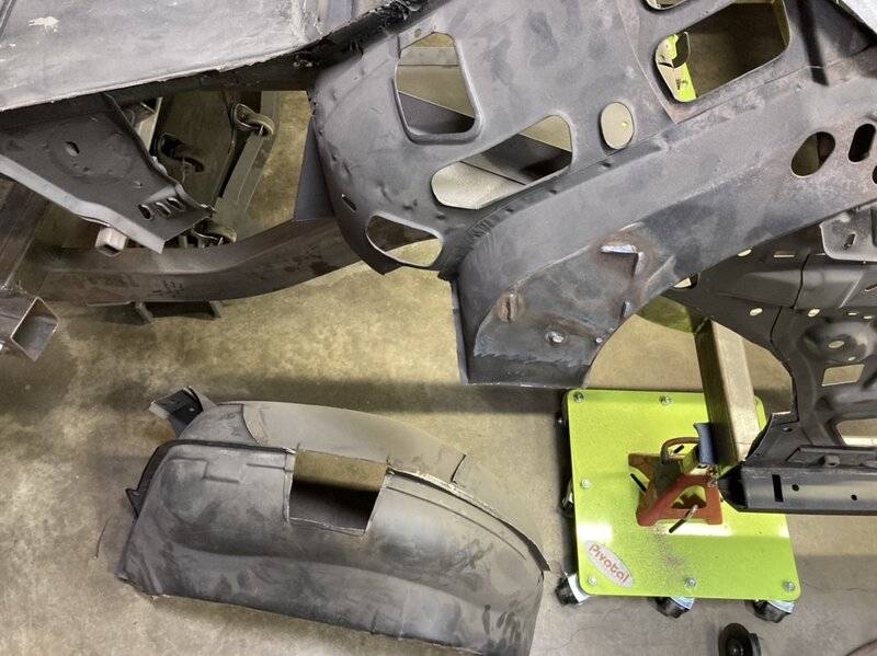

            I picked up fresh AMD wheelhouses, and I think I’m going to take a break from the cowl and turn my attention to the rear of the car for a bit.

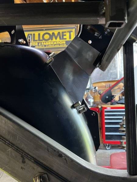

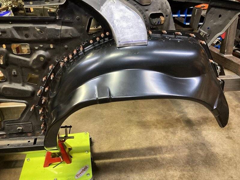

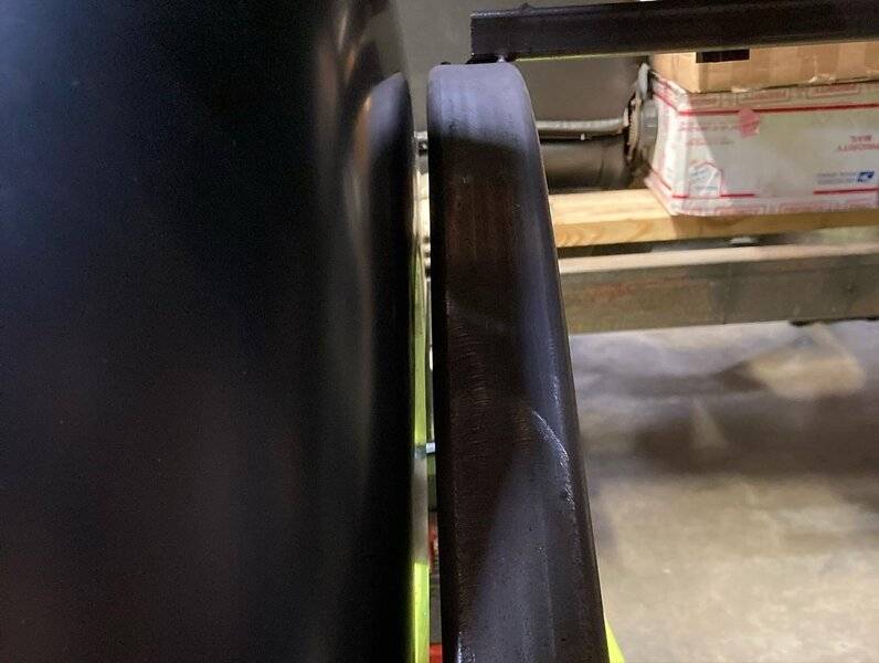

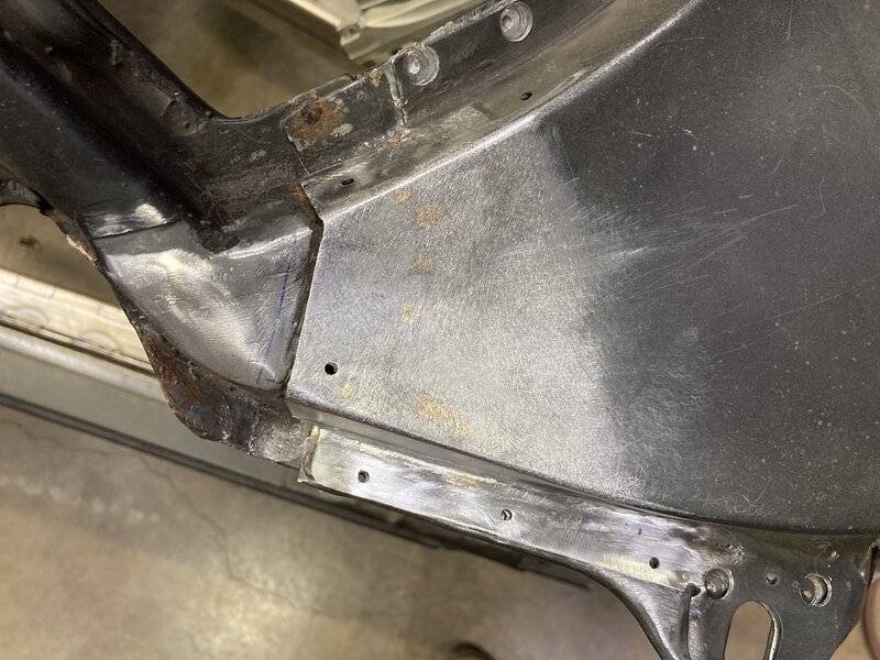

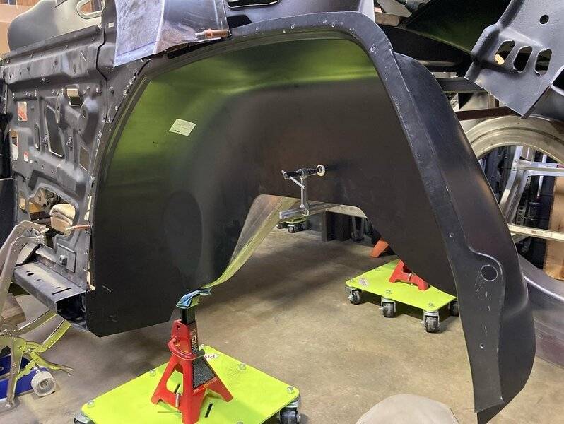

                One wheelhouse roughly fit. The AMD minitubbed inners are handier than pockets on a shirt.
                3/8” gap to the rail came out as designed. Pretty cool to see this work out.
                Other side is hacked and ready for fitting.
                I still have to eliminate the outer hump, and I won’t fine fit these and lock them in until I fit the quarters and rest of the rear sheetmetal.
                David
