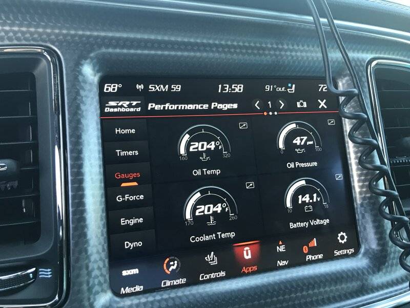

Heres an interesting observation.....the wife’s 2013 JGC 3.6 Pentastar has a 203* thermostat, but it runs 210-220, which is absolutely normal for this engine. What I can’t understand is that the thermostat is probably fully open say around 210, but it’ll run at 210-220 in town. Not much I can do about it, so I switched to full synthetic while staying at the recommended 5w-20, just hoping it’ll handle the temperature a bit better.

Wife's 2019 Buick Envision AWD Suv with the 2.5 L 200 Hp Gasoline Direct Injection engine uses an ELECTRONICALLY controlled (by the engine management computer) thermostat. It is set at 205°F. The dashboard coolant temp gauge never varies 205 degrees....A/C on or off, in traffic or highway does not matter as everything is coordinated to operate at that temp. The t-stat will modulate to maintain that setpoint temp even though the coolant is over 200 degrees F, the end of the world has not occured, even though this is above the 180°F generally stated "they said" number.....maybe "they" should reconsider their position?
