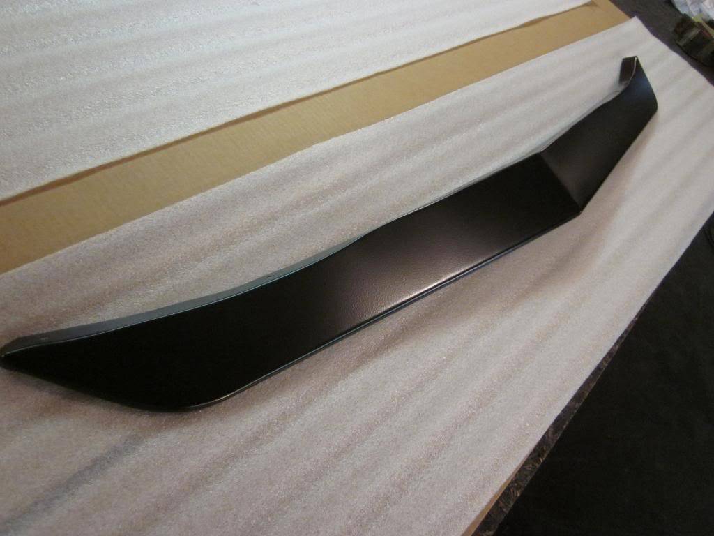

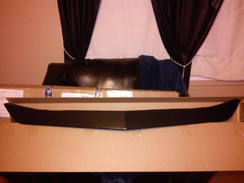

I got the '69 Camaro spoiler in, and bad news... it doesn't fit. :( It would fit great except for the center area of the lower front valance extending downward.
I tried cutting the center section of the spoiler out so it would fit over the valance extension. It fit better and could probably be adapted to work, but then you would have a spoiler that's about four inches wide on the sides and two inches or so wide for about the center 12 inches, and that might look a bit off to some people.
randy contacted me back says hes working on a 71-72 roadrunner front spoiler and it should be done the prototype in a couple weeks!

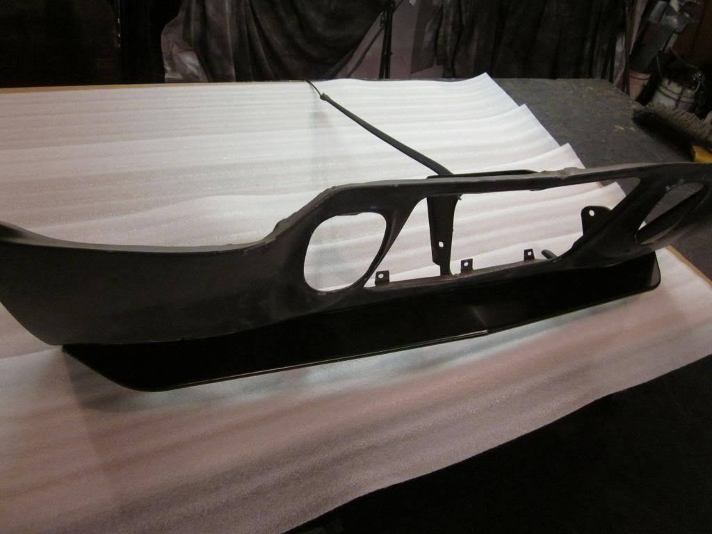

Okay, I might have to reverse myself on my last post. I looked at the pictures of the Randy spoiler installation again, and noticed those spoilers are mounted behind the center bulge of the lower valance. I was checking to see if the Camaro spoiler would mount on that bulge. Last night I held the spoiler up behind the bulge and it looked like it would fit just fine.
I'm thinking now that the Camaro spoiler will work as it's nearly identical to the 73-74 Roadrunner spoiler shown in his ad. I guess I have to get under the car again tonight and see what I can do. $40 sure beats $160. ;)

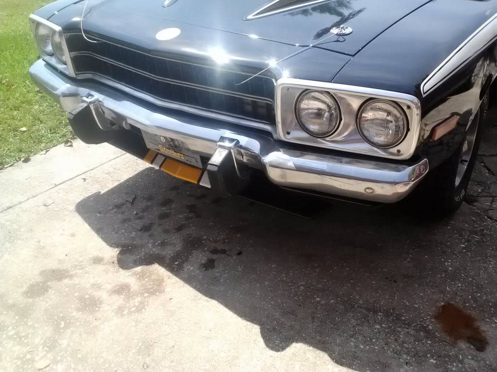

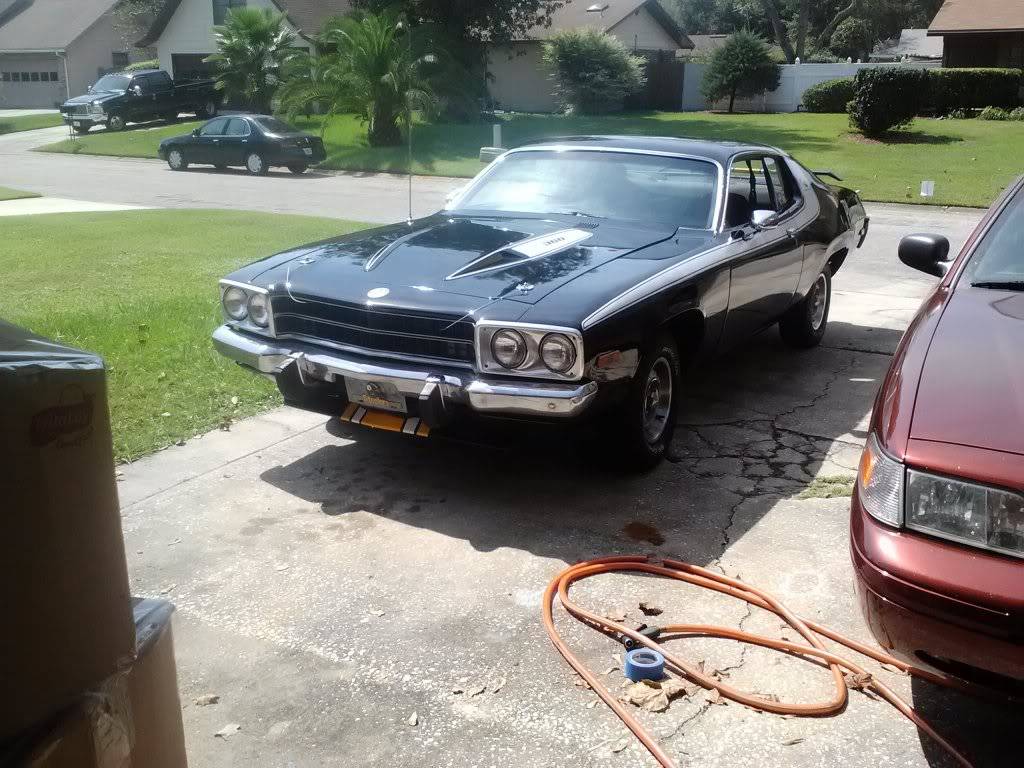

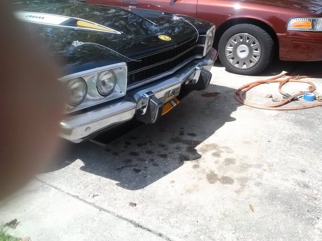

Hey Sputnik. Yep, I got the spoiler on. I wanted to move it further forward than the Randy spoiler installs to make the spoiler more pronounced, so I cut out a section of the center of the spoiler so I could mount it on the front valance hump. Here are some pics:
PM me if you want to come by and see it sometime.
